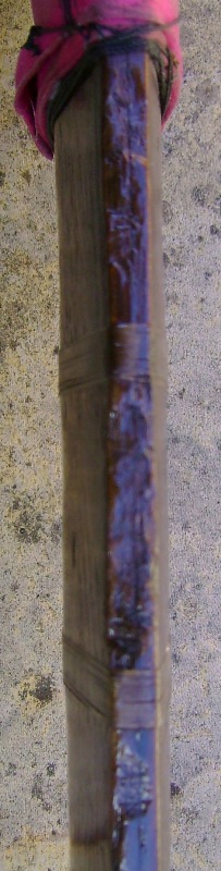

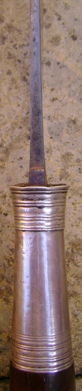

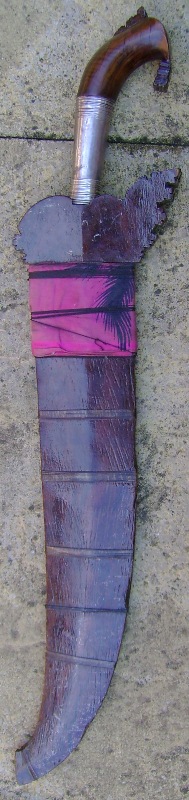

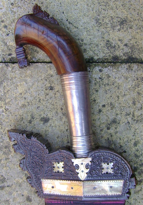

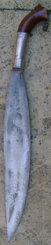

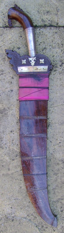

I took a gamble on this as they are not my thing. I hope this is circa 1900? The scabbard seems to have seen some life before being covered in a lacquer and the cloth wrap is most unlikely to be the original. The blade needs retching. Can anybody talk me through this process? I know it is Philippine but that is all. Thanks in advance.

Nice barong. As far as age goes I think 1930s-1940 but it could be older. Clean the blade up with 600 grit wet/dry sand paper and you can etch with pineapple juice of ferric chloride. Once etched use 0000 steel wool and lightly go over the blade add a light coat of oil at the end.

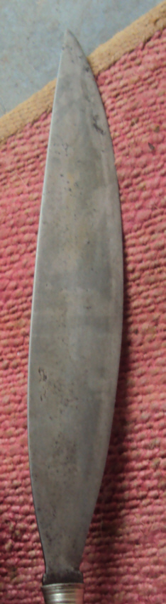

I have tried wiping the blade with boiled vinegar. So far all I have is a shiny silver handle from my gripping, and a clean blade with possibly less visable linear? pattern than when I started. Is it like cleaning a Keris blade? Do I need to have the vinegar or pineapple juice on for sometime? like hours or even a day or two?

When you follow the instruction from Steve it will work, you have to do the etching sometimes many times until it workes, don't give up.

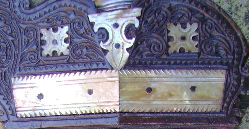

While my blade is being cooked up in a pineapple soaked tea towel. I would like to get more information about these. A google search has sites suggesting that scabbards with mother of pearl on them are post 1940s? Looking at this seen many times before standard google search image. The chap in the centre has mother of pearl on the throat of his barung scabbard. What time period is this picture? Something about this picture reminds me of a Black Crows album sleeve.

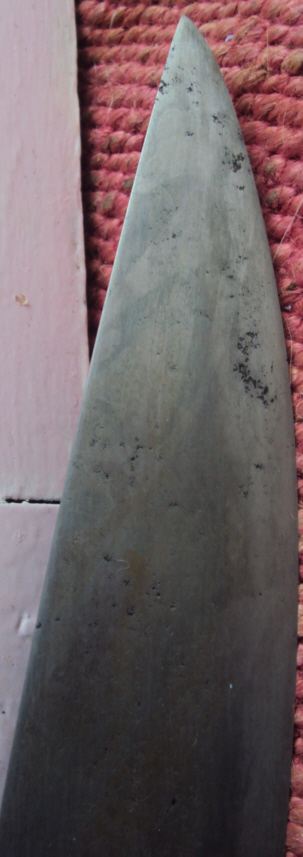

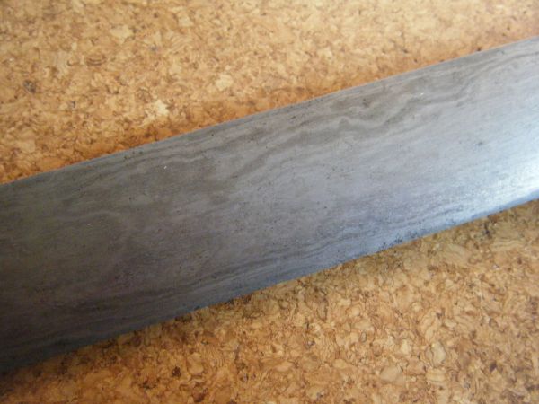

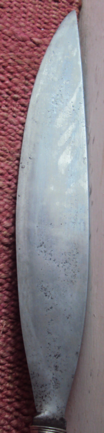

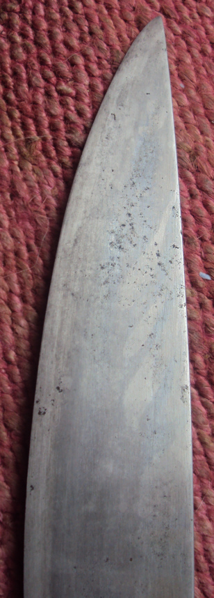

The contrast is not that strong, so quite hard to photograph. Steve, thanks for the tea towel tip. I have used an antique wax and fine steel wool to finish. Total length 22 inches blade 16.5 inches.

Sometimes the contrast is just not there. It's a beautiful blade though.
