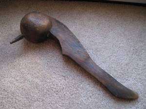

Saw this a few weeks ago a the seller swore up and down that is from 1790? Looks like an early to mid 20th century replica to me. Btw only one private bidder.

AT THE HIGH STARTING PRICE AND THE CLAIM THAT THAT WAS A GIVE AWAY PRICE AND THE PART ABOUT IT BEING BLOOD STAINED, I SMELLED A RAT.
THE PATINA LOOKS ALL WRONG AND THE PRESENCE OF DIRT IN THE CRACKS, IT LOOKS LIKE AN ARTIFICALLY AGED CLUB AND PATINA. IF THE WOOD IS SOFT LIGHT WEIGHT WOOD THAT WOULD CINCH IT AS A REPLICA FOR ME. A GENERAL RULE IS A WOOD CLUB WILL SPLIT EARLY IN ITS LIFE AND USUALLY NOT WHEN IT IS 100 YEARS OLD UNLESS IT IS MOVED TO A MUCH DIFFERENT CLIMATE. A CLUB SPLIT LIKE THIS ONE WOULD HAVE BEEN WEAKENED AND WOULD MOST LIKELY BE DISCARDED AND THE SPIKE USED TO MAKE A NEW ONE SO IT WOULD HAVE BEEN UNLIKELY TO HAVE SURVIVED AS IT IS NOW. JUST MY GUT FEELINGS ABOUT IT.

It also looks like they cut across the grain quite a bit on both the handle and the ball, and that is something that you generally want to avoid. You can really see it on the the handle.

I have been dealing in only Authentic 19th Century Native American for over 15 years. I can gaurantee you this is 100 % authentic!! no question about it!!!. I am a reputable dealer at the Western and Native American shows...
This says it all for me.
I'm starting the bid at $3500.00 which is a giveaway, I believe in the right hands this could bring upward of $25,000.
Yep, if you try to rob a bank with this thing, you might get $25,ooo.

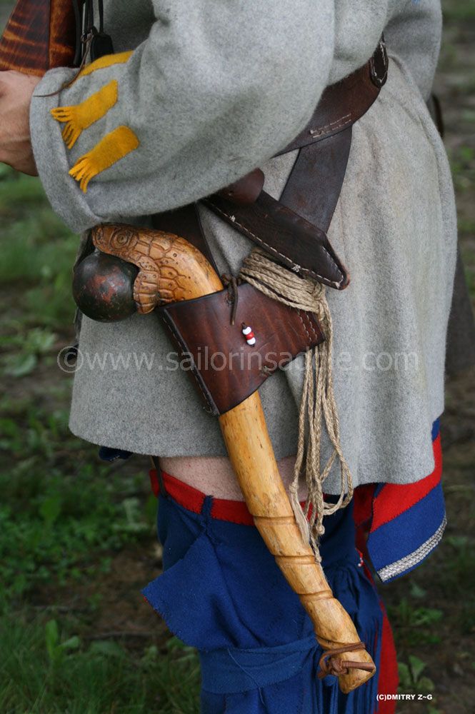

The piece itself looks like machine-made, aged reenactor's replica [interpret it as you wish ]. I've seen these sold by the sutlers at Fort Ticonderoga. Took some photos as well.

Yea, I agree. I can see the artificial staining of the wood. And the spike - it should be a knife blade and this "spike" has a flat tip! Hmmm.....

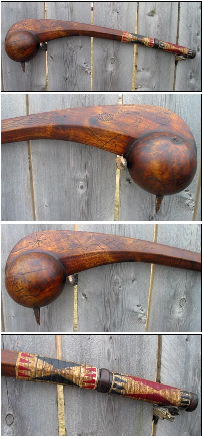

The attached is a reproduction said to be modelled on a Sauk/Fox (East Michigan areas) type from mid 18th c. The gunstock type club seems to have come in around earlier 18th, and the description was used by colonists, these were not made from gunstocks! and not modelled on them, as I was once told by Norm Flayderman. I sort of went berserk after seeing "the Last of the Mohicans" researching these!! Talked to the guy in Tennessee who made the examples for the movie, and said there were five made if I recall.
The other example (bottom right) is from the original auction link, and the weapon we are discussing.

Dmitry
Dmitry's Avatar
Join Date: Jul 2009
Posts: 612
Old 4th August 2010, 08:11 PM   #9
Posts: 10,867
Originally Posted by Dmitry
Nice carving, thanks.

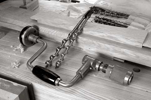

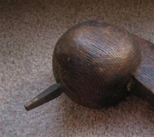

IMHO The so-called spike in the club that started this post looks to me to be the drive end of a bit (drill bit) that was used in one of the old hand cranked braces (hand operated drill) used up until electric drills became readily available. The pictures below are from Woodworking Magazine, Wikipedia and one from the auction cropped to show the spike better. If I remember correctly these items in this form were not invented until the early 19th century.

Robert you seem to hit it right on the head. I looks exactly like the back end of that drill bit.
