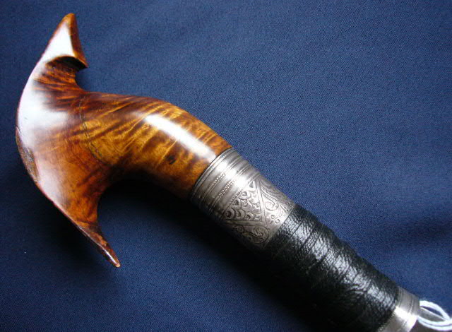

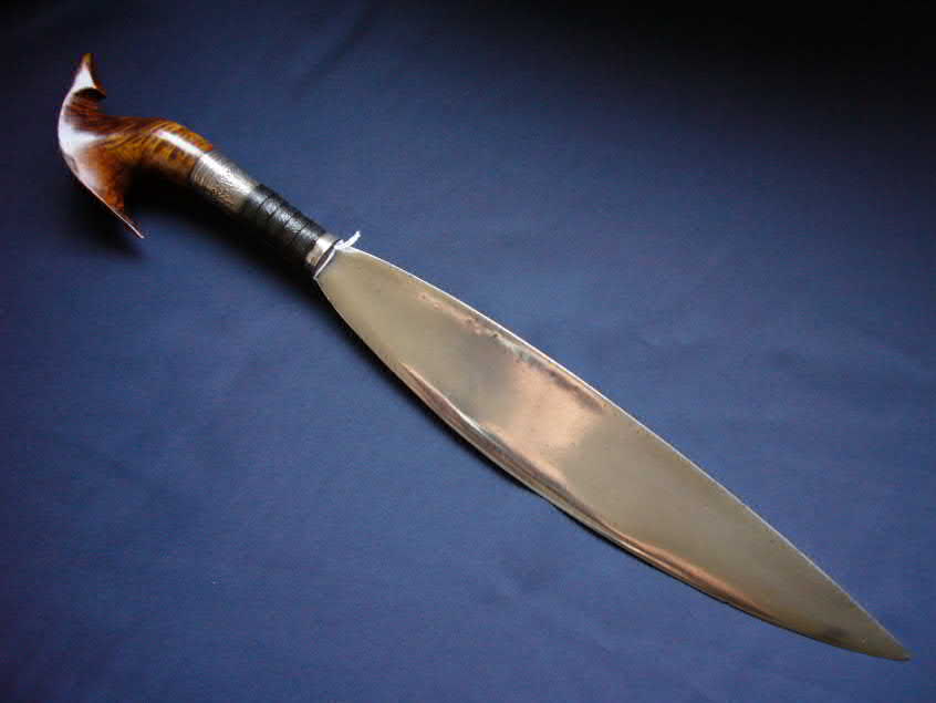

Old 8th September 2008, 04:25 PM   #7
kino
kino's Avatar
Posts: 1,038
[QUOTE=Spunjer]got an old barung that, of all things, someone decide to chrome. at first i thought it was just taken cared of and maintained all these years. well, it was chromed QUOTE]
LOL! I too have been fooled by the same. Here I was thinking about a previous owner, being so overzealous polishing a barung blade to a mirror like finish. Then I saw pittings, with resemblance to my mother's VW bug bumper.
I too would like the chrome removed, but in fear of ruining the blade.
Ho brah, If you decide to do it, show the results.
Check out the shine on this one.
I almost see you with your camera shining in the blade

Batarra, The hilt is a simple carve, nothing really fancy. The wood is gorgeous, combine the 2, and I find a hidden beauty.

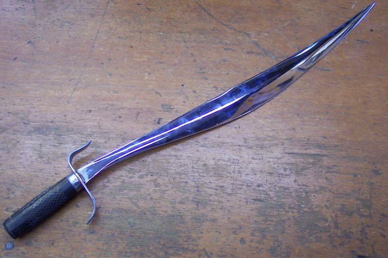

Unfortunately I now have one to add to the "What Were They Thinking" list of blades that have been chromed. As I really don't have much tied up in it I think that as soon as it warms up that I will try to remove the chrome just to see if it can be done without harming the blade. I will let everyone know if it works out or not.

I know what you mean. That's why when I saw this I felt an obligation to try to put it back as close as possible to its original state. I'm just hoping that it turns out right.

I wouldn't say the one I posted would be considered a wall hanger by any means but it would be nice to see it the way that it was meant to look instead of the way it looks now.
