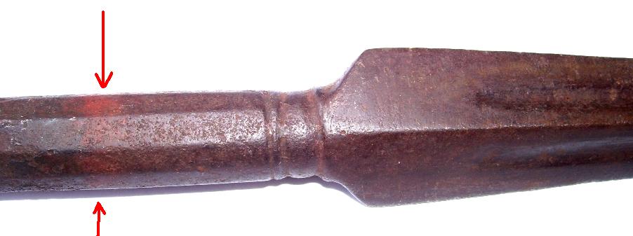

Hi
bought what I believe to be a lance head. The seller thought African, if it is, I have never seen anything like it. Although I have seen facetted sockets on a few African spears , I have never seen one with a very thick, diamond section blade. I think India is more likely, skillfully hand forged with forged 'fullering' ......seems to be designed for 'armour piercing'. The head is 'too good' to 'throw', so perhaps a hand held stabbing spear. It has good patination and would not be surprised if this is 18th C.
The reddish stripe (socket) is not clearly visible to the naked eye . I only noticed it on the photo's
Has anyone any ideas or comments please, thank you
Regards David

Thank you Gentlemen for your replies ,
So generally agreed possibly Indian. Rick your suggestion of a SEA is interesting....for some reason I wondered if this was from Southern India which have weapon features that have influenced / have been influenced by SEA.
Hi Battara,
although the pictures give the impression that the head is 3 sided, it is in fact 4 sided, a diamond shaped cross section. Max width viewed from above is 30mm (1 1/4") ....viewed from side max width is 16mm ( 5/8" )
The red 'band' on the socket is only just noticeable in certain lighting conditions. It seems to 'bleed through' the very dark stablised patina. Not obvious is the very tip is slightly bent and blunted. I do not believe this was 'abuse', but combat damage the overall patina is the same as with the rest of the head and socket.
This damage is consistant with great impact force....perhaps again suggesting a cavalry lance.
One of the 'fullers' out of the 4 is slightly longer. It seems that it has a impressed stamp, which is too worn / corroded to see but, the outline of its 'border' seems almost rectangular 4mm x3mm slightly above that (and centrally) there is a small faded 'something'....under magnification these two combined almost appear to be a crown but like looking at clouds and making out shapes, the more you try to 'see' ....the more the mind 'creates'.
Any ideas as to the red 'band' thank you
Kind Regards David

Using a loupe I have been checking the surface to clues for the type of construction ....and discovered, what I think, is small amounts of silver koftgari designs. Near impossible to photograph clearly but evidence of stripes, a chevron and circles with small rays (sun ?).
Now I have a problem, take the risk of removing the very old patina to reveal the remaining koftgari (good idea if a lot of it remains)....or leave as is ???
Regards David

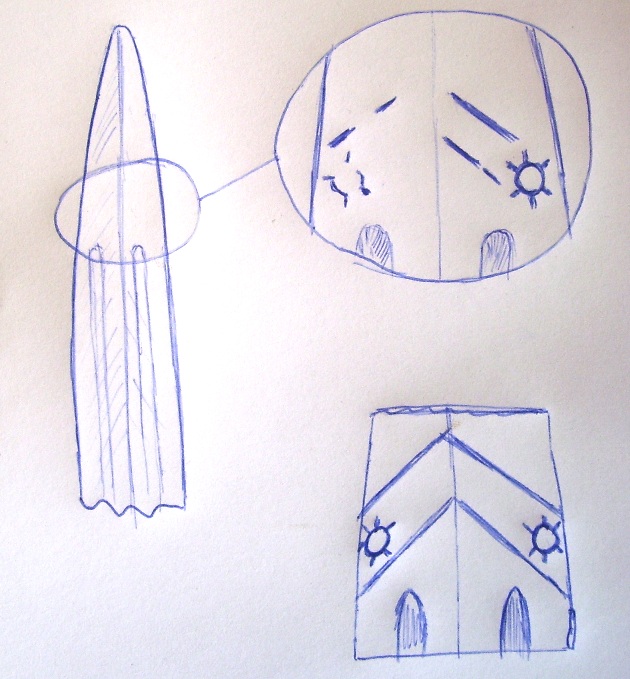

Old 29th August 2010, 07:05 PM   #16
Posts: 5,999
David, is there any way you can show the marks on this piece. A picture, rubbing or just copy then to a piece of paper. I am most interested to see. I have been doing some digging. The red paint is also interesting.
Old 30th August 2010, 11:46 AM   #17
katana
katana's Avatar
Location: Kent
Posts: 2,658
Hi Tim,
thanks for your interest. Heres a drawn picture
Kind Regards David
Old 30th August 2010, 01:29 PM   #18
Posts: 5,999
Interesting. Could it be just engraving? Are they like Indian symbols? The placing and minimalism does not remind me of Idian work. I could see some similarity to Adinkra symbols? It might even be a piece of iron in a ritual context? The red paint might have some relavance?

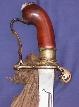

Old 7th September 2010, 09:34 PM   #21
katana
katana's Avatar
Location: Kent
Posts: 2,658
Below is a picture of a Khanda hilt, the Koftgari designs are very similar to the visible 'ghosting' marks I can see in the spear head.
Would these designs be common to certain areas of India, or groups or are they fairly common ?
Regards David

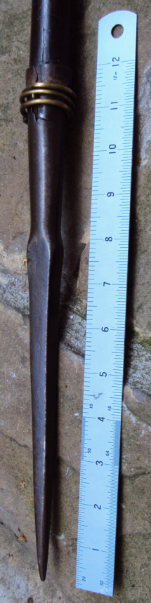

Old 17th March 2011, 02:53 AM   #22
dketch
Join Date: Feb 2011
Posts: 12
Default Identification
Originally Posted by katana
Yours seems very similar to something I have .....
http://www.vikingsword.com/vb/showt...highlight=lance
Regards David
Wow! David, your spear top looks almost identical in shape and size to the one I bought. Do you think my pike was built in the same area or timeframe as the one you have? If so, any idea as to when / where it was made?
VERY interesting....
- Doug
