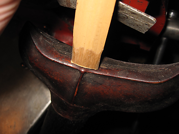

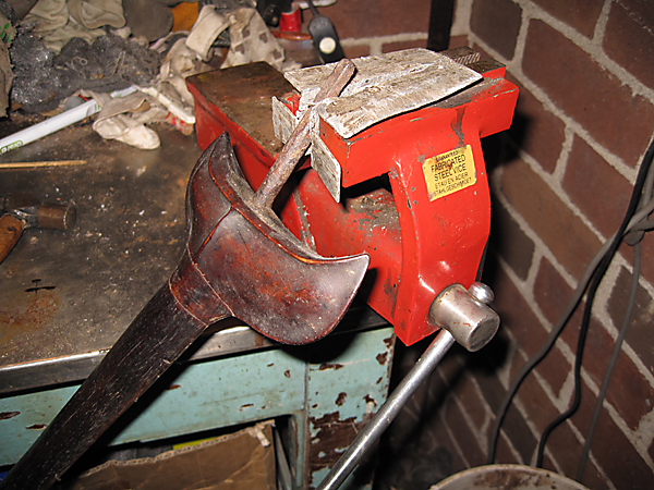

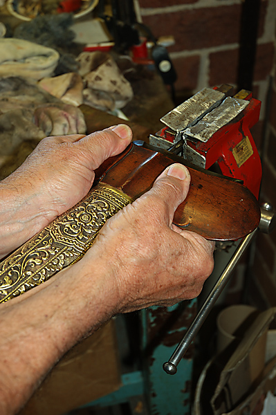

The first thing I do is to remove the hilt, and using aluminium jaws to grip the tang, I put the tang into a vice, grip the top of the scabbard as shown in the pics, and after a couple of hard, fast jerks, it will usually come free.

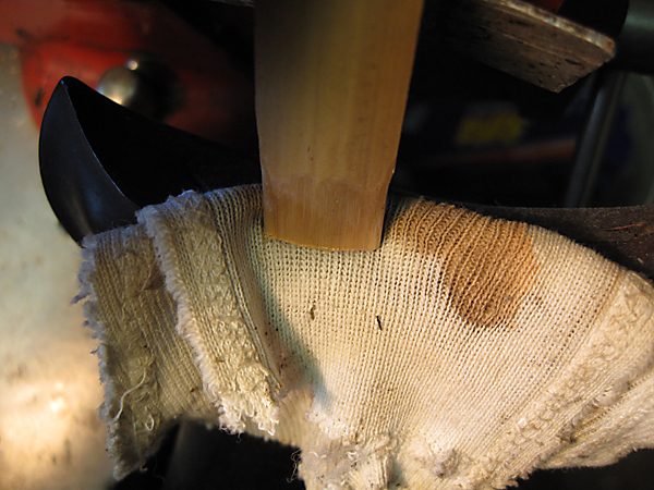

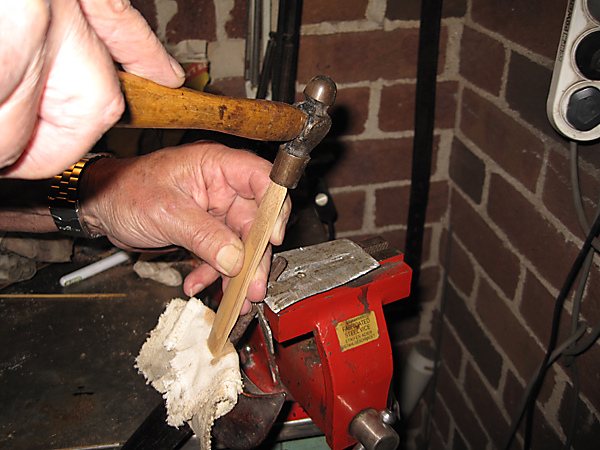

If that does not work, I use a piece of wood and a pad of cloth on the side of the scabbard opening, up hard against the blade, and tap it loose with a hammer.

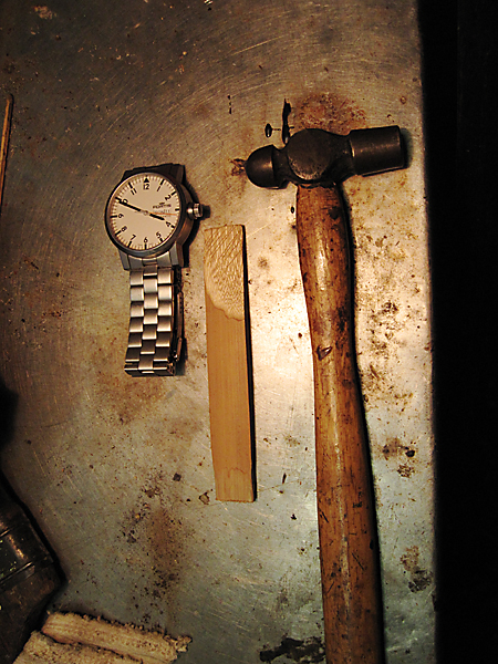

I hope the pics are sufficient explanation of the procedures involved.
Alternatively, you can wait until your winter is gone, and leave your keris in an unairconditioned environment for a few weeks during summer; I have been told that this approach works well.
PS---the watch is to show the size of the wooden drift and hammer used.
