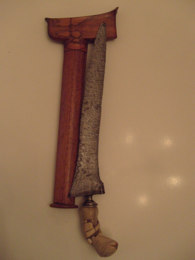

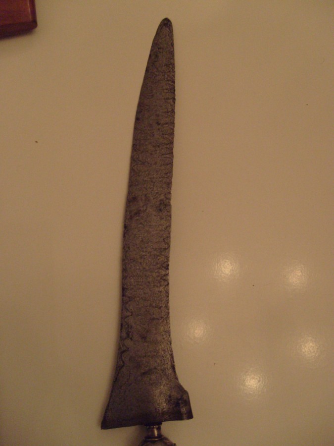

Hi There ,
Today i did recieved this keris , i hope u guy,s can help me with your,e comments so i can learn
It,s a small keris total lengt 36 cm . the hilt is from hippo and the origin is probally malaysia .
The blade is in not washed condition and i think it,s pamor untu walang.
It fit,s good in the scabbard.
all comments are welcome on this one .
Danny

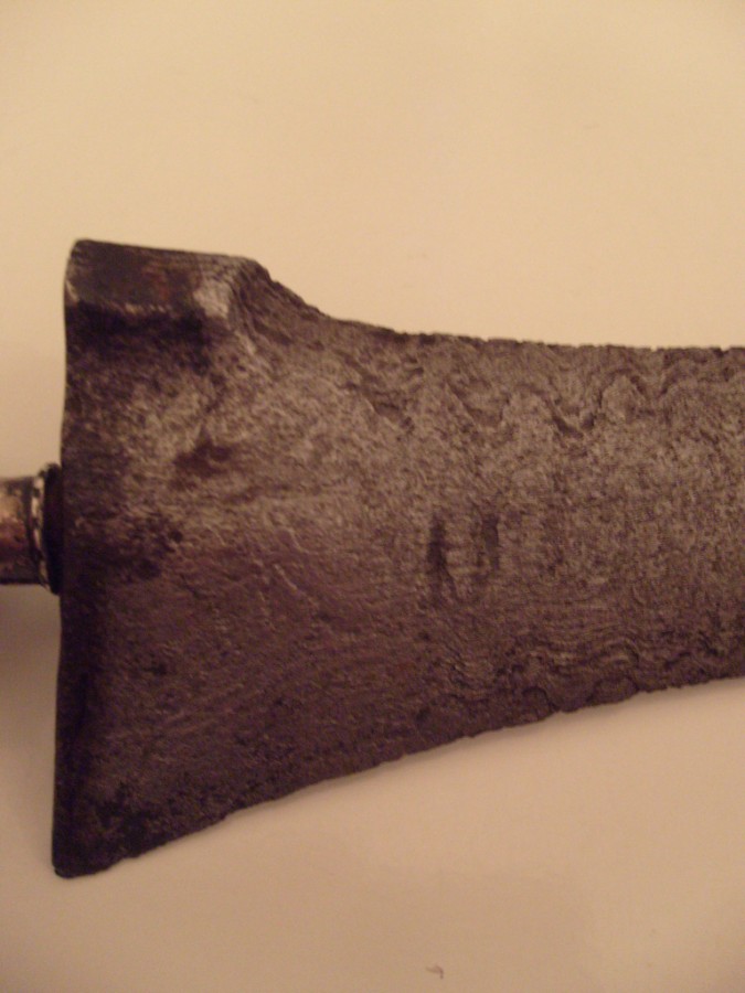

Some more photo,s .
Sorry that the are so big.

Is the gonjo missing ?

That,s a good quistion...
I think it was ment to be like this.

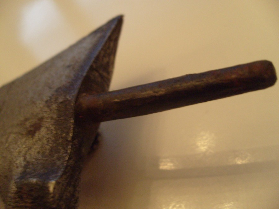

Take a look at the peksi. that might tell you if a ganja is missing.

Okey let,s say the hilt is no hippo . someone has a idea what it could be than ?
Mr Maisy . do you have a opinion over the blade ?
Ganja iras or..?
danny1976 is offline   Reply With Quote

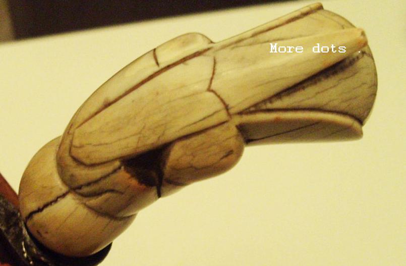

Hippo-ivory often (always?) has a fine line of small dots, dense structure and gets not so dark with time. This hilt has something like this line of dots, at the base it turned to a crack, but visible on the head and the inner side(and looks a little bit strange).
The source may be the bugis trade with East Africa.
I suppose, the blade has lost the gonjo.

Re the hilt Danny, I do not have any idea what it might be. If you have followed our hilt material guessing games you will understand that it can sometimes be pretty difficult to say with any certainty what material a hilt might be from. More often than not I don't get involved in these guessing games.

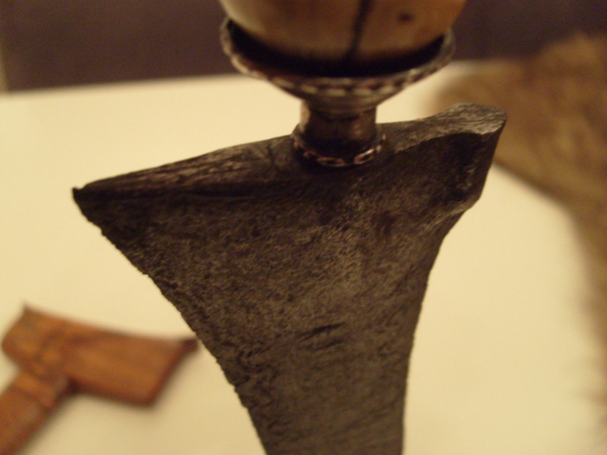

Re the blade, from the photos I don't think that this is a gonjo iras blade.The proportion seems wrong for gonjo iras, and in a gonjo iras blade the gonjo is usually indicated by a line in the place where we would normally find a joint.
If you remove the hilt and have a look at the tang (pesi) you may be able to gain some indication as to whether a gonjo was ever fitted, or not, but even this inspection may not provide positive evidence one way or the other. If you find a slightly larger diameter in the tang immediately above the blade base, it is very probable that a gonjo was once fitted that has now been lost.However, the absence of this increased diameter is no gaurantee that a gonjo was never fitted.
A better indication might be to look at the width of the blade base. When you remove the hilt, I suggest that you post a photo looking down directly onto the blade base.

Thanks gustav for the explain on hipo hilts. I think it still will be a quistion if this hilt is hippo or not?
Mr Maisi.
I will make photo,s this weekend wihout the hilt.
How about the pamor and the origin , malay ?

Danny and Gustav are correct, the hilt is very old hippo ivory. Tomorrow I will show a other hilt and how you can indicate hippo ivory, Gustav give already the right direction. Lines with small black dots is the best sign for hippo ivory.

I am in agreement that the gonjo on this keris is indeed missing.

Ditto that.. 'ganja hilang' (missing ganja) category.. Nice hilt, the pendokok (hilt ring), not a form commonly associated with Peninsular Malay piece.. the pamor, using malay pamor name, is gigi yu (shark teeth).

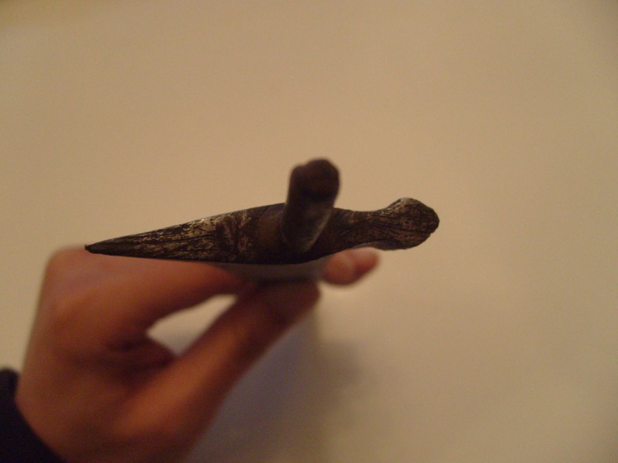

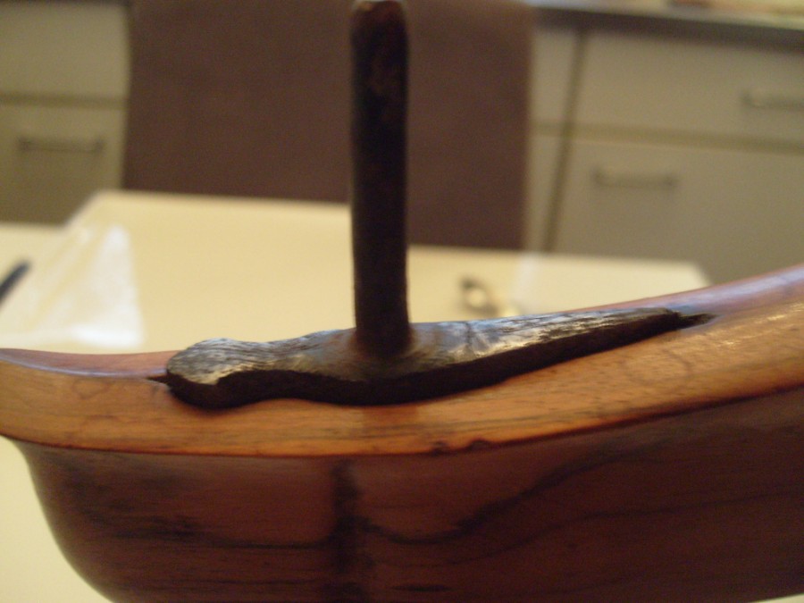

Guys , here some photo,s of the peksi.
If the ganja is lost or removed it happend a long time ago , there is no diffrence in collor on the peksi and the peksi has the same collor tone as the blade.
Any body has a idea for the age from the blade.

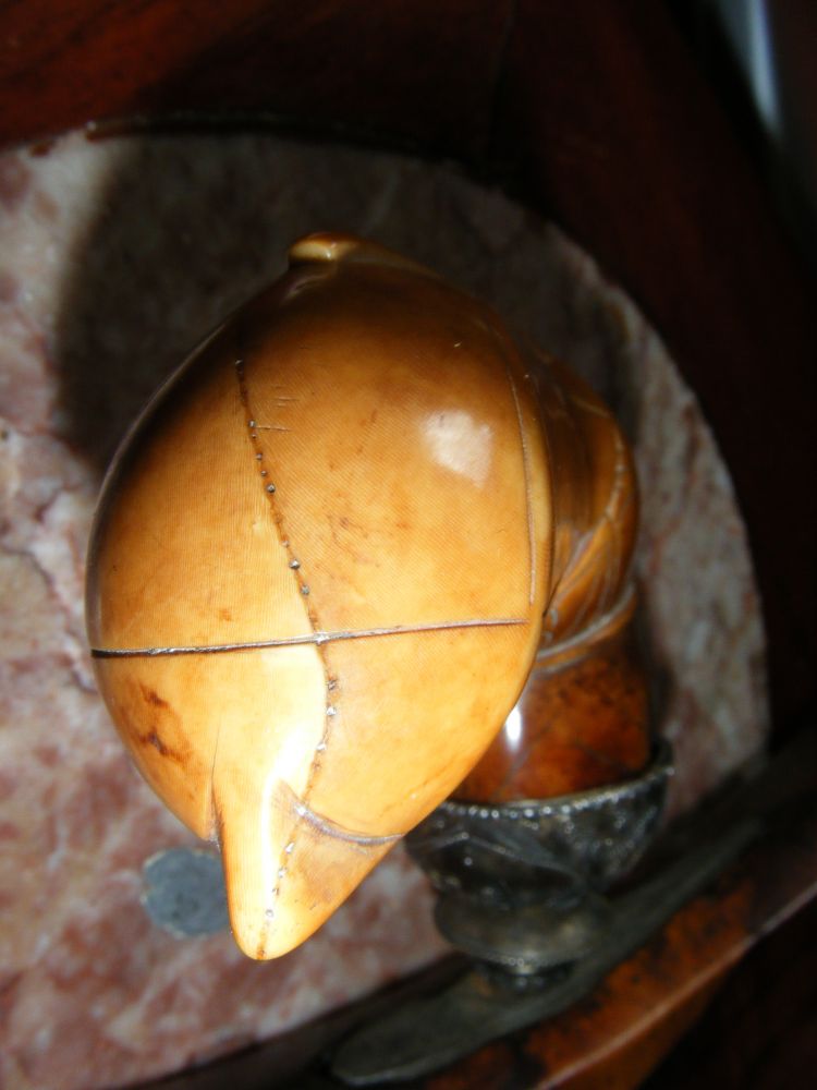

Here a other hilt from hippo ivory, the line with the black dots is clearly to seen.

And on Danny's .

Yes, I am of the opinion that the gonjo is missing from this blade.
