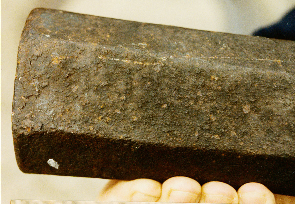

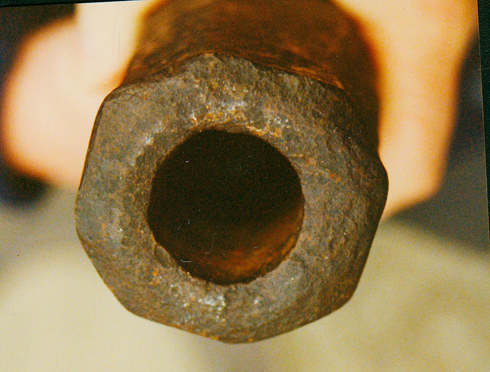

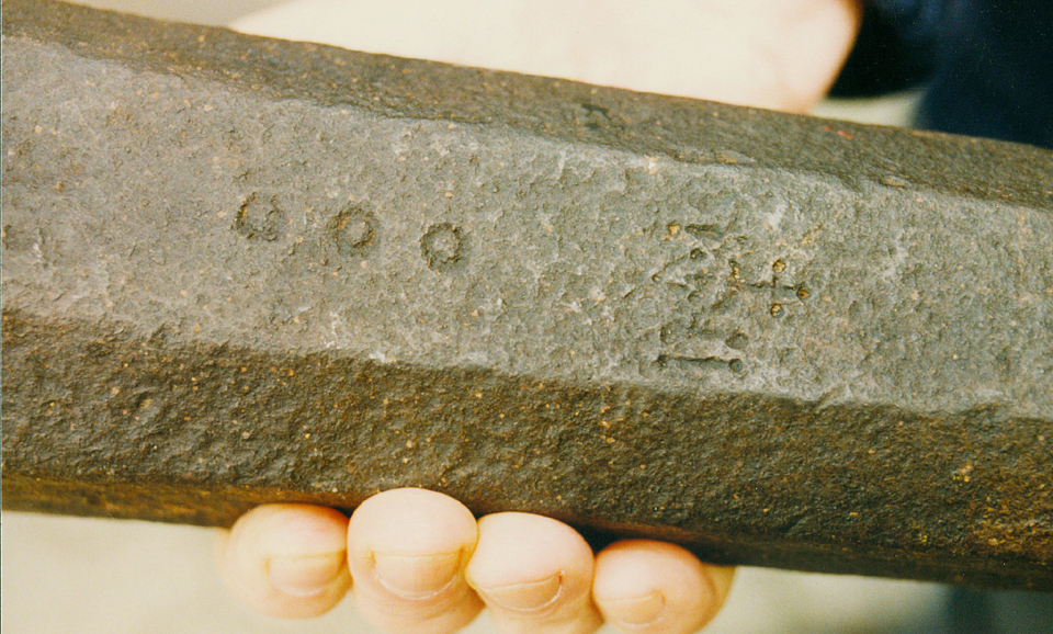

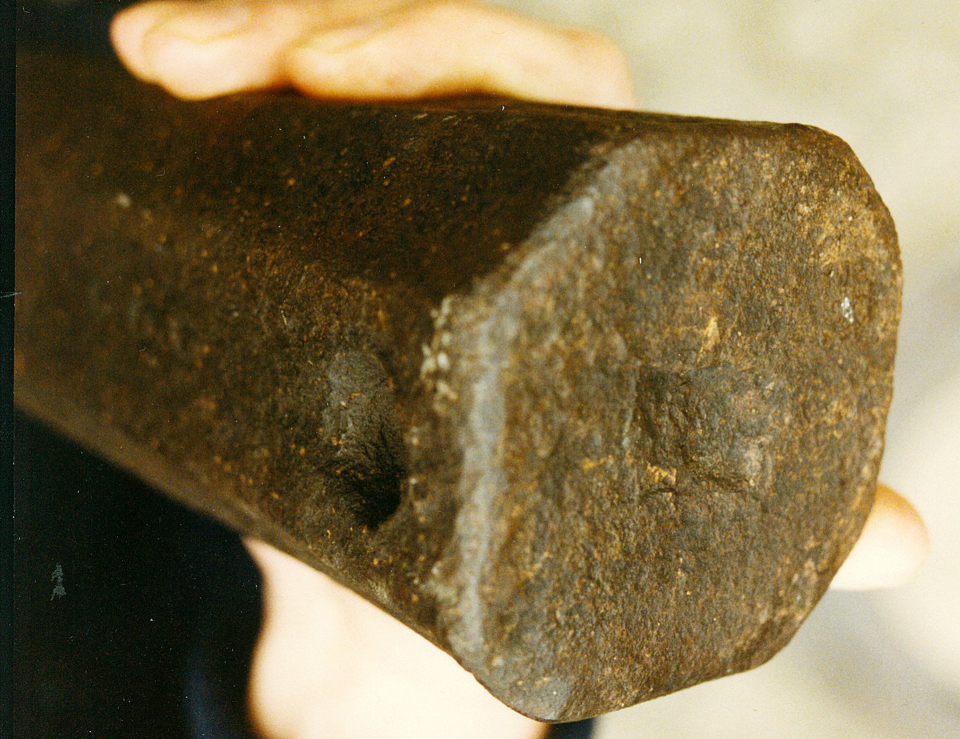

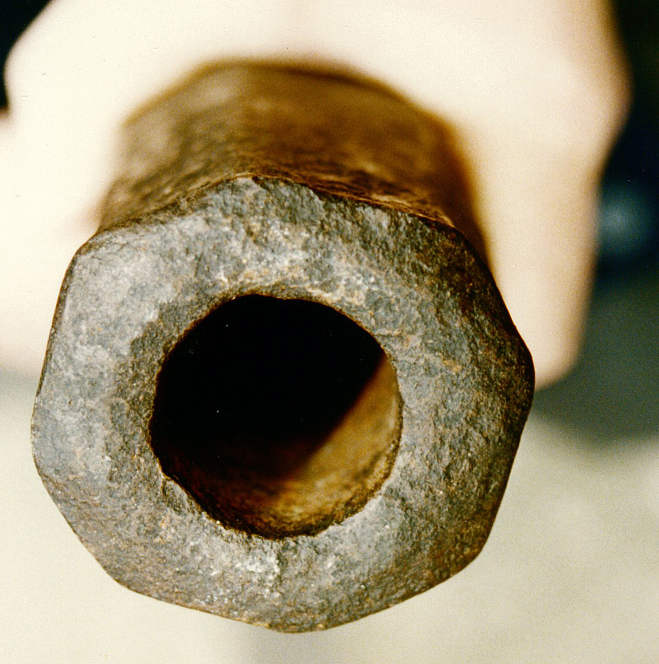

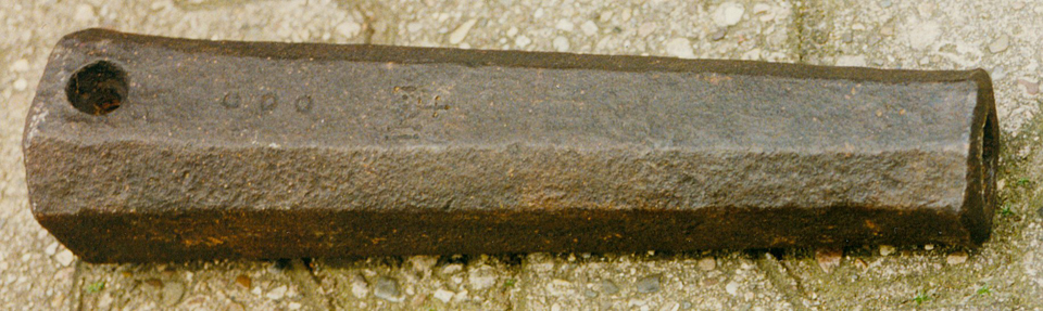

Almost certainly of Nuremberg make, wrought iron, octagonal, of tapering form with slightly swamped muzzle, deep and large touch hole with rudimentary pan moulding, gunsmith's marks: three circles in line and a series of illegible symbols (a date?), surmounted by a cross.
Originally most certainly not individually stocked but part of a mutlibarrel cannon arrangement.
Overall length: 36.8 cm, cal. 29.5 cm, width at the rear 9.4 cm, width at muzzle 6.3 cm, weight ca. 7 kg.
Rumor has it that my friend Fernando will quite soon be able to present a very similar item ...

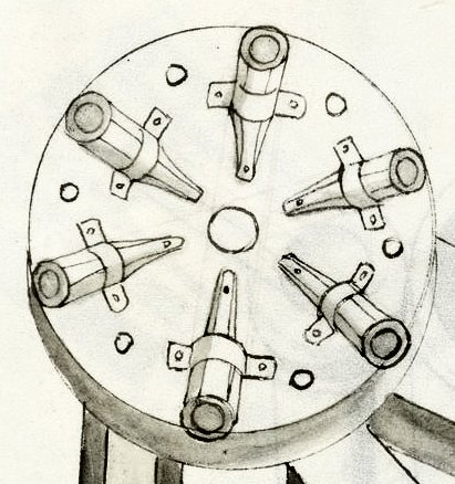

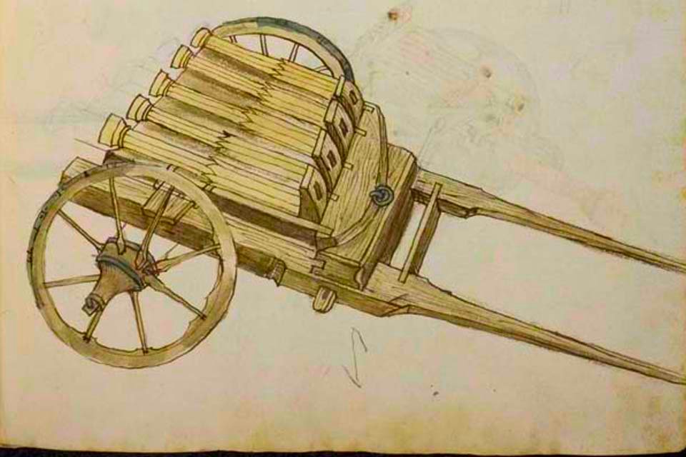

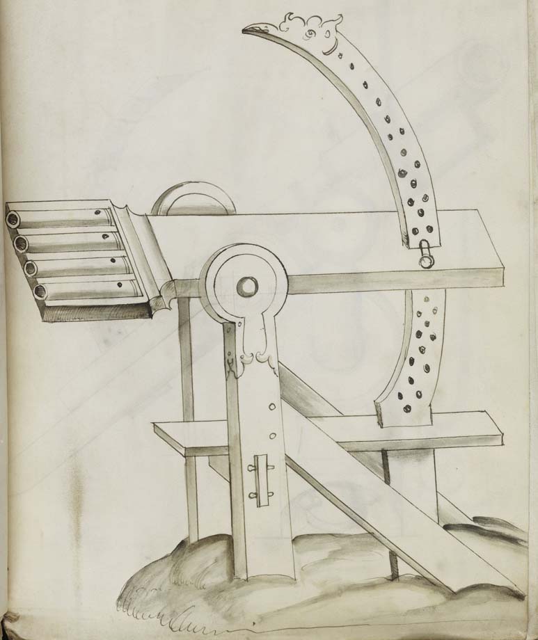

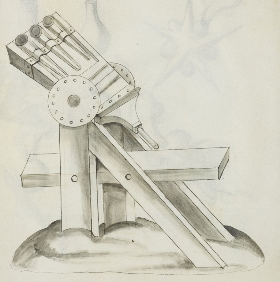

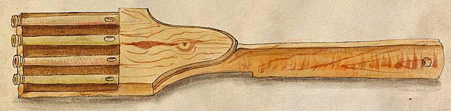

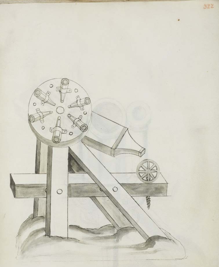

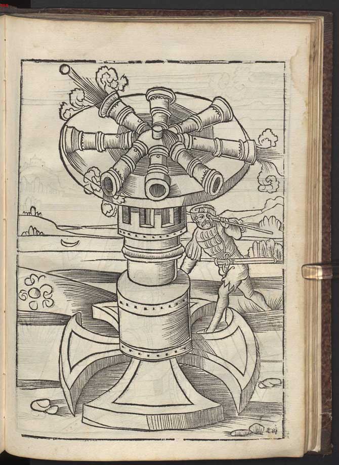

More sources of illustration depicting mulitbarrel devices.
Old 29th July 2009, 04:05 PM   #5
Hi Michael,
There should be some kind of dope, to administer to early barrels; to put them spitting out whether they acted as single or multi weapons .
Fernando

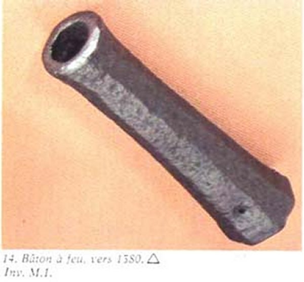

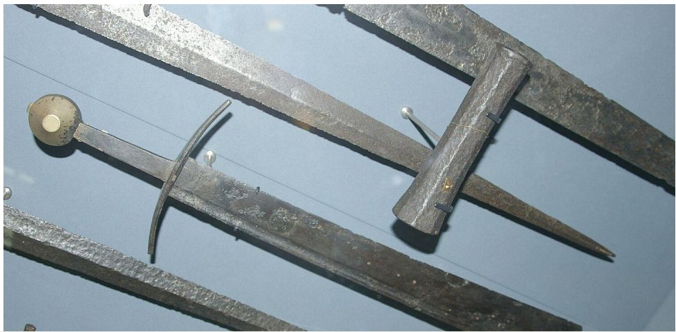

A closely related specimen at the Musée de l'Armée, Paris, dated to around 1380 by the museum people which is almost 100 years too early in my opinion.
The general shape, the swamping of both the rear end and the muzzle, as well as the proportions and the moulded touch hole are very similar.
