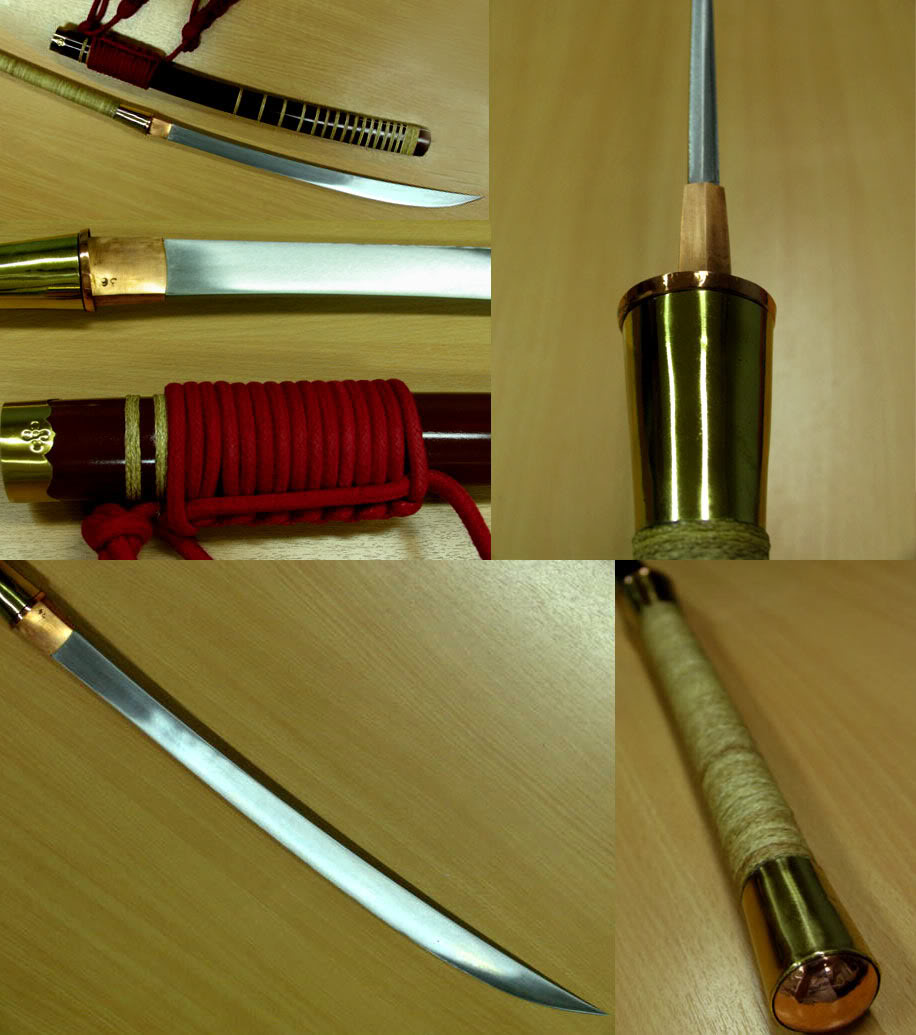

It seems all right. Distal taper, so forged blade, not stock removal. The seller doesn't say anything about the tang, whether it's forged or a welded rat-tail. The former is good, the latter very bad and potentially dangerous. Welded rat-tail tangs can be weak and they may snap off if you wave/hit the sword vigorously.
Let us know how it feels when you receive it.
Too bad about the copper habaki. A feature of Japanese nihonto, not thai/burmese dha.
Maybe you could have found an old dha for the price.

This is a new sword of course, it is advertized as such, but it is not necessarily Chinese. A number of Thai firms and craftsmen are producing new dha and other swords, ranging from poor to quite good quality.
Fearn, the HI khukuri don't have habaki per se, just much larger bolsters. Traditional khukri were constructed in the same manner but with smaller bolsters/ferrules. These serve to reinforce the hilt-blade connection.
The habaki serves only as a locking mechanism for the blade to sit in the scabbard without touching the scabbard's inner surfaces.
I think in the dha above the habaki is there purely as a stylistic feature, mimicking in a way the more popular nihonto.

This looks like a nicely-made modern daab. I very much doubt it is from China - as has been said there are a number of smiths around Thailand that still make daab. It looks quite solid. Please let us know how it feels once you have it in hand. Not a bad start to sword collecting, I think.

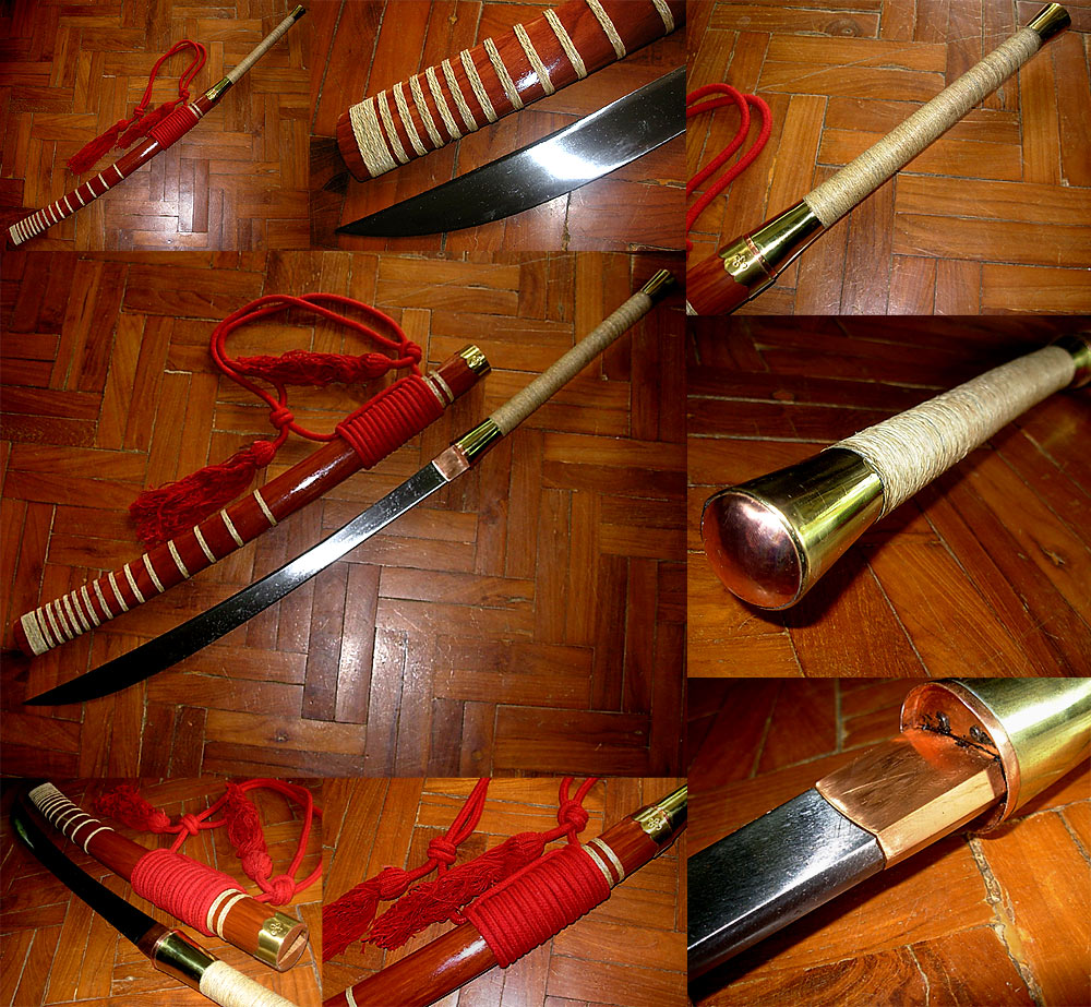

I actually have it here with me Very sharp point, good slicing ability from the belly and the rattan wrap looks great. Since it was sent out directly from Chiang Mai, I really doubt it was made in China. It appears to be solid and handles quite well. Interesting point about the habaki--I thought I had quite a traditionally made darb on my hands! Thanks everyone!
BTW, is there any way I can find out what kind of tang this sword has?

Try to remove the handle
It's a bit of work unwrapping the rattan, removing the brass ferrule and habaki, and even then the handle might be glued. Ask the seller. If you feel this is a good product and you say so, he shouldn't have any problem answering and giving you other construction details.

i use a strong magnet on my dhas & darbs, if you slide it along the grip you can feel where it pulls on the tang. another way is to suspend the magnet on a string and move the grip across in front of it from the pommel, it'll start deflecting slightly when you reach the end of the tang.
not all have short stub tangs.
two from aranyik
the top one here has a more traditional stub tang about 4in. long, with a steel rod welded to the end that is threaded to hold the heavy metal pommel. blade is differentially hardened, no habaki. heavy steel bolster to absorb the shock of a cut without breaking the handle.
bottom one has a broad tang that extends most of the grip and is pinned in two places with1/4 in. steel pins, again the end has a small rod welded to it to hold the steel pommel. again no habaki and a very thick steel bolster. this one is built to take it. again, a differentially hardened steel blade, but this one was professionally polished.
traditional dha/darb with 3-4in blind stub tangs worked on the battlefield for centuries, i'd not be afraid of using one like that, as long as the resin was in good shape...
i've also seen them where the tang is actually a rod welded to the ricasso of the blade and ground down. avoid them like the plague. they can break under light handling and the flying blade knows no mercy.

Gone for a few days and look what fun I missed :P The seller is truthful in what he says, the sword is from Lampang, not China...I can vouch for that because I have a similar piece which I know it came from the Lampang, versus the more commonly found Aranyik style which kronckew has in the pictures he posted.
These blades are better than the Aranyik daab, which have very little profile... they are more mass produced...more like a lawn mower blade...the Aranyik blades & handle feel very sturdy though...on the lampang piece I have I feel the handle could be a bit beefier...it would be interesting to know how they put the handle together.
I have not heard of this old thai smith Go Neaw. The seller's claims that he is the best sword maker in Thailand seem a little much.

Oh, and the habaki....true it's not traditional, but you do see this on some Thai hybrid swords due to Japanese influence...I will say though with the habaki, it does fit very nicely in the scabbard...and the overall finish work on the scabbard inside is much better...the aranyik ones are very rounghly done...in a generic shape to fit the different sword tips they make...so the aranyik blades all rattle in their scabbard and slide out very easily if tipped upside down...versus the Lampang one can be tipped upside down without any problem

Seller just got back to me and said it is definitely full-tang construction! I knew I had a keeper on my hands.
