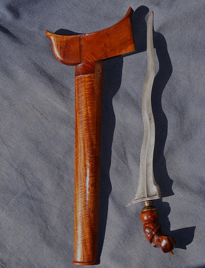

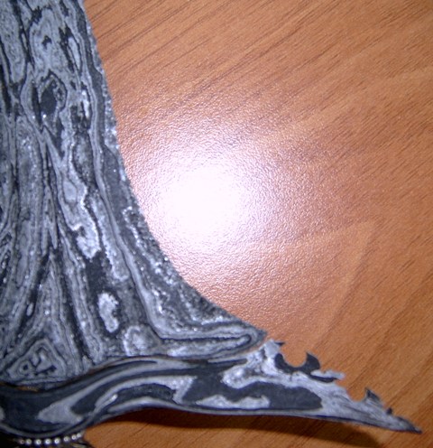

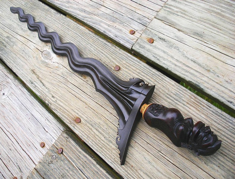

do you mean sparkling like this one in this sword? or a sparkling one like in this keris?
ferrylaki is offline   Reply With Quote

Hello Rick, thank you for the picture. Very beautiful keris; I like it a lot!

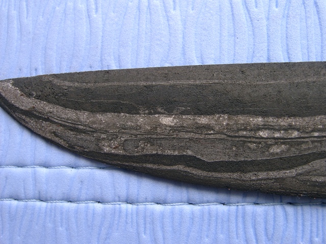

Such as this ?
Old 13th June 2009, 01:11 AM   #12
Posts: 7,228

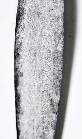

I'm not going to comment specifically on the blades pictured, but if we look at the pale pamor material in the pedang we can see little white specks.
When we find a lot of these in ferric material it is very probably caused by forging at low temperatures. Prof Jerzy Piaskowski of Poland conducted a number of analyses of this type of material and this was the conclusion to which he came.
The effect can be quite impressive in a blade that has only plain steel and no contrasting pamor, it looks like little white clouds floating below the surface of the iron or steel, almost three dimensional.

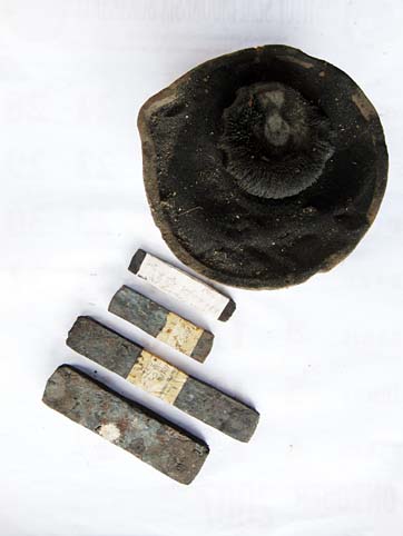

These pictures below are experiments of our German keris man Dietrich Drescher (hopefully Empu Kumis will respond this post). I took these photos at the besalen of Subandi Supaningrat -- one of Surakartan keris maker in the eastern part of Solo, Jawa Tengah (Central Java) medio last year.
As long as I know (I hope Empu Kumis will respond it too), he had made some experiments with Pak Subandi and Boedhi Adhitya (Yogyakartan keris connoisseur) to make blocks or "iron" of Cilacap sands. Cilacap located in the southern coast of Central Jawa. Why did he choose Cilacap? I think Dietrich has a certain reason on this. He selected the Cilacap "iron sand" material with magnetic piece of iron (see picture below) and then melt the iron sand, before being forged in block forms (please correct the right English term) as you see in the picture below ...
And I remember, Dietrich had shown me a newly made "wedung" with this kind of "iron sand" pamor couple of years ago, to prove his 'thesis' on "wesi malela".... I hope this info would help you

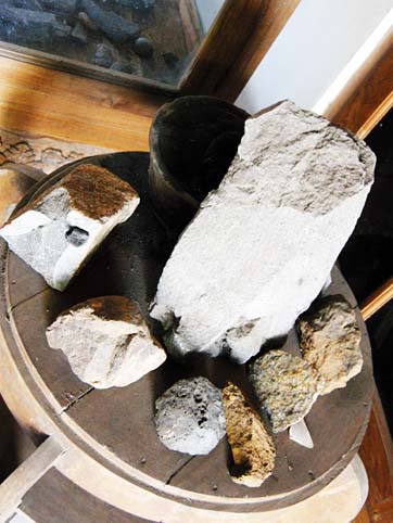

This is more picture of 'iron stones' that probably contained iron ore at Subandi's besalen in eastern Surakarta.
GANJAWULUNG (Guangzhou, June 16, 2009)

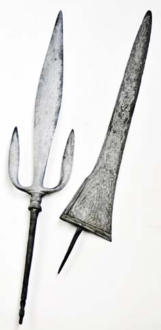

I tried quite a couple of times to portrait the "glittering" or "sparkling" effect of the blade that you probably meant to. But I don't think I can show you the good photo of it.
These two blades -- one (supposed to be) Pajajaran or Cirebon trisula, and one keris of dhapur "gumbeng" (quite similar to "kebo lajer" but not to thick) -- also supposed to be a Pajajaran gumbeng, with "sparkling" or "crystaline" grains in the blade...
