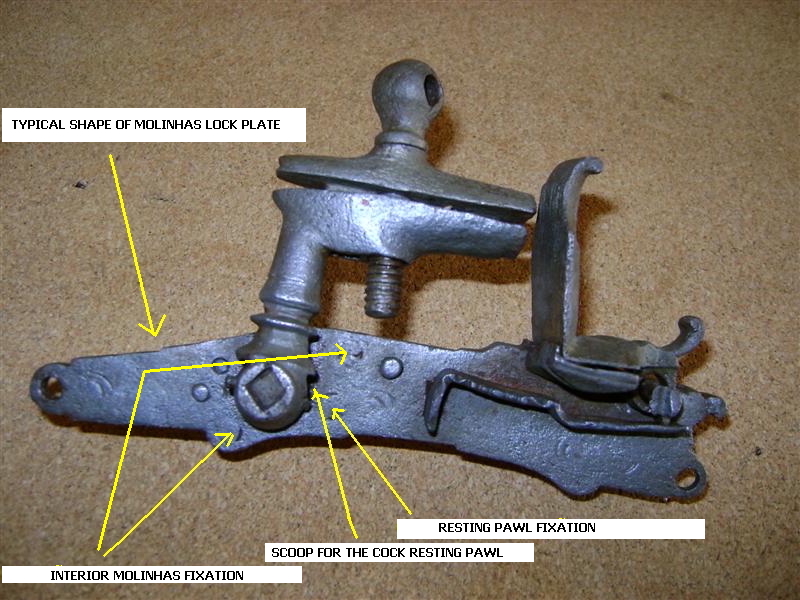

A lock for a shoulder gun, probably a regional work.
I would date it XVIII century. The plate is fixed with three screws ... a sign of age, right?
I think the cock can be called the column type.
Here and there, traces of a very simple and unpretentious decoration may be seen.
If i see it right, the name over here would be Fecho de nó (Knot lock).
The frizzen hole is so much wider than its fixing screw ... whether it is much worn, or a replacement (though it looks the original matching one ) or used to be filled with some kind of bearing ( which sounds funny to little knowledge).
In the brilliant work written in the XVIII century, Espingarda Perfeita (The perfect Gun), the authors write that the knot locks aren't accurate for firing in the air, since they are too stiff when pulling the trigger ... many persons used them because they are cheaper.
I would love to hear coments about this device, gentlemen.
Fernando.

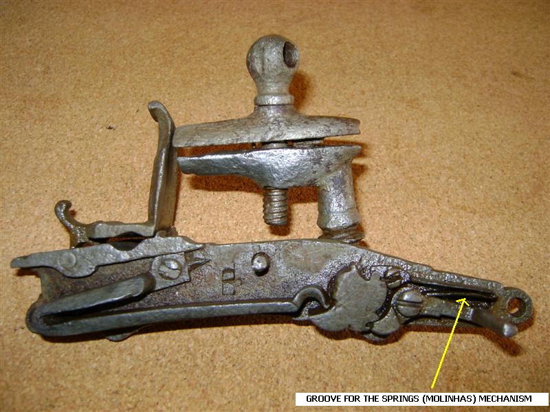

During the cleaning of this lock, i was wondering about the traces of some filled in orifices, as well as other intriguing details.
I went back to the illustrations in ESPINGARDA PERFEYTA, checked and rechecked, and came to the conclusion that this is a typical Portuguese 'fecho de molinhas' (spring lock), later converted to a simplified version.
I can say i made my day, both for the price, which becomes much more convenient, as also for the rarity of these locks ... converted or not.
Thank you for your congratulations

Thanks a million for your great comprehensive post, Philip.
I see that it came in whilst i was preparing mine, about the molinhas conversion.
You were right about the plate shape being strange for a knot lock.
It all makes sense when you look in page 461 of 'Espingarda Perfeyta'
Fernando
