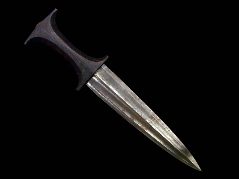

Hi all,
I just picked this up yesterday, the blade configuration and quality caught my eye. I'd like to know when and where it might have come from, Sudan is my best guess.

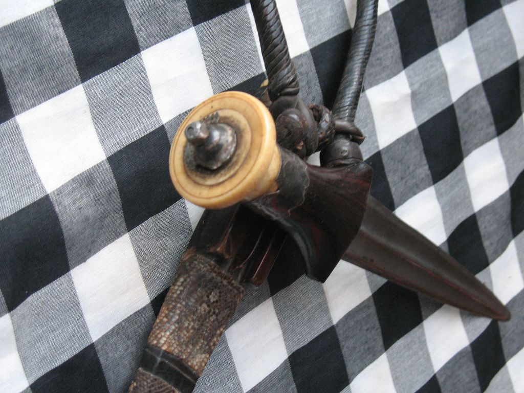

Posts: 3,191
Warren
I saw that one and its real nice with well defined fullers. My guess is pre 1940s. When you get it take a pic of the hilt looking down at the top of the butt I need to see the finale.
Lew

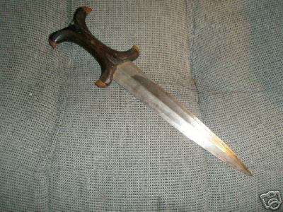

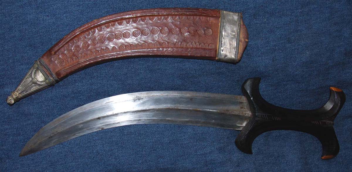

Nice blade. Here is one very similar, though it's curved. This dagger is the traditional Hadendoa/Beni-Amer/Beja "X" hilted dagger. So it is surely Sudanese/Eritrean. The construction of your blade is very similar, plus the shape of the hilt suggests Sudan/Ethiopia. Too bad the scabbard is missing.

A more recent example for comparison.

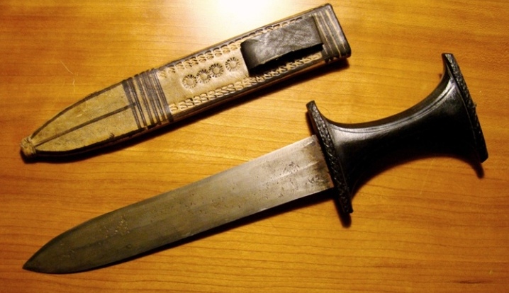

Old 12th May 2009, 01:39 AM   #9
Emanuel
Emanuel's Avatar
Join Date: Jul 2005
Location: Toronto, Canada
Posts: 1,242
Nice dagger, Warren. I especially like the handle.
Here are two more for comaprison, turn of the century (19th-20th) or so.
Cheers!
Emanuel
Old 12th May 2009, 01:54 AM   #10
Lew
Lew's Avatar
Location: East Coast USA
Posts: 3,191
Manolo
Your top dagger is of the Omdurman style (thats my classification) which was very popular during the late 1890s-1900 a nice example. Warrens seems more Hadendoa to me and probably dates from about 1918-45.
Lew
Old 12th May 2009, 02:21 AM   #11
Emanuel
Emanuel's Avatar
Join Date: Jul 2005
Posts: 1,242
Yup, I remember the discussion we had when I got it. Was I a happy camper that day The blade's got Umdurman written on it, so your classification is most applicable.

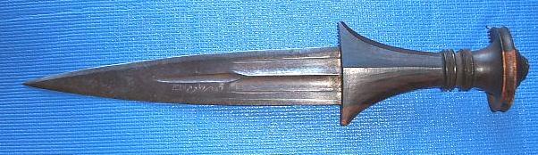

Old 13th May 2009, 12:10 AM   #12
asomotif
asomotif's Avatar
Join Date: Nov 2006
Posts: 2,238
Those addictive little arm daggers
Here is my example with fullered blade for comparison.
Willem

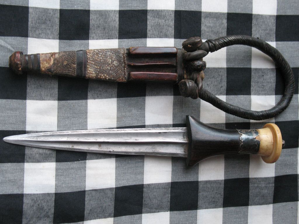

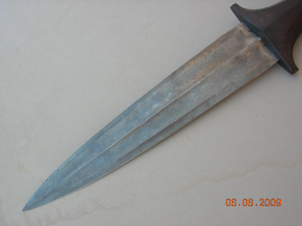

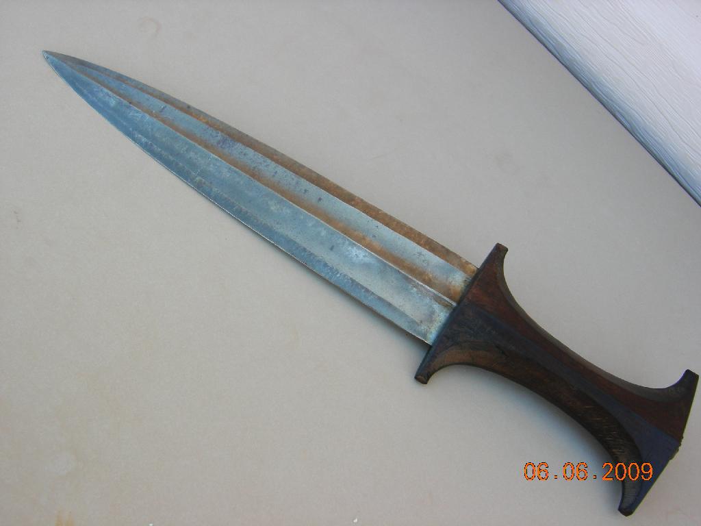

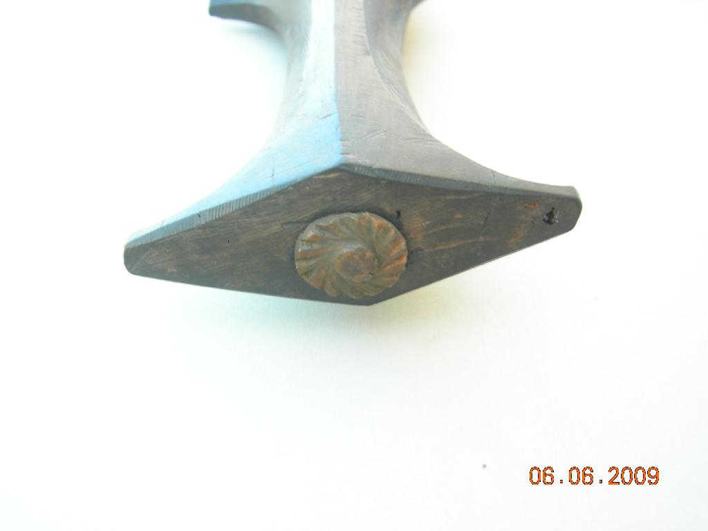

Well, This finally arrived after being shipped to Israel by mistake . It almost made it back to where it was born
I've done some light cleaning and added some pics that Lew asked for.
If you have an idea of the age of this knife I'd be eternally grateful.
Thanks Much,
Warren in (HOT) Arizona

Old 6th June 2009, 10:00 PM   #17
Emanuel
Emanuel's Avatar
Join Date: Jul 2005
Posts: 1,242
That's a sexy blade Warren
Early 1900s seems plausible.

Old 7th June 2009, 02:03 PM   #19
Lew
Lew's Avatar
Posts: 3,191
Manolo
The hilt doesn't have a smooth patina file marks still evident on the wood probably 1940s era. Still an excellent example .

Old 7th June 2009, 10:12 PM   #21
Lew
Lew's Avatar
Posts: 3,191

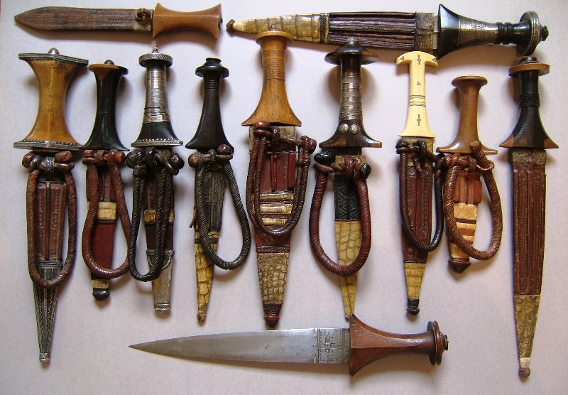

Warren
Patina overall quality,scabbard constuction/style and materials. Below are a grouping from my collection. Second from left,center and second from right are 1930s-40s. 19th century daggers usually have heavier better quality silver or some have small coins (PIASTRES) at the end of the pommel. Also many old ones are marked with a date most from 1890-1900.

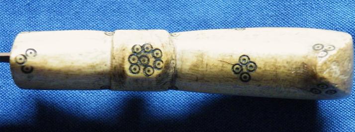

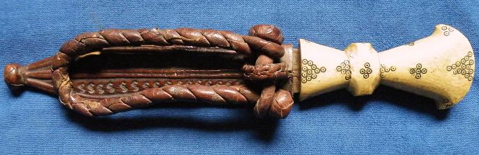

Old 10th June 2009, 05:02 PM   #28
colin henshaw
Join Date: Jan 2008
Posts: 1,434

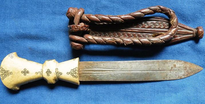

Hi

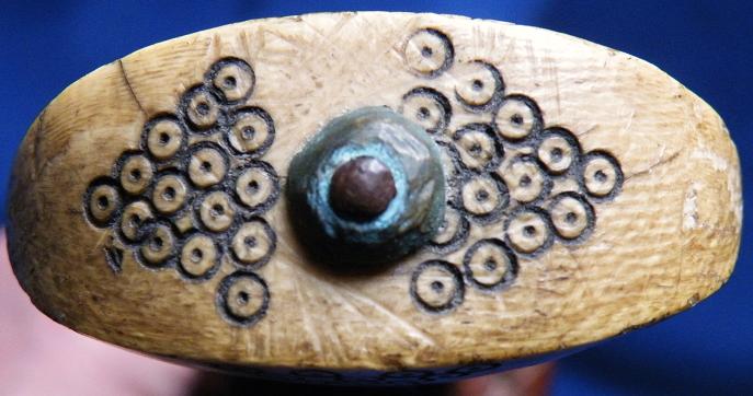

Here's my contribution - got this recently. That "circle and dot" motif seems to get everywhere.
Old 10th June 2009, 05:11 PM   #29
Lew
Lew's Avatar
Posts: 3,191
Colin
Can we see the blade please?
Old 10th June 2009, 05:49 PM   #30
colin henshaw
Join Date: Jan 2008

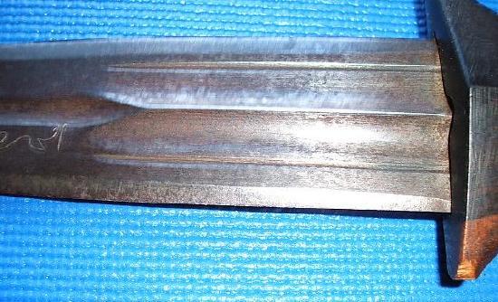

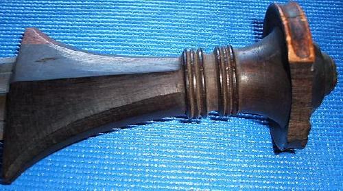

Posts: 1,434
Here it is, needs a bit of cleaning. Also a picture of the handle from the side.
Colin
