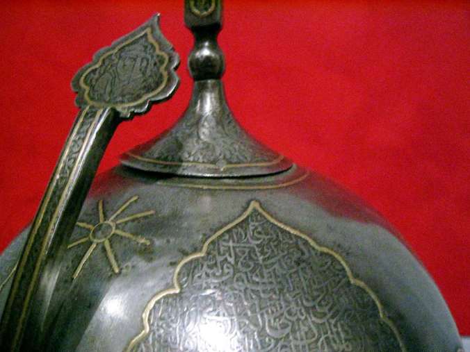

Dom 21st February 2006 01:26 AM
3 Attachment(s)
Hi
your request was; "to post as much pictures/drawings of armour from outside europe, especially from the middle-east"
this answer doesn't came very fast, but at least not the last may be :o
a part of my little treasures
à +
Dom
http://www.vikingsword.com/vb/attach...tid=8746&stc=1
http://www.vikingsword.com/vb/attach...tid=8747&stc=1
http://www.vikingsword.com/vb/attach...tid=8748&stc=1
