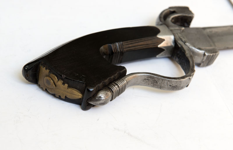

Default Oman, Morocco or Zanzibar?
Who can say more about it?

Hello Kurt,
The shape of the guard is moroccan. The scabbard is very interesting, reminds me of persian style!
It looks very small though, what are the dimensions?

Hello Kurt,
Total length is 95cm .
Best
Kurt

"It looks very small though"
Because it is a "Nimcha" :-)

You have a nice nimcha with atypical blade. The hilt material - is it ivory or camel bone and gold?

Default The hilt material
Hi Battara ,
The handle is made ​​of ivory.
With 20 carat gold.
Kurt

Hey Ariel,
Can you explain more please? most of the nimchas I have seen ( have 3 personally) have european blades of normal length. I must say though, I like the length on this one, looks vicious!
Old 30th July 2011, 04:04 PM   #8
Most of my info derives from Elgood's book, where he explains that nimcha has a connotation of being small. This one has a feel not of a Moroccan one, but of a South-Arabian ( Oman, perhaps, since they had more sophisticated tastes and were a seafaring bunch). Such swords are quite useless as cavalry weapons and would not be suitable for horse or camel riders, but ideal for sea battles, analogous to european cutlases.
Kurt, it is a beauty!!!

Kurt,
Most interesting example . The term 'nimcha' has been most often colloquially applied to the Moroccan sa'ifs which typically have this distinct hilt system. This hilt type with downturned quillons and incorporated upswept knuckle guard developed from probably Italian hilts possibly as early as 16th century, but did not attain wide popularity in the Maghreb until the 17th.
The blades on most of the sa'if's in Morocco which we know as 'nim'cha (=Ar. short sword) are interestingly with full length blades, as typically they were from European trade blades readily available in the trade networks to the ports of the North African littoral. Also the well known 'Barbary Pirates' brought materials including blades to these areas.
The hilt style on this weapon actually seems Arabian to me, and has strong resemblances to Hadhramauti types of swords (the discs are seen usually in repousse silver karabela type hilts), and the scabbard which along with the mounts seems more modern of course than the blade. The blade resembles earlier European military types of 18th-19th century sidearms and of 'cutlass' type. This incarnation seems to be Ottoman sphere quite likely Arab and recalling the much shorter hanger/cutlass type weapons that were well known in Arabian regions in Ottoman control and favored for maritime use.
I know I have seen this hilt (with the peaked extension at top of hilt) and the swirled motif embossed in the leather of the scabbard but need to look further.
In the meantime, very nice example Kurt, and hope my thoughts are of some help.

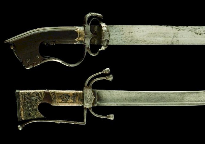

I found this interesting "Nimcha" (?) In a French book.
could this decoration be from the 18th century.
Nimcha or Saif?
Dear Louis - Pierre you can say more about that?
Best Kurt

Hi Kurt,
It may be a presentation Nimcha even if it misses the full set of quillions (of which the guard). The profile of the handle is the same that the one of a Nimcha.
This type of work on silver was and is again nowadays done by the jew community of the casbash. Prudently, i would say late XIX°, early XX°. Why not before?? But, the blade would tell more for its datation.
Best for you.

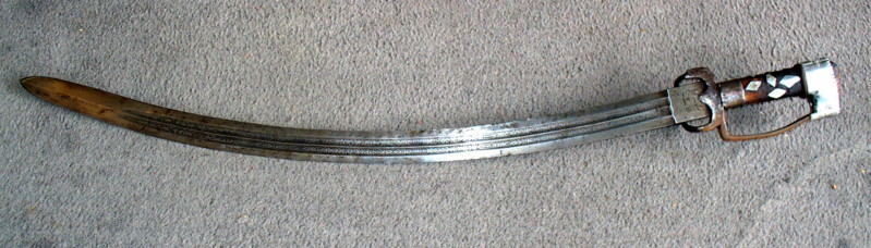

as per
"George Cameron Stone"
"a glossary of the Construction, Decoration and Use of ARMS AND ARMOR in all countries and all times"
Arab.
Grooved blade 21 inches long.
Hilt covered with tortoise shell and inlaid with pearl,
engraved silver mounts and brass guard
Kurt, in case of, your hilt and guard did looks as well the above description
the general shape of your sword is the same, isn't it ?
and to complete the picture ... if I might said so
the last pic, is issued from a book in French
"ARMES ET ARMURES
armes traditionnelles de l'Inde
by; E. Jaiwant Paul
comments attached to this pic;
- poignée d'épée sertie de pierres précieuses, Rajasthan
(sword hilt set with precious stones, Rajasthan)
very popular, this type of hilt
from Morroco, to Zanzibar, passing by Saudi, might be Indonesia, until India
really popular
à +
Dom

The shortness of the quillon block and its lack of bowed-out sides suggest an Eastern (Swahili?) origin rather than Mooroccan. The squared shape of the quillon tips also suggests such origins. It lacks the annoe often seen on such pieces.
The way the groove runs out at the tip suggests it might have once been a longer blade.

Kurt, thank you for the response. Now that I have been able to 'hit the books' I can see in Elgood the illustration of the Omani sword which is typically associated with the interior regions, and the scabbard does have this interesting pattern motif embossed in the leather (p.17, 2.13).
These pronged pommel type hilts do seem widespread in use and from the 17th century (possibly earlier) and probably well through the 19th. In looking at various examples of these,one example ("Arts of the Muslim Knight", Furisiyya, Milan, 2008, p.77, #41) with the same type hilt, but single downturned quillons, is shown as having been captured at Battle of Oran (Algeria) in 1732). These are shown as 'cutlasses' and often found in naval context throughout the North African littoral. This same type hilt on a sword also pictured in Elgood ("Arms and Armour of Arabia" p.11, 2.2) is strikingly similar in profile, but subtle variations in decoration and blades. This may well be the one mentioned from Stone as well, as the 'tortoise shell' is mentioned in all representations.
It seems these were notably popular in Ottoman association (particularly in N.Africa) and examples of these in Ottoman context are known from as early as the 16th century. The influence of the hilt form seems to have diffused into the Deccan in India in the 17th century as hybrids of the peaked pommel or pronged, are seen with Ottoman type quillon terminals and Indian langet. The linear design of rosettes on the hilt faces similar to yours bring to mind that Hyderabad produced swords for export to Arabia, typically Hadhramaut in the 18th century. Many have these same type discs in motif.
Elgood notes these cutlass type swords with such pronged hilt profile are well known on Arab maritime routes. The coastal region in Oman, Muscat, is the trade power which also controlled areas beyond Zanzibar, which included parts of North Africa including Libya, Algeria and Tunisia in commerce. The Ottomans were driven out of Oman by Ahmed inb Said of Yemen in 1741.
All of this seems to show distinct links in Arab maritime provenance to this type of sword, and hilts of this form with profound traditional presence. The heritage of the style from North Africa, connections to Arabia through the Yemen, particularly Hadhramaut (and sword influences between Hyderabad and Deccan), and the Omani type leatherwork in scabbard with Arab type cord and fringed swag trappings present hybridization noted to be quite well known in these type swords.
As usual, just thinking out loud here, and that this cutlass may well be quite old and simply newer scabbard, and in ivory/gold for someone of importance in trade connected to Oman's networks. It seems the merchant class in Oman were quite status and fashion conscious, but they typically carried the cylindrical hilt kattara.
Obviously these ramblings dont present anything conclusive, but hopefully the elements noted will offer possibilities for consideration and maybe even some discussion
Extremely exciting piece there!
All best regards,

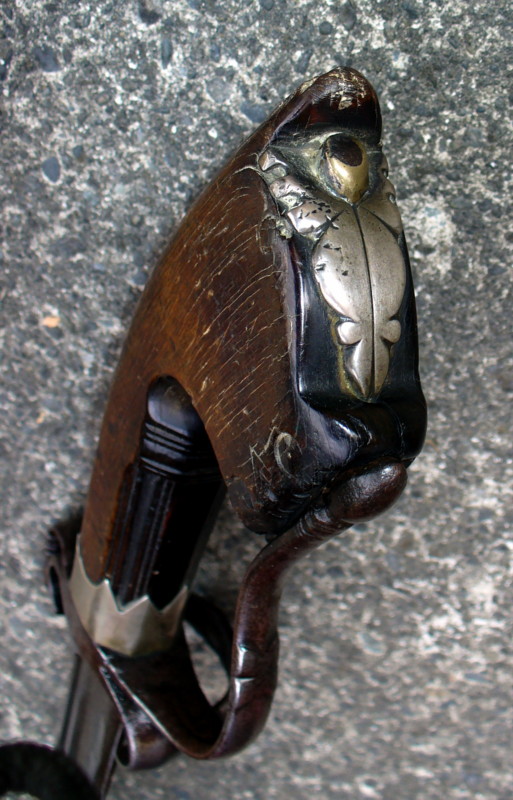

I would like to offer these images of the same type of sabre.
Where once these swords were very rarely seen, the last 12 months alone has seen 4 that I know of on the market.
The suspension fitting on this example is similar to another seen and may also offer some insight to the origins.
All 4 examples I viewed had the single upper suspension mount only, 2 like this, 2 like Kurts.
I feel they could be from the Oman Persian Gulf regions.
