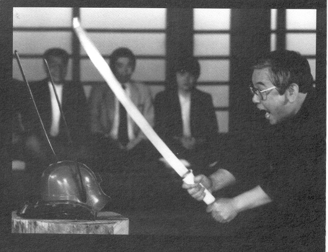

Originally Posted by Chris Evans
I have a reference, somewhere in my library, in which an experienced old samurai criticized a display of helmet splitting, by a colleague, arguing that he cheated buy using a naginata blade. Perhaps tsubame1 (carlo) can help us out here.
Naginata is for sure a thicker blade then a Katana. Anyway,
Kabutowari (helmet-cutting), even if much less known then other forms of
fixing Wazamono rating (ability to cut) has been performed in old times and

The following picture (not reported in that site) refers to the experiment made by (scroll down to Post-Meiji attempts in the link provided) Terutaka Kawabata Sensei with Yoshihara Yoshindo *unmounted* blade. This detail is of great importance and this is the reason I scanned the picture (Obata test was made the same way, without a proper made handle).
These tests are often referred to as unreliable due to the fact the neck of
the helmet's owner would absorbe a lot of energy (resulting, IMHO, in the breaking of the said neck BTW...), an opponent isn't a fixed target but a mobile one (of no pertinence, IMHO) and that the helmet was old and possibly already damaged. Even if the first statement can have some validity, as per the 3rd one the helmet was accurately choosen and of good quality (sic...) and the blade made the traditional way. The lack of mounting can only add to the ability of the cutters and, in a lesser way, to the quality of the blades. Being the helmet, for it's shape and paramount importance, likely the most resistant part of the armor, it can be, IMHO, safely assumed that *some* armors, might be the lesser or lighter ones, could be cut *in some places* (sleeves and other) by a sword (not necessarily a japanese one and no matter about the steel used).
