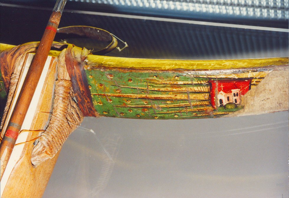

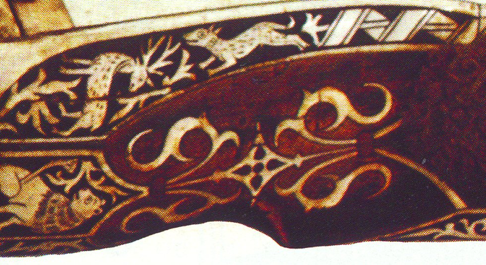

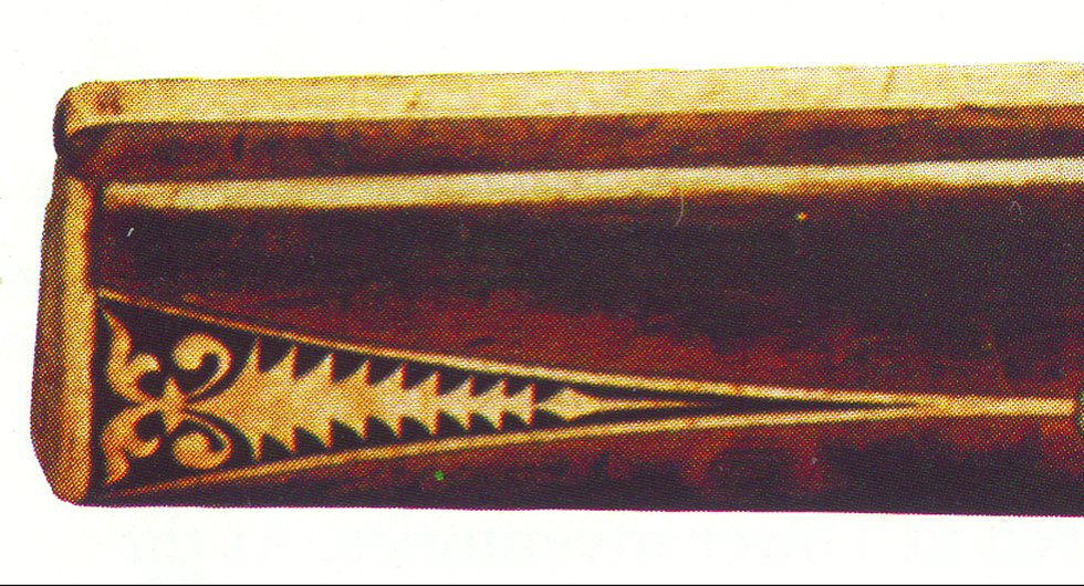

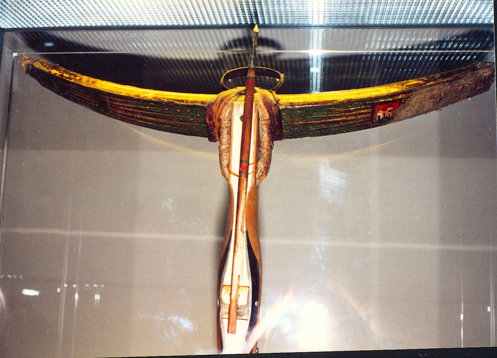

Old 6th January 2012, 02:50 PM   #63
Swordfish
Join Date: Oct 2010

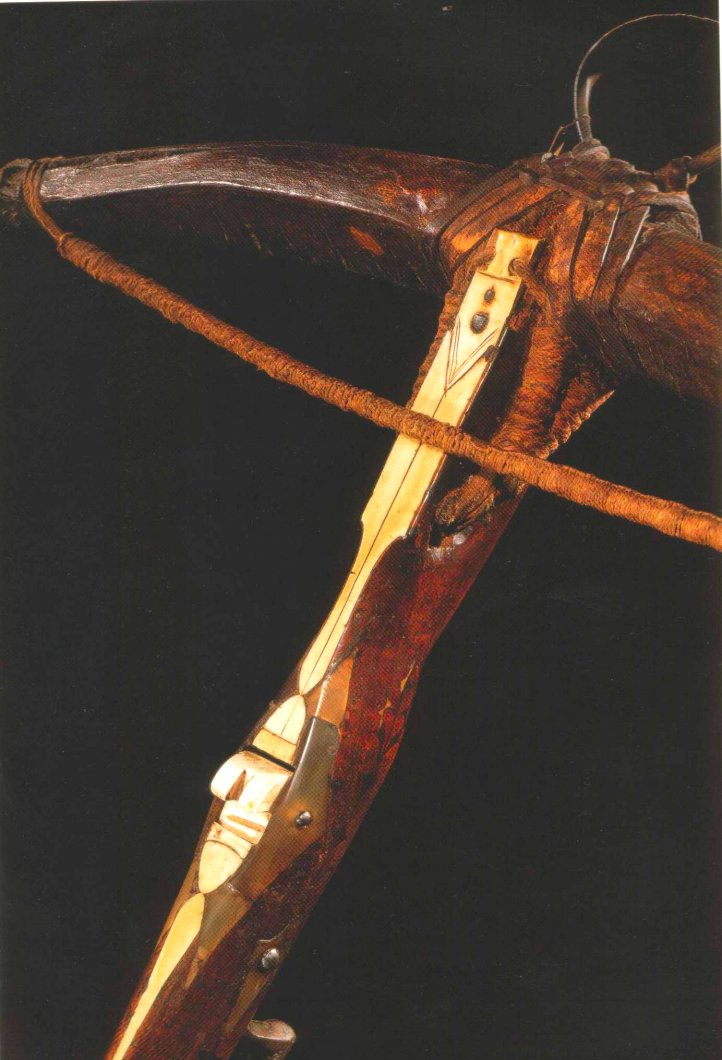

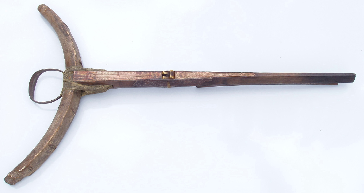

Posts: 129

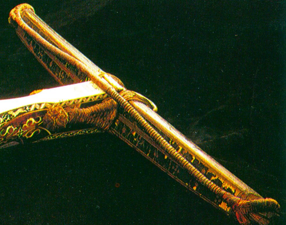

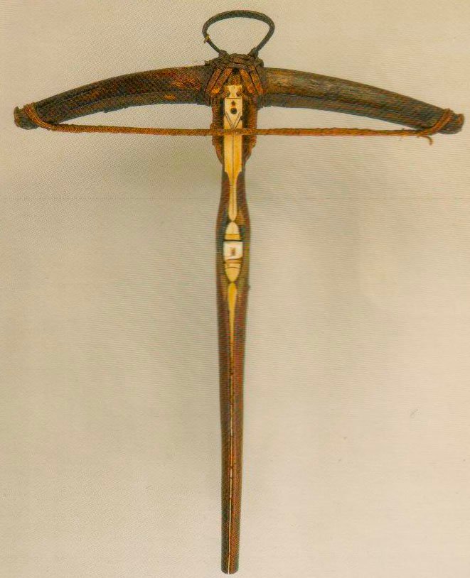

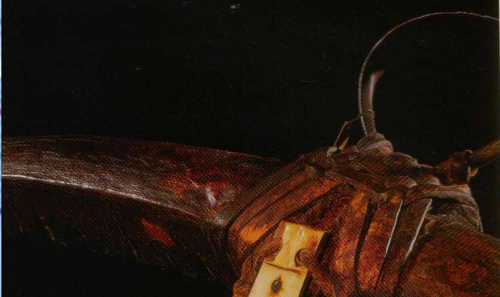

A gothic crossbow with horn bow dating c. 1430-1460.
This crossbow failed to sell at an auction some years ago, because it was wrongly described as Scandinavian dating c. 1500.
A few years later I saw it in a private collection, where I took the photo.
In this collection was also another crossbow of typical central European shape with a tiller made of fruit-wood and a spanning-hook at the upper side.
Both crossbows had identical (really identical, not only similar) elements:
The strongly reflex horn-bow, the stirrup, the cord binding and the trigger lever. Therefore both crossbows must have been made by the same maker or in the same wokshop. This workshop was in South-Tyrol. This is proofed by an exhibition label on the bow inscibed by hand with No. XII and with a latin text stating that this cossbow was was once in the collection of Castle Rodeneck (South-Tyrol),and dated 11.April 1891.
The crossbow on the photo is a somewhat simlpler version than the usually known ones. The tiller is made of more durable oak, the side plates are iron sheets instead of less durable horn plates. The only decoration are the horn plates on the upper side. The spanning- hook is on the bottom side, probably for a cord-puller, as can be seen on Italian paintings of the period.
While the horn inlaid crossbows with fruit-wood tillers can be described as all purpose crossbows suitable for sporting, hunting and war, the crossbow on the photo is surely only for one purpose. It is a war-crossbow.
Swordfish is offline   Reply With Quote

I have known this crossbow since it first appeared on the market and I too know who it is with. There are some doubts about it, but anyway the iron side plates are of a surface that keeps me from thinking it might be all original. After all, a label from 1891, the heyday of the Victorian period (German Historismus) when many of these arms were widely reproduced, is certainly no proof of Gothic authenticity, at best of Neo-Gothic made ...
So I had my reasons for not posting it here.

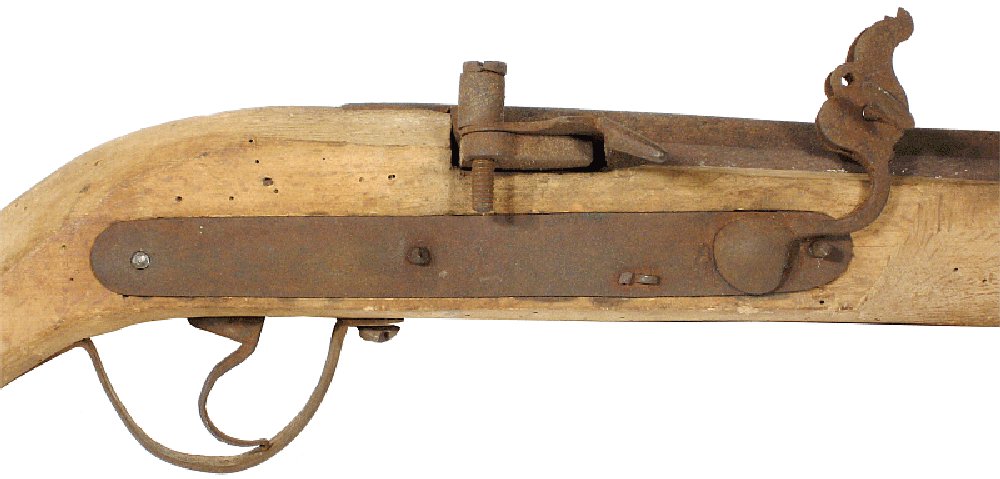

There can be no doubt that this is a gothic crossbow. As
mentioned before all elements of this crossbow, except of
the stock, are identical to a known typical central european
crossbow. The iron side plates are nearly identical to the side
plates on the Wall-crossbow you posted in thread #40.
The crossbow was in the collection of an experienced collector
who still owns the other one with the bone inlaid fruit-wood stock.
Old 9th January 2012, 05:28 PM   #66
Matchlock
Matchlock's Avatar
Join Date: Sep 2008
Posts: 4,310
But their surface does not commensurate with the alleged period of the other components! And the collector has been in close contact with a number of German and Austrian forgers over the decades, they have been interchanging various arms for display in their repective collections. I noticed the same crossbow in another far-off collection about one year after is was for sale with HH.
m
Old 10th January 2012, 03:59 PM   #67
Micke D
Join Date: Jan 2011
Posts: 41
I must agree with Michael on this one, I don’t like it.
And I didn’t like it when I first saw it at Hermann-Historica either. Then it turned up in Holger Richters, Die Hornbogenarmbrust: Geschichte und Technik (Gebundene Ausgabe - Oktober 2006), where it still was said that it was a Scandinavian crossbow. I tried to convince Richter that the Scandinavian Saami crossbows had tillers somewhat similar to this but not until the 18th c, and there was certainly no people that could make horn bows left at that time, but he still thought that it was a Scandinavian crossbow.
“Both crossbows had identical (really identical, not only similar) elements:
The strongly reflex horn-bow, the stirrup, the cord binding and the trigger lever. Therefore both crossbows must have been made by the same maker or in the same workshop.”
Is it possible that you could show us the other crossbow that you say is identical to this one?
Do you know the dimensions of this crossbow?
Is it a wall-crossbow or a big handheld crossbow?
Here I must say that I have never seen a horn bow of this size with this much reflex, of course I know of the early crossbows like W1109 in Köln, but they are of another time and type.
Can you show me a similar reflexed bow?
The yellow-greenish cord binding looks suspect to me and most probably not original. The stirrup should be lashed to the bow with leather and not the cord binding that holds the bow. The stirrup doesn’t look like anything I have seen before, it’s very thin and the outside ridge looks like it’s pressed from the inside, it looks very suspect.
This is the first old (?) crossbow that I have seen with a tiller of oak.
“There can be no doubt that this is a gothic crossbow. As mentioned before all elements of this crossbow, except of the stock, are identical to a known typical central european crossbow. The iron side plates are nearly identical to the side plates on the Wall-crossbow you posted in thread #40.”
I’m sorry but I can’t see anything on this one that I would say is typical of a central European medieval crossbow. If it had had a bow shaped more like the one in thread #40, and of similar size, I would have it easier to accept it.
Mikael Dahlström,
Stockholm Lockbow Society,
Sweden
Micke D is offline   Reply With Quote

Excellent notations, Mikael, and exactly on the point!
All crossbow tillers I have seen were of either fruitwood or lime wood, except this one.

Nevertheless, we know many paintings with white, unvarnished crossbow tillers and arquebuses. I am conviced that in times of war, wood on weapons was only meant to survive for few days or weeks, at best. Then the stocks were broken at best and replaced. Even in Thirty Yeras War paintings, we notice white stocks on both matchlock and wheellock guns. I guess, due to their quick consumption they were just not worth staining.

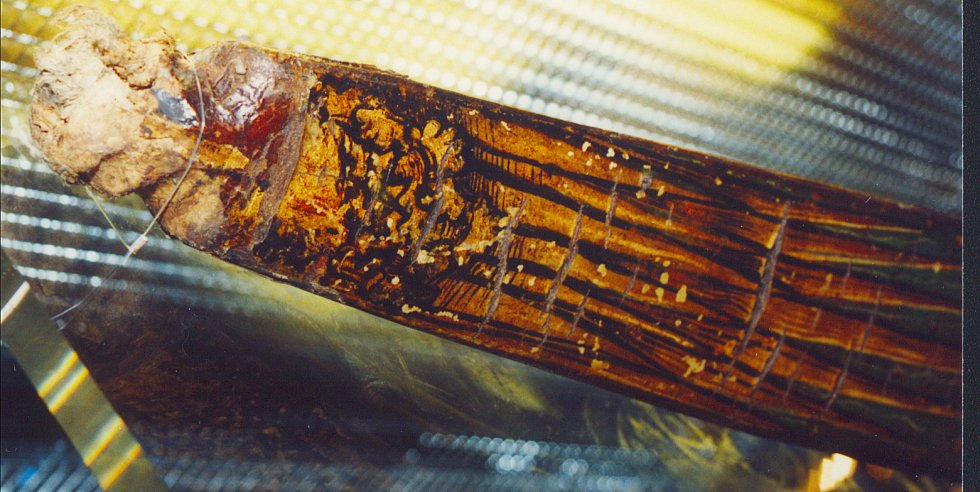

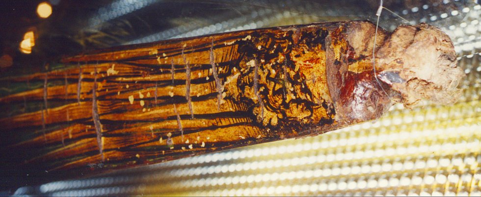

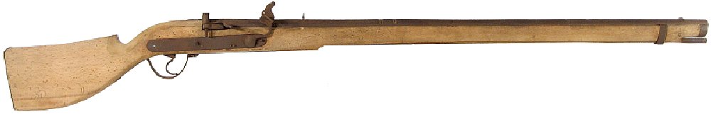

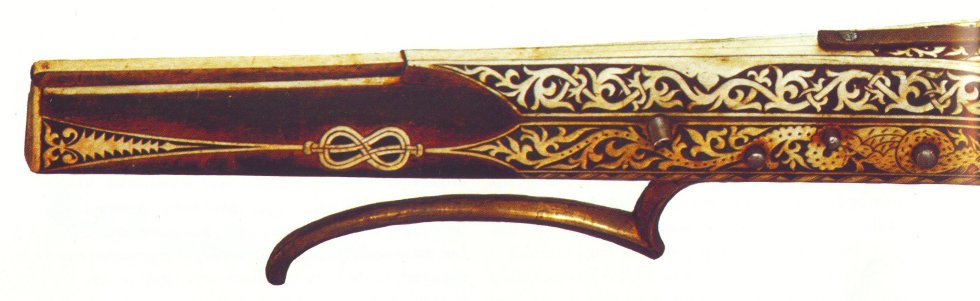

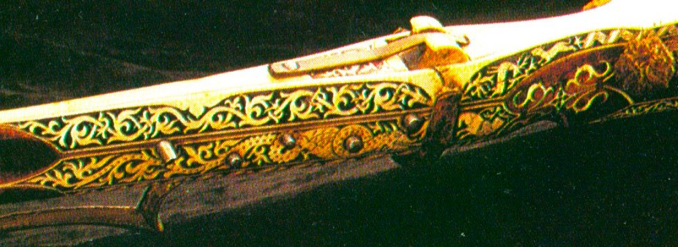

In my collection, a ca. 1645 Austrian matchlock musket is preserved with white (now heavily patinated) beechwood stock. It came from the Styrian castle of Schloss Frondsberg, from where about 15 similar muskets were sold via Tom Del Mar a couple of years ago, all in the same untouched condition with rust patinated iron parts and unstained stocks, with all the traces of original carving still visible.
A few images attached.

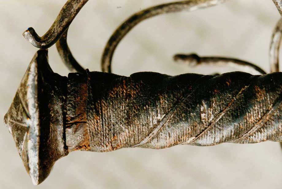

Old 13th January 2012, 11:20 PM   #74
Oh, i wish i could find a genuine hilt for my katzbalger
http://www.vikingsword.com/vb/showthread.php?t=14555
Old 14th January 2012, 12:14 AM   #75
Matchlock
Matchlock's Avatar
Join Date: Sep 2008
Posts: 4,310
Hi 'Nando,
As I said: take off the outcurved sides of the wood with a raw rasp to smoothen them, then touch them with glue and apply a rough cord binding. You may then stain the hemp binding brown with wood stain. All that hasn't to be done though to make your Katzbalger look good and authentic. It already does, at least to me.
Did you soak the iron parts in olive oil? Smoothen them just lightly with 600 grain paper and oil them!!! You will be overwhelmed!!!!
BTW, are you sure your post was placed in the right thread, my friend?
Michl

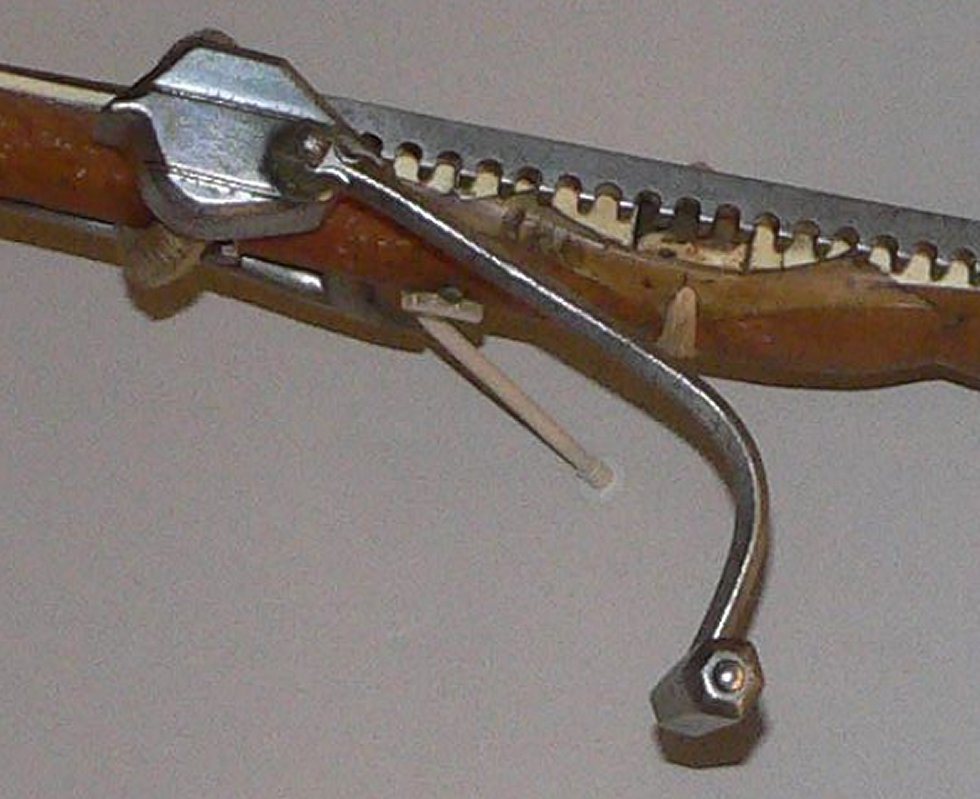

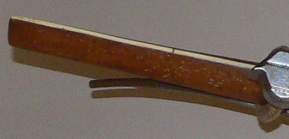

Old 18th January 2012, 03:00 PM   #77
Matchlock
Matchlock's Avatar
Join Date: Sep 2008
Posts: 4,310
Hi Micke,

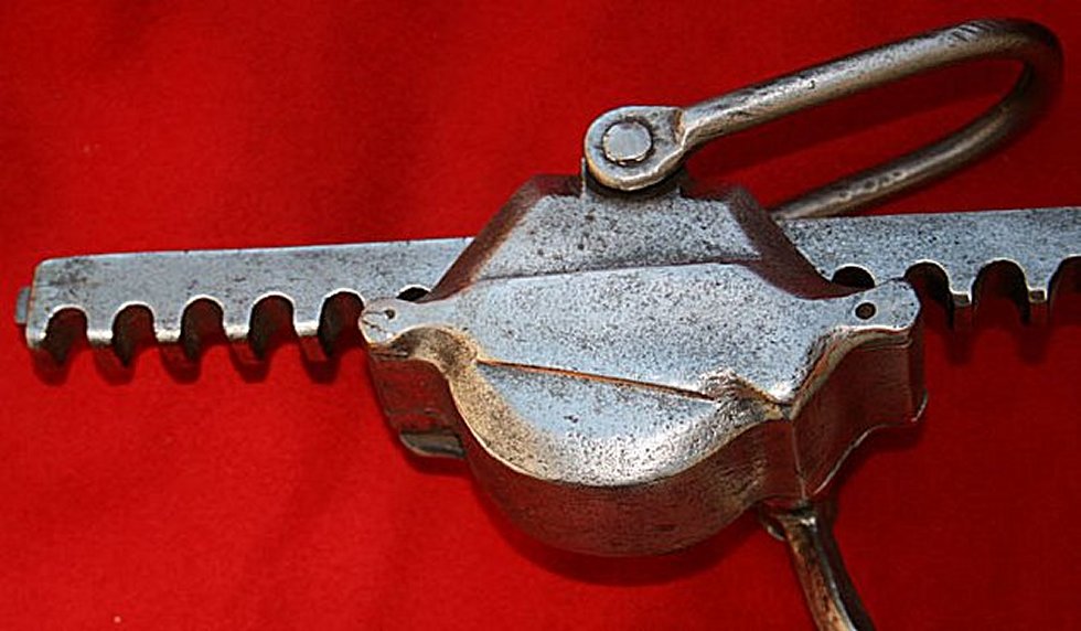

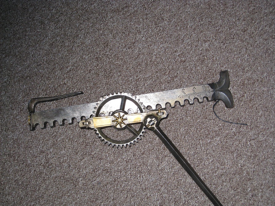

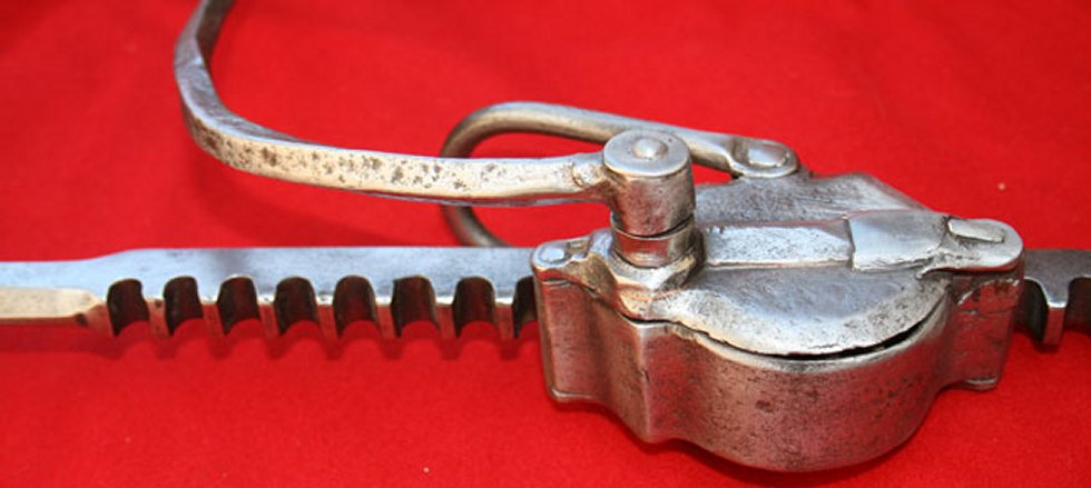

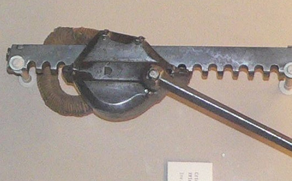

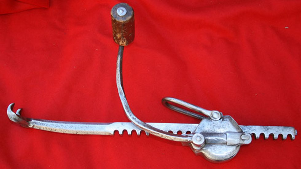

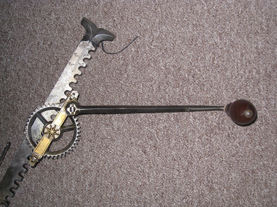

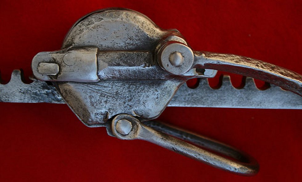

This is the by far earliest known dated but composite cranequin: 1474 and a Gothic trefoil decoration (three punch marks) on the ratched bar, which is doubtlessly the earliest part of the cranequin. The date is struck in correct Late Gothic cyphers, and the lichen-like patina seems absolutely correct to me.
The short length of the bar (without the belt hook) of only about 34 cm is also a Late Gothic phenomenon, and so is the shape of the claws. The gear box seems to be a primitive 17th c. addition when this cranequin was possibly re-used onsome farm or so. The long and straight iron handle also shows Gothic style elements and might well have originally belonged.
It was sold for about 600 euro at a Danish auction house in November 2010, maybe not exactly the real deal for an advanced collector because of the crude alteration.

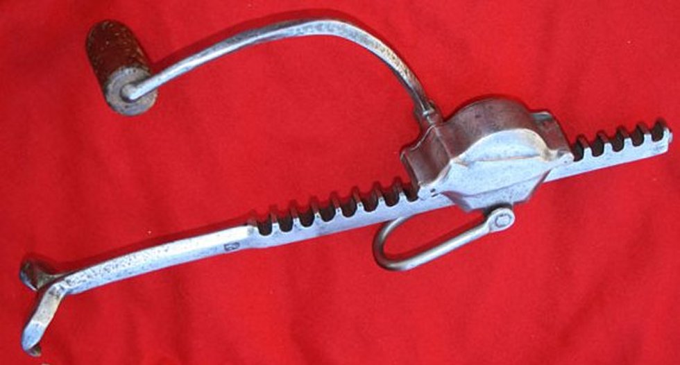

Old 10th February 2012, 04:36 PM   #79
Matchlock
Matchlock's Avatar
Join Date: Sep 2008
Posts: 4,310

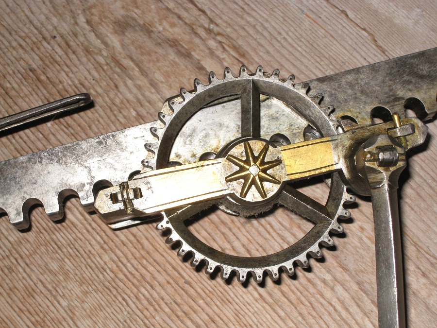

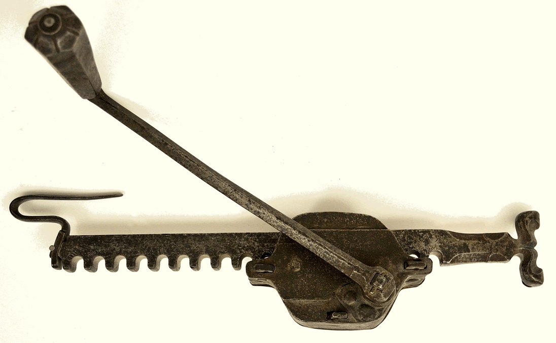

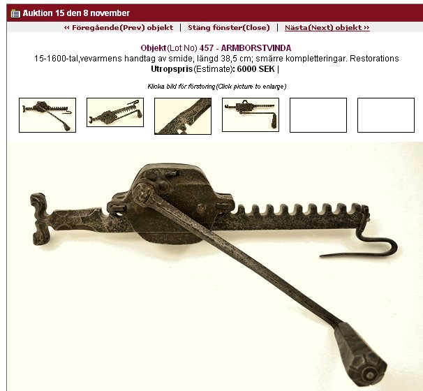

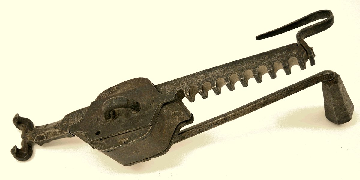

Default A Late Gothic Cranequin, ca. 1500

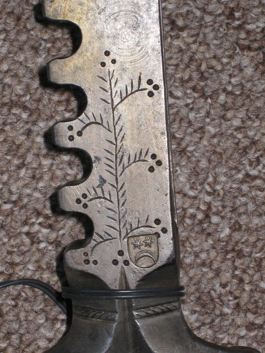

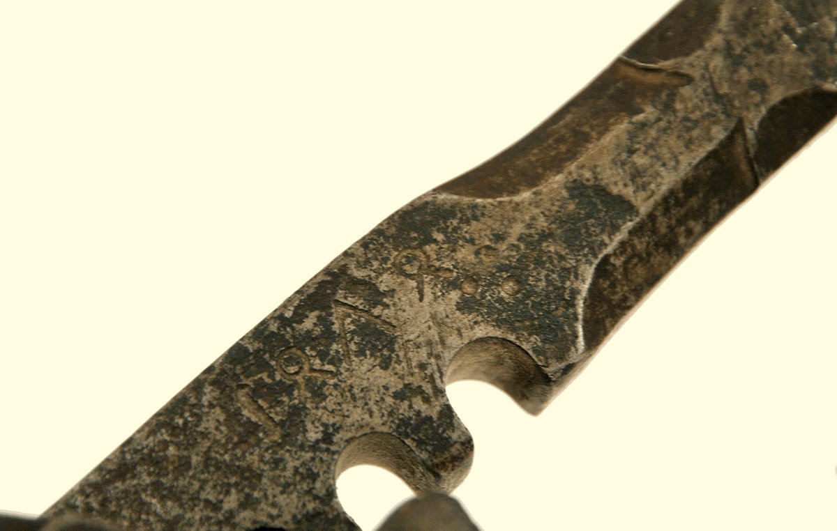

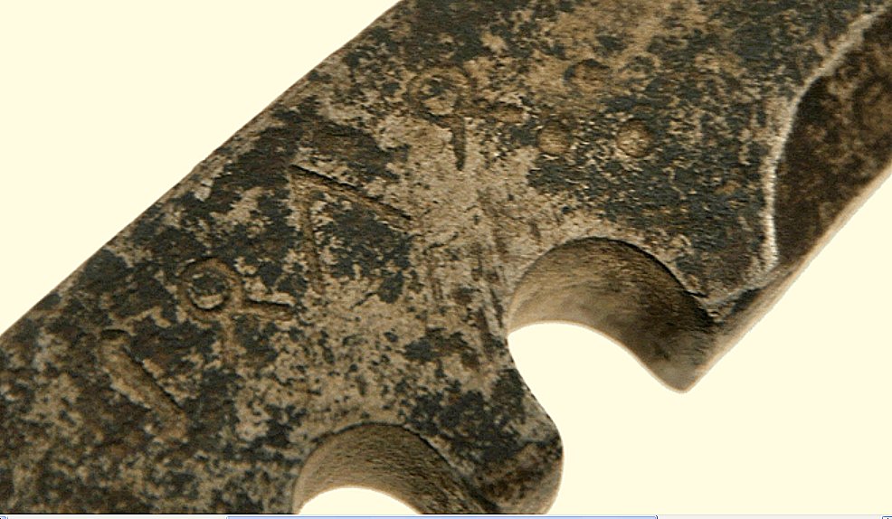

Overall length of the ratched bar 43 cm.
In poor, overcleaned and pitted condition throughout: the original lower cord loop for attaching to the crossbow inaptly replaced by an iron clamp, several rivets obviously replaced, as well as the original wooden crank arm handle.
The bar struck with a maker's mark, now indistinct as mostly polished off.
Old 11th February 2012, 02:02 PM   #80
Matchlock
Matchlock's Avatar
Join Date: Sep 2008
Posts: 4,310

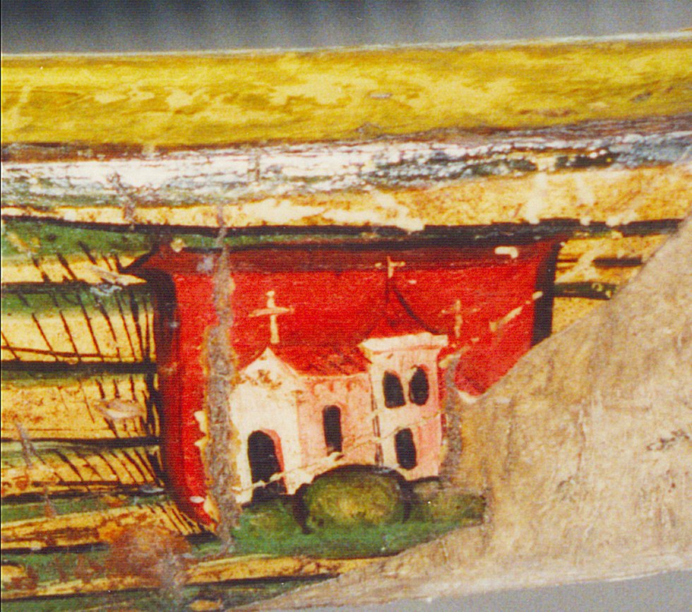

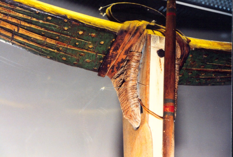

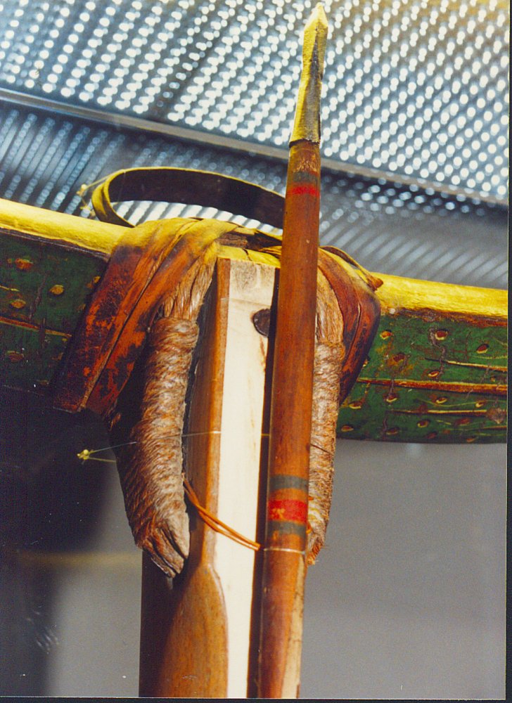

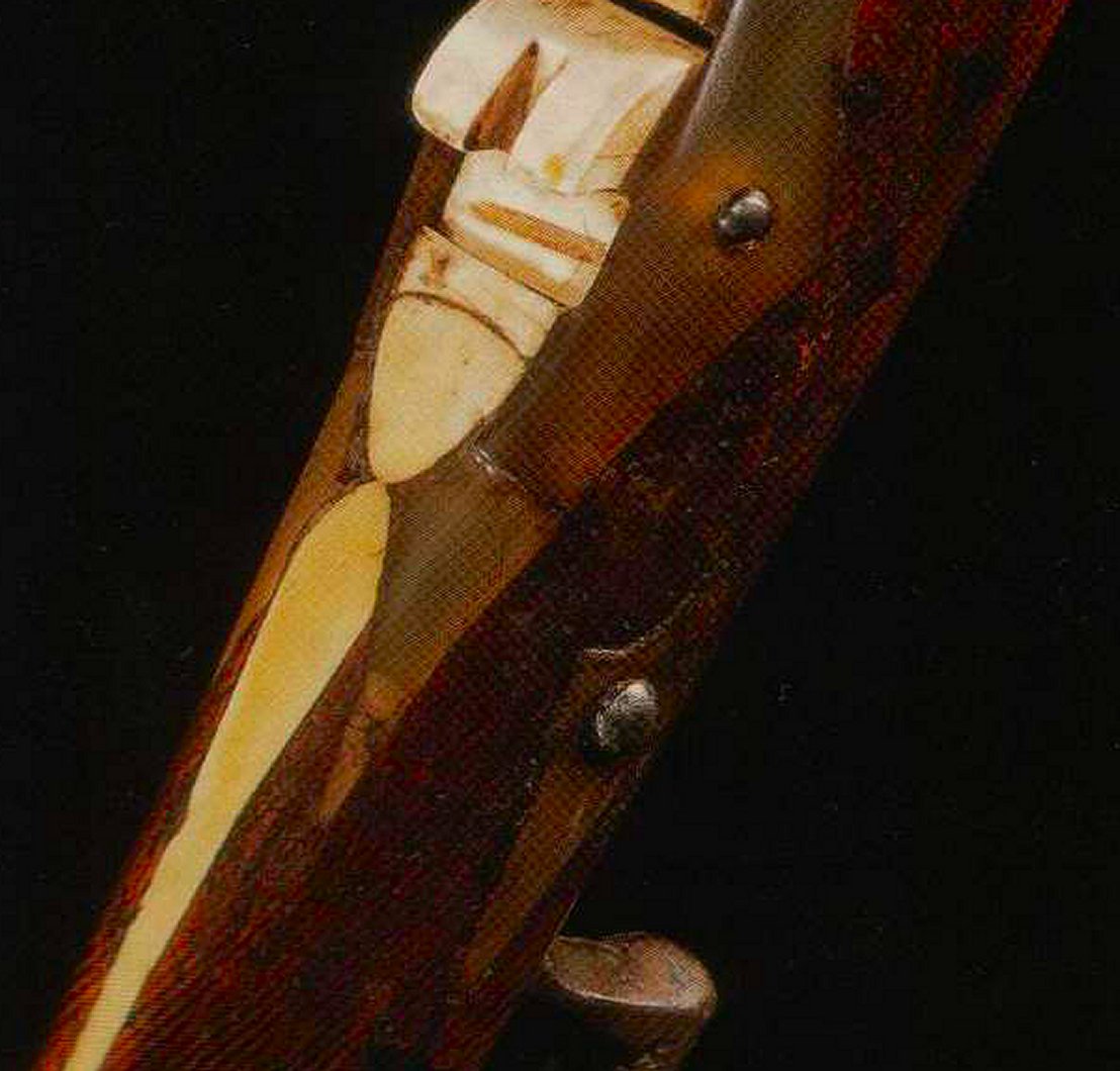

Default The famous Baumkircher Crossbow Preserved in the Vienna Imperial Armory
Author's photos, 1994.

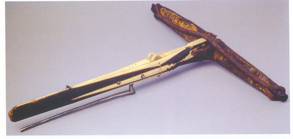

This Late Gothic crossbow, Vienna inv.no. A 108, ca. 1460-70, with painted composite horn bow is of unusual dimensions, denoting that its owner, knight Andreas Baumkircher, who was executed in 1471, was a man of enormous physique. His coat-of-arms, a church and a house, is painted on the underside of the bow against a read ground, amidst yellow rays against a green ground.
The second Late Gothic crossbow of about the same date is also preserved in Vienna, inv.no. A 464; the long trigger indicates that the rear of the tiller (now heavily wormed) was originally ca. 10-15 cm longer.
Last edited by fernando; 19th February 2012 at 02:02 PM. Reason: correction required by post author

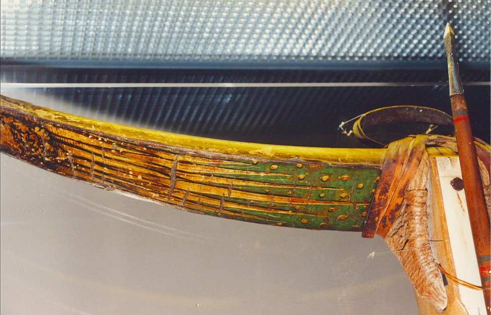

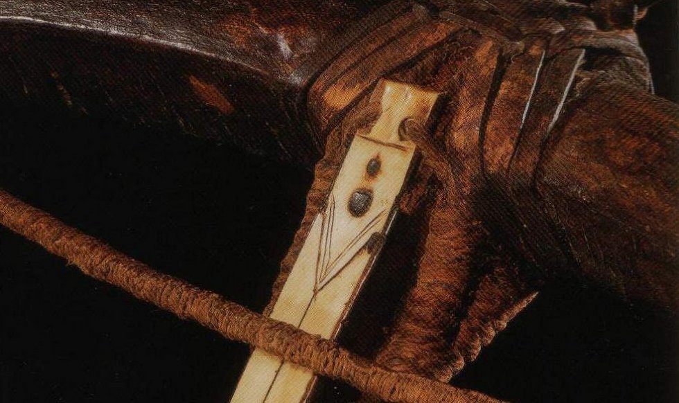

Old 11th February 2012, 02:05 PM   #81
Matchlock
Matchlock's Avatar
Join Date: Sep 2008
Posts: 4,310
One more photo of the Baumkircher crossbow, and the other Vienna crossbow. Please note that the latter is not yet equipped with the 'usual' lateral lugs for the cranequin loop but still features the earlier hook on top of the tiller for attacchin the spanning belt that was the predecessor of the cranequin. The earlest cranequins seem to turn up around the mid-15th c.

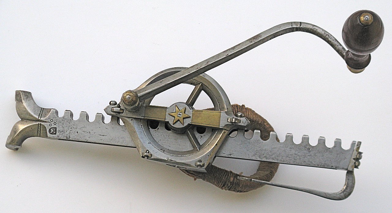

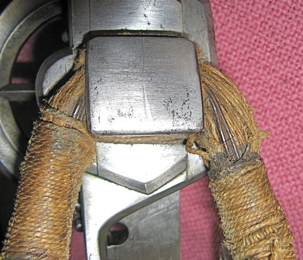

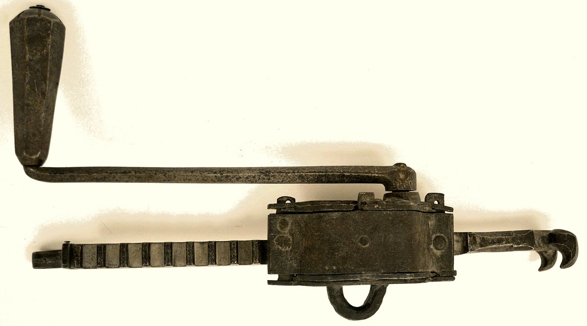

A very nice South German Early Renaissance cranequin, ca. 1540, preserved in completely original condition, wrought iron with brass applications. The maker's mark, a crescent and two pellets, is well known but cannot be attributed to an identified person. Brass applications in iron works - and weapons - are known to have been in use from ca. 1470-1550, and then again around 1700.
What is highly unusual with this cranequin is the the fact that the cord loop for attaching the spanning device to the lugs on the crossbow tiller is internally reinforced here with strands of iron wire. This remarkable feature becomes visible only thru a small damage of the loop.
German private collection.

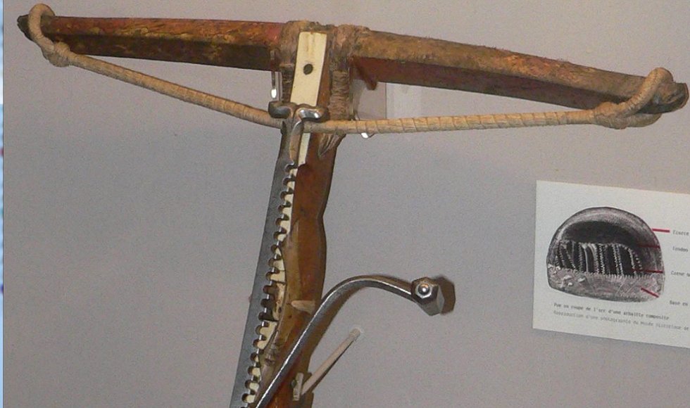

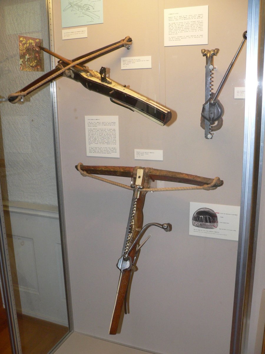

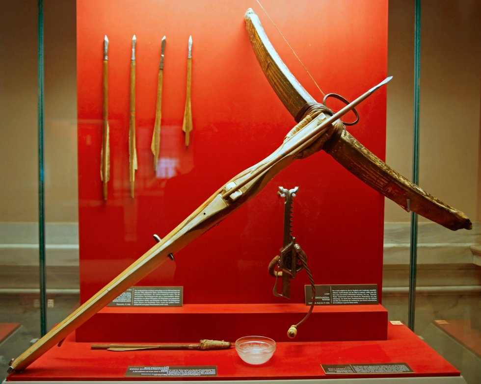

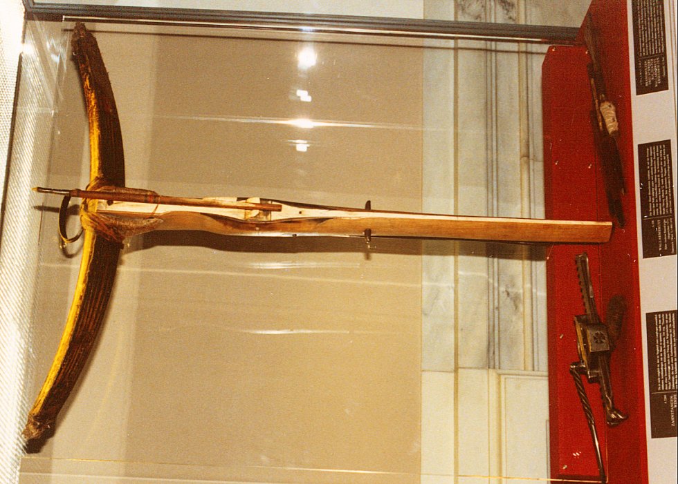

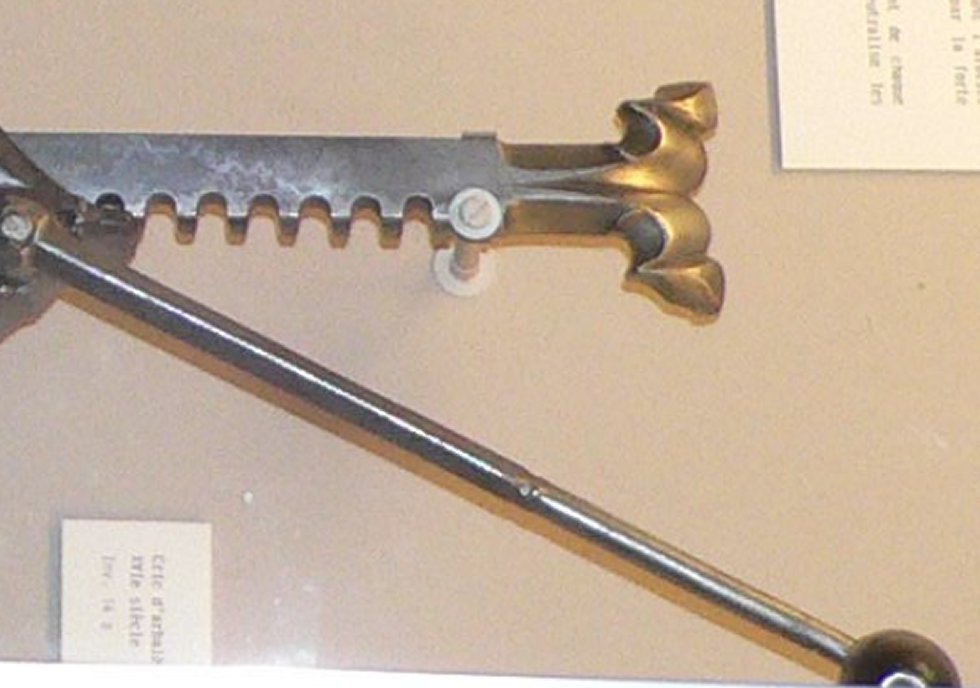

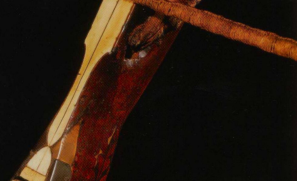

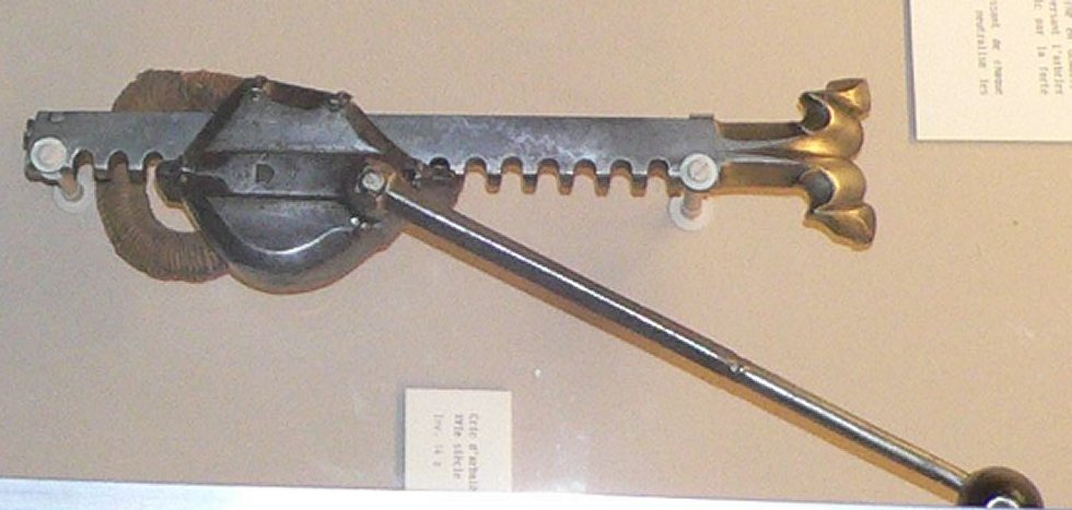

Default A Late Gothic Crossbow, ca. 1460-70, in the Museum of Morges, Switzerland
The cranequin mounted is about contemporary; the one displayed on the right is notably shorter and can be dated to ca. 1500, the belt hook is missing. The sporting crossbow seems to be German, ca. 1600-1650.
Please note the b/w illustration of a cross section of a Late Gothic composite horn bow. I posted such remarkable coss sections of horn bows preserved in the Swiss collections of Lucerne and Zürich here before.
Old 23rd February 2012, 04:04 PM   #87
Micke D
Join Date: Jan 2011
Posts: 41
And here is the sister to the cranequin that Michael posted.
It's located in Skokloster in Sweden.
It's from the same maker but it is a bit more stripped, not much of housing left.

Old 25th February 2012, 05:44 PM   #88
Matchlock
Matchlock's Avatar
Join Date: Sep 2008
Posts: 4,310
Default One of the Finest Late Gothic Crossbows in Existence, ca. 1480

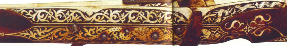

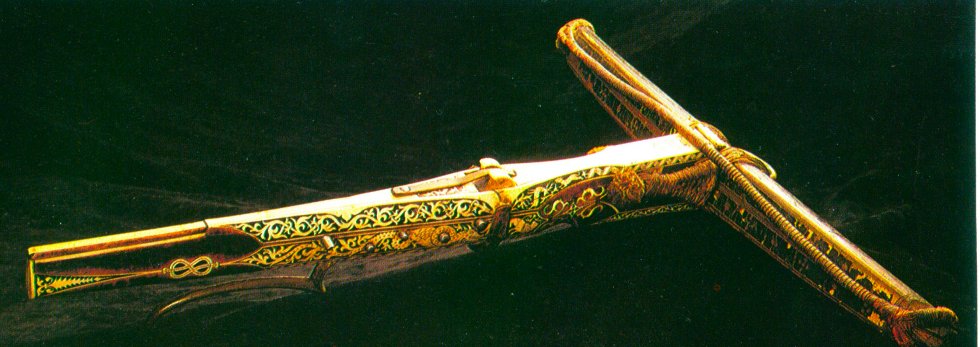

I was told that this one was preserved in The Royal Armouries Leeds but it was not on display when I was there, nor was is exhibited in The Tower of London.
Does anybody have a clue - Micke?
Old 25th February 2012, 06:58 PM   #89
Matchlock
Matchlock's Avatar
Join Date: Sep 2008
Posts: 4,310
I just found out it actually is in Leeds. Here is more of it.
In our opinion, this item should be definitely dated about a quarter of a century earlier than the RA believe it is.
m

I think that this one could be from 1480-1490 or something like that, based on the strange and probably early four-axle lock mechanism.
I have written a little article explaining my thoughts about how this one is related to two other 15th c crossbows.
This one wasn't displayed when I was at Leeds either, but the floor with the hunting stuff was closed for rebuilding/rearranging or something like that.
I don't know if it has been displayed in modern times at all? I guess there would be more photos of it if it has been shown.
