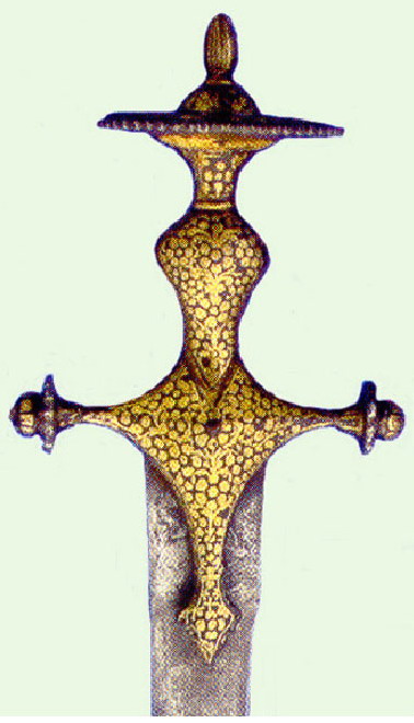

A farangi is described in two ways, either as a sword with a foreign blade and a khanda hilt, or like an (Indian) sword with a foreign blade – I think it should be understood that the sword has a khanda hilt, although it is not said, just like you see it on the pictures in Stone and other places. The word farangi has a broad meaning, but when it comes to the sword Henk shows I would prefer to call it a tulwar hilted sword with a straight foreign blade. In this way everyone will have an idea of what it looks like, even if they have not seen it. If you on the other hand call it a farangi everyone will think of a sword with a khanda hilt. Maybe you should also have a look in Tirri’s book page 331 figure 251, and while we are at it, what about the tulwar hilted maces, the hit would have been more like chopping than draw and cut, but maybe the hilt was bigger when they had a mace in the other end, rather than a blade.
The sword is unusual/interesting in more than one way. To see a rapier blade with a tulwar hilt is most unusual, when you to this add that where foreign blades were mostly used, most of the hilts had a hand guard, but this one does not. I also find the ‘bulb’ on the grip unusual, almost like the one in Tirri’s book page 328 figure 249C (the second from left), although the one on Henk’s sword is a bit more pointed. All this means that it could have come from within a very big area, as some things point in one direction, other in another direction. The fact that the spike has been sawn off is a puzzle to me, although I doubt that it can have been very long, not on such a hilt, it is likely to have been rather short and pointed.

I'm not at all debating the efficacy or even the function of the tulwar hilt. Once, I believed the quillion should be fingered, but someone (perhaps Ruel) disabused me of this with well-crafted argument to the contrary. I welcome such attempts.
My only real "problem" here is with the mounting of a straight thrusting blade on a handle which is not only not optimal for the thrust, but limits it significantly. Slashing, slicing, drawing, even hacking or "circular" (i.e. not linear) thrusting, with a tulwar hilt? Yes. Rapier work? No thanks.
BTW, that is really a beautiful sword, Rick. Congrats.
With regards to Henk's rapier blade I must admit to confusion also .
Possibly it is a case of necessity being the mother of invention i.e. here's a rapier blade in a foreign culture with a different style of swordsmanship so it got the traditional hilt and was used (effectively or not) for that different style .
Probably not a great marriage of cultures but still potentially lethal .

By turned up do you mean angled forward, or dished upwards at the edge? I've seen both, and either allows a greater freedom of wrist motion than the flat discs. In general, it is my feeling that tulwar hilts, and many other old hilts, were meant to cup the hand fairly tightly.

What I mean is, that the disc is often tilted, this would give the hand a bit more ‘freedom’ when needed. The khanda hilt has a bigger grip than the tulwar hilt, and the ‘disc’ is cup formed, not disc formed, both things will give more freeness to the movement of the hand.
