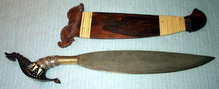

Now here is a picture of the scbbard after restoration. In this work, I cut and stained pieces of wood to match as best as possible the original wood. Some pieces, I had to recarve the design decoration to match that nearest the toe at the bottom and the "wing" at the top left hand to match the lines as best as possible. After all of the piecing and gluing, I wrapped rattan top and bottom. Perfect? - No, but better than the gaping holes that were there (whole chunks missing).
The only thing I did to the pommel is replace a small dot of ivory.

Thank you Battara for sharing your pictures.
Nice job on the scabbard. Very nice Jungayan barung.

Your welcome. I am pleased with my barong. I had to pay money and trade my clothes (well, not off my back, some PI textiles), and trade a lesser barong and a 1950 Scottish sgian dubh. But it was worth it in the end.

Spunger, your barong turned out nice! Good job!
Battara, do you have to post pics of that barong of yours? I always get green with envy every time I see it !!! That's has got to be one the most detailed hilts I've seen on a barong! You made out well in end...it was WELL worth it !
