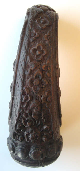

Old 23rd February 2008, 12:40 PM   #34
Alam Shah
Alam Shah's Avatar
Join Date: Jan 2005
Location: Singapore
Posts: 1,248

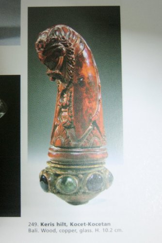

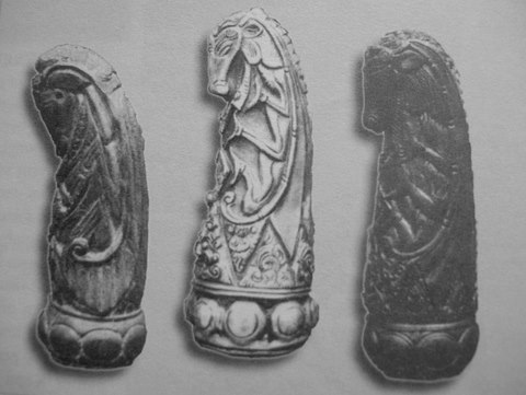

Hi all,
Looking into Ensiklopedi Keris (see picture attached, from pg. 250). For some hilts, the head does look like a horse. The texts explained that it's a horse head.
Based on examples posted here, there seems to be those that looks like horse head and some that's clear cut a bug-like head.
Could there a hilt transformation, from the bug-like head into into a horse head?
Or could it be, the case where later craftsman, carved hilts without knowledge of the symbolism attached?
Or is there two hilt forms with different head type, a bug and a horse?
Btw, there is a famous keris with a kocet-kocetan hilt, Keris Ki Puspa Wijaya. (see Pusaka Keris, Vol 07-08/2007, pg.61).

Here's another kocet-kocetan hilt from Zonneveld's, Traditional weapons of the Indonesian Archipelago, Pg. 67. The head is also horse-like.

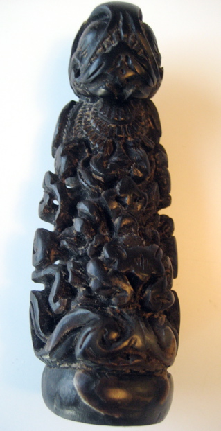

Here is maybe a cousin from Madura (next to a regular K-K)?
Does anyone know what kind of bug it is and if there is any symbolic relationship?
It looks a bit like the no 2 in Nieuwenkamp?

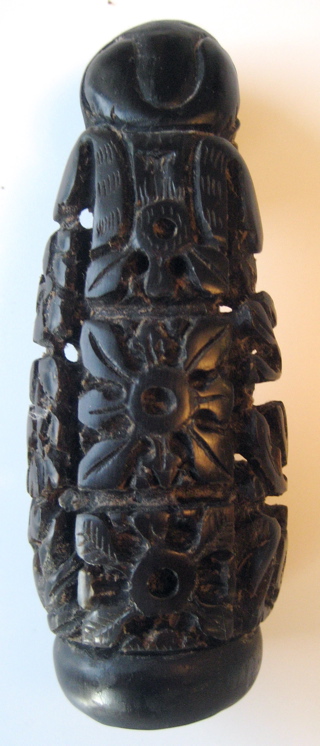

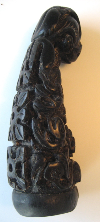

Posts: 991

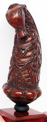

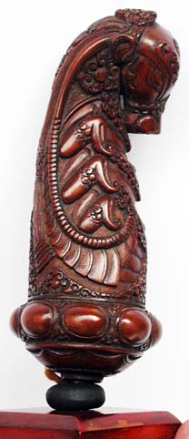

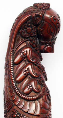

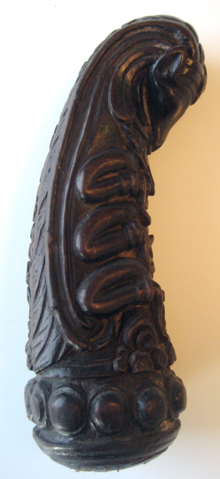

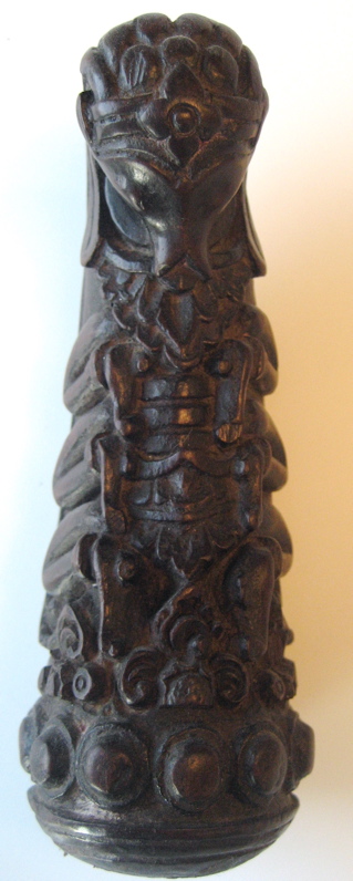

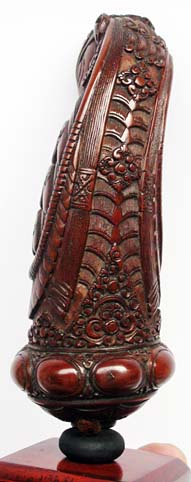

Default KUSIA HILT
Dear Michael, Shahrial and All,
This is just more example on kusia hilt, or kocet-kocetan. I bought this hilt from a senior collector in Jakarta last week. Hopefully, it will be useful to you all...
GANJAWULUNG (Jakarta, June 1, 2008)
Old 1st June 2008, 02:30 PM   #38
Posts: 6,438
What is the hilt material Ganjawulung ?
It looks like Cinnabar; is it ?
Very nice acquisition .
Old 1st June 2008, 03:59 PM   #39
ganjawulung
ganjawulung's Avatar
Join Date: May 2007
Location: J a k a r t a
Posts: 991
Dear Rick,
It is pure wooden hilts, with good (old) finishing. Looks like Cinnabar (red mercury sulfide, HgS), but really it is made of wood. Maybe a kind of "tayuman" (?) or "tri kanchu" wood.
I got other hilts too from this senior collector, pattani hilts (tajong hilts) and maybe kelantan hilts too. Later I'll post in other thread.
Old 1st June 2008, 08:48 PM   #40
Posts: 7,300
Beautiful example Ganja, thank you.
Old 1st June 2008, 08:57 PM   #41
VVV
VVV's Avatar
Posts: 1,637
Very nice hilt Ganja!
I look forward to see the other hilts you acquired from this collection.

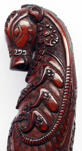

Old 2nd June 2008, 06:37 AM   #42
Alam Shah
Alam Shah's Avatar
Join Date: Jan 2005
Location: Singapore
Posts: 1,248
Thank you Pak Jimmy for sharing the beautiful hilt.
This head is a 'horse-form' for this one.

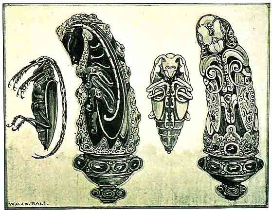

So to recap...
What is the kocet-kocetan hilt?
It's a Balinese hilt form that was inspired by the beetle, (Batara Karpa).
Where does it originate from?
It's originated from Bali and specifically used there.
When the name:"kocetkocetan" rise for the first time?
in W.O.J. Nieuwenkamp; First European Artist in BALI (1997):52
The picture itself is from 1907
in Jasper & Pirngadie's classic book De inlandsche kunstnijverheid in Nederlandsch Indie from 1912 is "kotjčt-kotjčttan" mentioned (fig. 325).
What are its meaning and symbolism behind this hilt form?
The pupa, pupa-like position or yoga/meditation symbolizes fertility, eternity, immortality... (?) ... unsure about this one...
Another question: Why a beetle?

Just to put in another bit of information, Karsten Sejr Jensen in his Kris disc (chapter 7 pge 10) mentions this about the Kocet-Kocetan hilt form
A very special hilt is the so called Kocet-Kocetan hilt, which represents the capricorn beetle or mantis religiosa. Martin Kerner thinks that this particular beetle was the totem animal of the Brahmans. According to mythology the beetle is said to be their ancestor for which reason it is reserved them alone to wear krisses with this hilt19. It is possible that this is the case, but the hilt is mainly found in South Bali, so it is more likely that it is connected with the principalities there, being their special hilt
I dont think it is a praying mantis (mantis religiosa) but the Capricorn beetles are members of the cerambycidae family that Fearn mentioned

Old thread, resurrected because I am researching the Kocet-Kocetan hilts since I bought 2.
In this catalogue by a terminated auction we read :
https://zeeuwsveilinghuis.nl/blog/ru...nese-dancer-2/
"...Although many ‘experts’ have claimed this special type of handle to represent a mythological horse or eagle (Garuda), W.O.J. Nieuwenkamp (1874-1950) proved –already in 1905!- that we are dealing with a stylized six-legged longhorn beetle (Batocera hector). In Balinese, it is referred to as Kocet Kocetan, derived from the penetrating sound it makes (1). It is said that this insect represents one of the Primordial Animals, Batara Karpa, a beetle whose mother was Dewi Winata, a bird-demon, who was married to Rishi Kasyapa, a tortoise. Three other animal gods were born from this marriage: Batara Garuda, the eagle, Batara Agniya, the marten, and Batara Kowara, the snake. Batara Karpa, or
Kusia, is closely linked to one of the three main gods (Trimurti), Brahma, which in turn implicates that keris with a kocet kocetan handle are only allowed to be worn by Brahmans. Similar to a caterpillar changing into a butterfly, the kocet kocetan is also said to symbolize a youth on the verge of becoming an adult or undergoing an evolution in profession or status ...."
Last edited by milandro; 10th March 2023 at 11:17 AM. Reason: removing capitals from the species name
milandro is offline   Reply With Quote
Old 10th March 2023, 10:51 AM   #48
Hello André,
Yes, this hilt type clearly represents the pupa of longhorn beetles. That is the reason why the third pair of legs is partially covered by the (future) wing, at least if carved by someone who knows what he's doing. (BTW, are there any female carvers nowadays or is it still considered a pure male profession/past time?)
Beetles are holometabolic insects which pass through a distinct pupa stage (as butterflies, etc.) even if the metamorphosis is a bit less striking since beetle pupae already exhibit body and appendages similar to adults (cp. the Nieuwenkamp drawing: both hilts resemble the pupa while the adult beetle on the left is different; one has to concede that the carvers exhibit varying talent/knowledge though, especially nowadays we see all sorts of monster versions).
This life stage concept was already alluded to in this discussion and (aside from the Hindu creation narrative) is a really interesting aspect of this hilt type's symbolism, I believe.

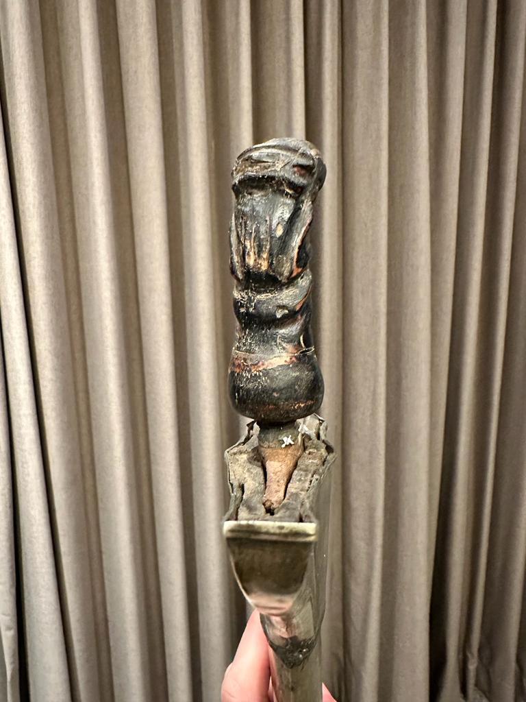

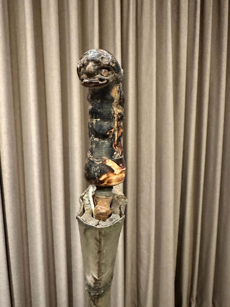

Old 11th March 2023, 03:29 AM   #49
Wijaya34
Join Date: Jan 2022

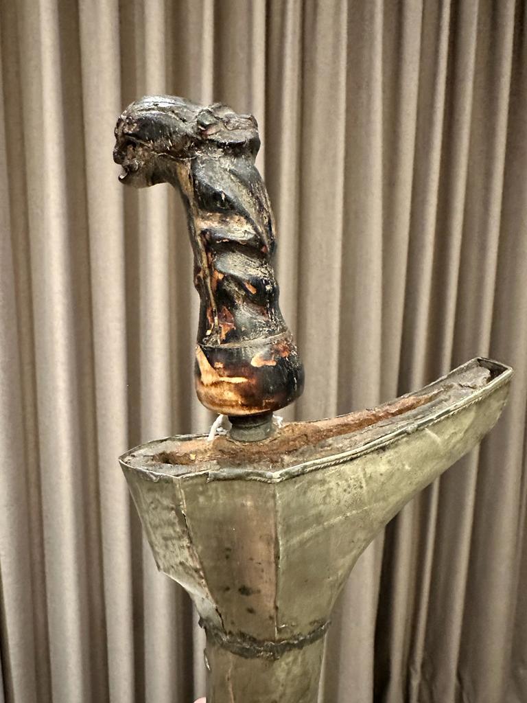

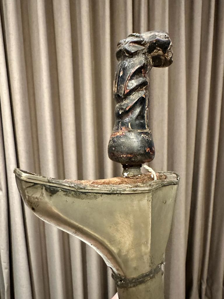

Posts: 15
An old (Ivory?) Kocet-Kocetan hilt for sharing, it was found intact with a Jalak Budha keris.
Wijaya34 is offline   Reply With Quote
Old 11th March 2023, 06:02 PM   #50
Thanks for posting this special hilt, Wijaya!
To me, this looks like an ancestor figural hilt (squatting posture with arms on both sides). Maybe Sumbawa?
Old 11th March 2023, 06:15 PM   #51
milandro
Join Date: Jan 2022
Location: Netherlands
Posts: 500
I can see a squatting figure but I don't think I can recognise the typical features of a Kocet-Kocetan (at least not the ones that I know as such)
Old 11th March 2023, 06:37 PM   #52
Yes, quite surely not from Bali, I believe.
Old 11th March 2023, 10:44 PM   #53
Posts: 7,300
I'm afraid i'm with Milandro and Kai on this one. More likely an ancestor figure. I don't see any indication it could be an example of a kocet-kocetan hilt and i doubt it is even Balinese.
Doesn't look like ivory either, but better photos might reveal more.

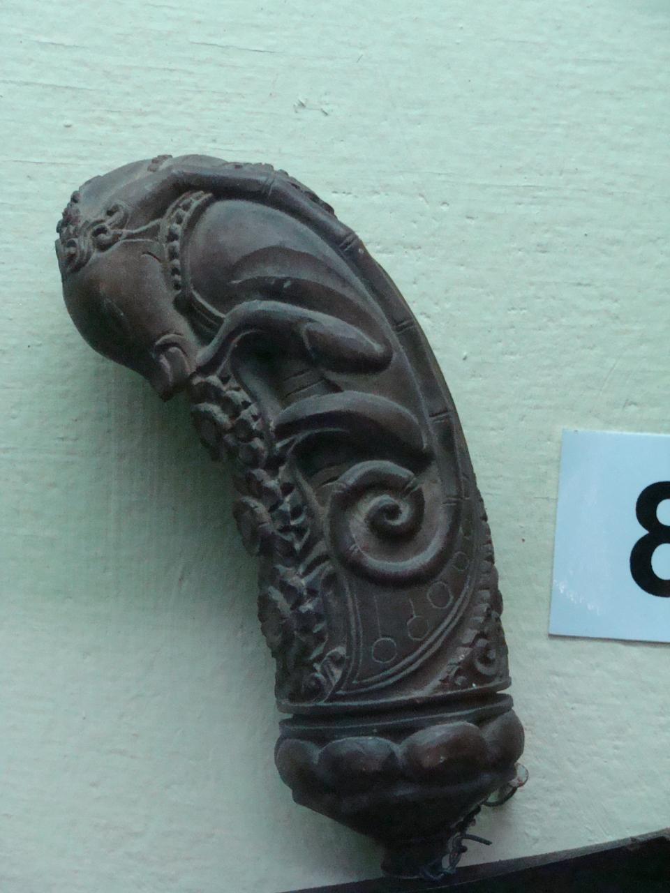

Old 11th March 2023, 11:19 PM   #54
Gavin Nugent
Gavin Nugent's Avatar
From a 2010 trip to Bali.
Old 12th March 2023, 01:25 AM   #55
Wijaya34
Join Date: Jan 2022
Posts: 15
Hi everyone, the hilt was recently excavated in the new Kediri airport a few months ago, so It's likely not from Sumbawa or Bali. I was thinking that it might be some kind of prototypical Kocet-Kocetan hilt before it evolved into it's current form.
Old 17th March 2023, 04:04 PM   #56
milandro
Join Date: Jan 2022
Posts: 500
Hi everyone, the hilt was recently excavated in the new Kediri airport a few months ago, so It's likely not from Sumbawa or Bali. I was thinking that it might be some kind of prototypical Kocet-Kocetan hilt before it evolved into its current form.
It is really unlikely that this was a Kocet-Kocetan shape and in fact it is possible that it is the reverse which means that the Kocet-Kocetan evolved in other forms rather than other forms evolved into a Kocet-Kocetan

Old 17th March 2023, 07:37 PM   #58
Thanks for the details, pak Wijaya!
Do you have more pics, please?
So, the whole ensemble is as excavated? (Not including the old scabbard, I guess?)
Old 17th March 2023, 08:27 PM   #59
Posts: 7,232
I cannot see any trace of the Kocet-Kocetan/Kusia form in the hilt shown in post #34, to me it looks like a humanoid form, perhaps generic ancestor figure.
