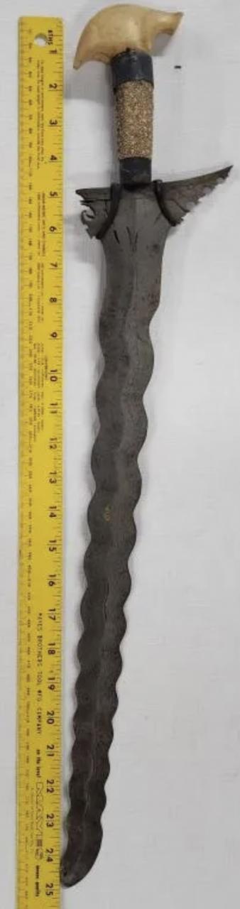

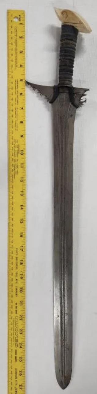

I'm curious about the length of the large sundang. Also would like your cleaning superpowers.
Pic from the auction.

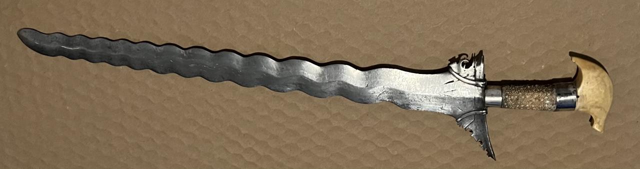

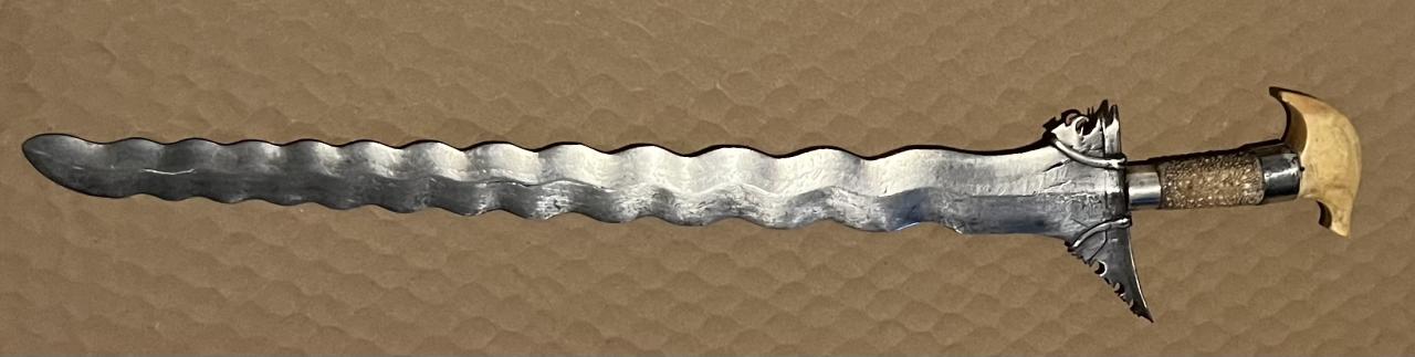

Old 8th March 2023, 06:03 AM   #32
SanibelSwassa
Join Date: Mar 2020
Location: Sanibel Florida
Posts: 104

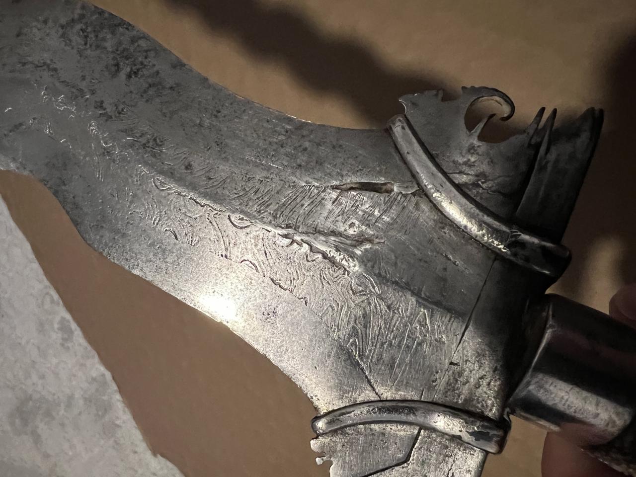

Clean up #4
Will need to work on the blade a little more and do a better etch but good enough for the 1st pass.
Enjoy!!

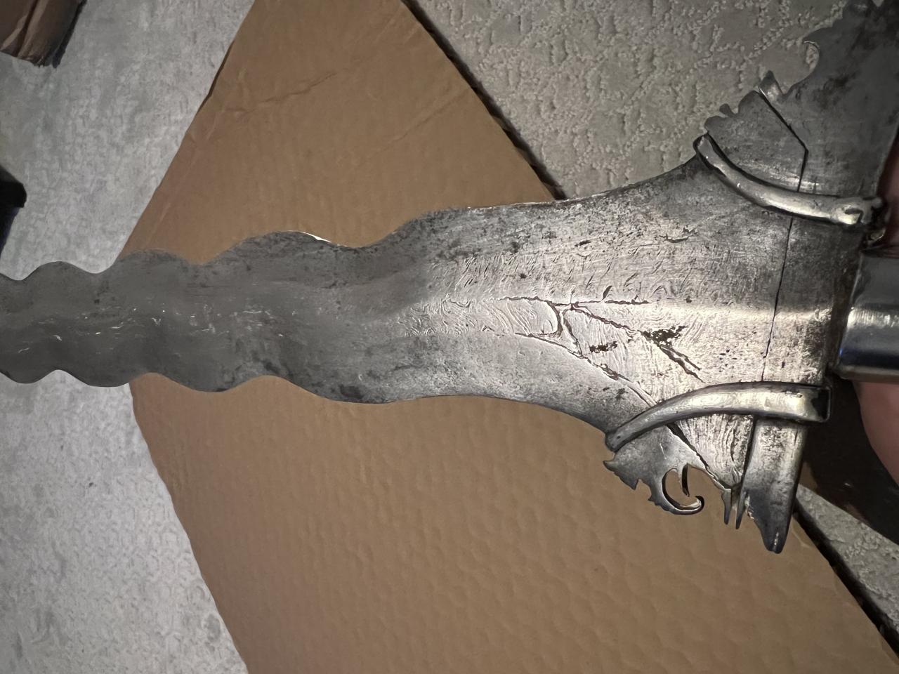

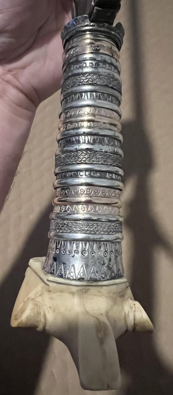

Originally Posted by Gavin Nugent View Post
That's what I thought.
The closest I've seen to that motif in swassa is arrangements of 3 half moons to make the triangle shape, not yet the V shape with circle in the center...

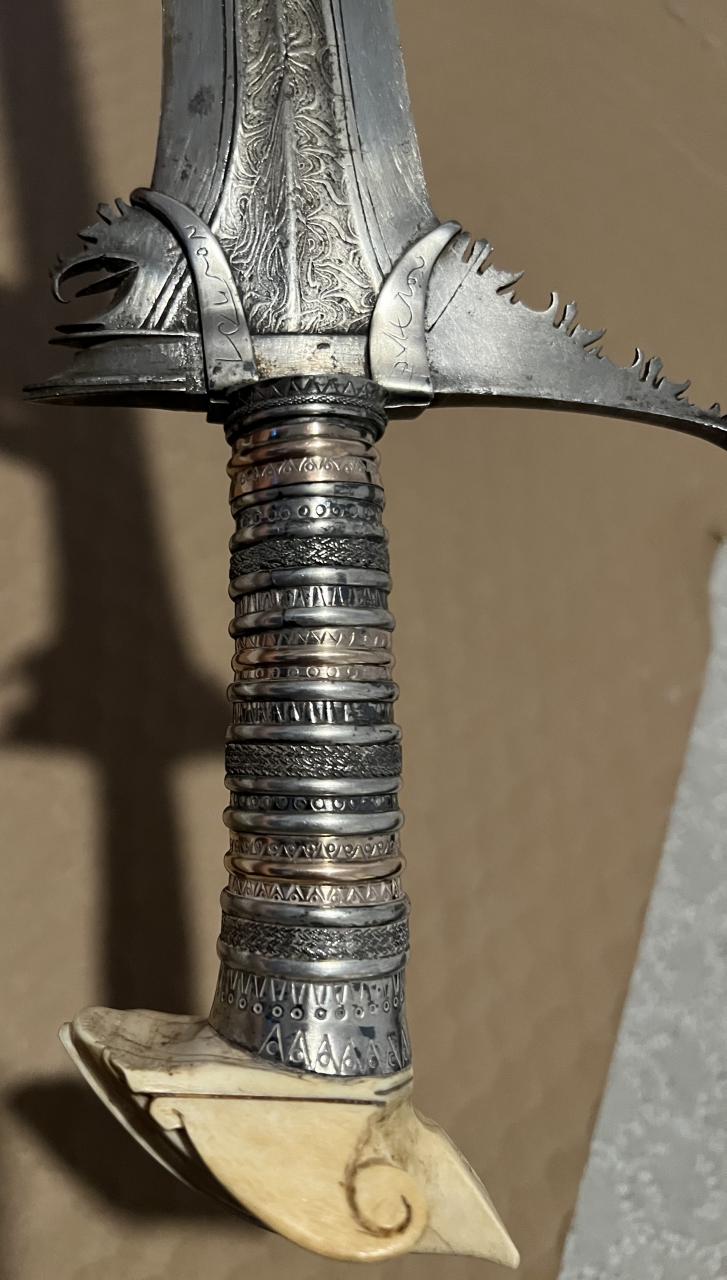

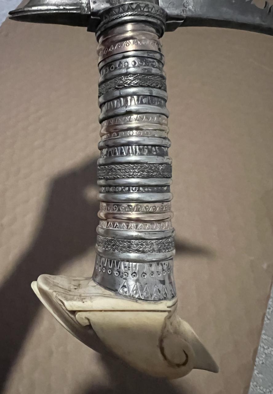

Closeups of the hilt and motif.

Posts: 7,412
I wonder if the rings are in Bagobo style and Bagobo made. Mixes like this are not unheard of. Or this is a form of Sulu okir. Maranao usually don't use this form as much. Maguindanao use this with other ingredients. This after thinking about it some more.
BTW - the way the silver wire bands are made, they could be Sulu or Maguindanao.
