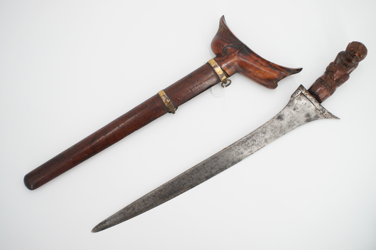

And after seeing the pic of the whole blade, I agree that it is probably from South Sumatra.

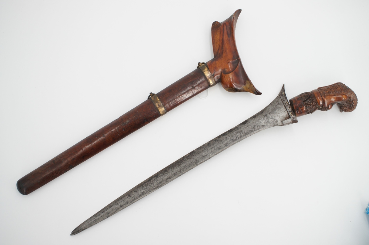

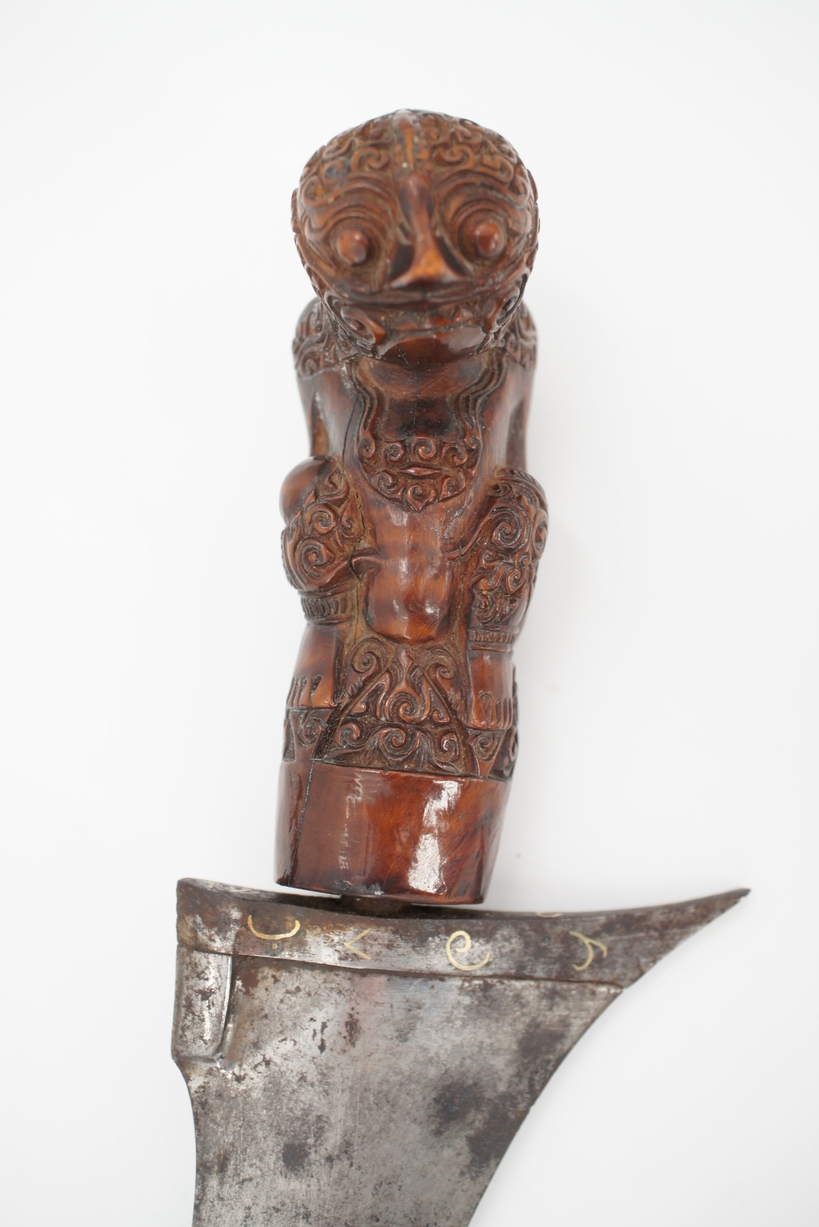

There was another Keris auctioned last week, with some corresponding features - generally the same style sheath, talismanic inlays on Gonjo of similar kind.
A Yaksha/Rakshasa hilt with some unusual/individual features.
The interesting thing about it - it was brought to England by James Alms (1728 - 1791), officer of the Royal Navy, possibly at latest 1784.

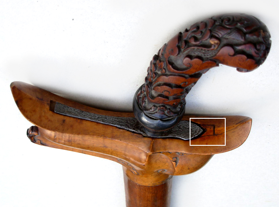

Referring to the initial post of that nice Palembang kris I noticed the adapted slot opening. Seems to have contained quite a square model.
Paul B. is offline   Reply With Quote
Old 31st July 2019, 09:36 PM   #40
Gustav
Join Date: Jun 2009
Posts: 1,319
That is just an inlay, about 4 mm thick. Under it the wrongko exactly fits Gandhik.
Similar inlay, of the same thickness, missing on Kepet side.
Just a cosmetic repair, done long time ago.
