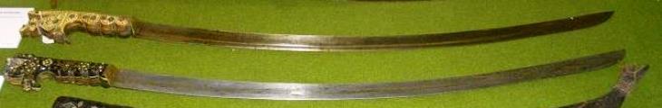

Though fuzzy the label does indeed seem to state that the sword is from Morocco with an English blade, which is the first actual evidence we have that these may be from Africa. The decoration does not look Moroccan. Maybe we can compare these to Mauritanian daggers for better comparison in decoration, assuming these are from Southern Morocco/Western Sahara.
Old 22nd January 2019, 09:10 PM   #32
Posts: 10,865
While Kubur is right, there were indeed early commercial contacts with England, and I have seen Moroccan sa'if s with ANDREA FERARA blades and we have seen later blades by MOLE deeper into the interior.
However as Teodor has noted, the motif and design of hits (the determinate factor as blades were diffused all over) is indeed 'Spanish' and not Moroccan. What is intriguing is the familiar hand 'nock' as seen on Moroccan sa'if.
My thoughts are that these forms, 'Berber' and guanabacoa (Cubano etc) are best regarded as 'Spanish Main' forms (thus Spanish colonial), and hilted in shops in these ports and entrepots in Central to South America as well as Cuba. .....which traveled as far as Philippines (as per findings in past discussions).
As I have mentioned, my example has a distinctly English blade (M1796 light cavalry) as I have an original M1796 and put together, the blades are an exact match (as Wayne showed in earlier discussion). Mine has been reprofiled but the fullers match exactly.
My example of the Brazilian espada with striated shell guard (as previously noted) has a British blade by Isaac & Co. (marked on blade back as with British convention in 19th c.).
My 'Berber' is also marked with MANUE(L) at the forte transversely as seen on other blades in these sabres with M1796 blades. Some can be read as MANUEL DE ……..rest obscured. This does NOT mean Morocco, but clearly an importer in the Spanish colonies in either Cuba or some other entrepot in these regions of Spanish colonization.
There were MANY surplus British M1796 blades in Spain after the Peninsular campaigns, and as well known many British blades were coming into both Portugal and Spain. As these campaigns ended, new patterns of sword were being developed in England for cavalry, so these stores of 'surplus' were either left, or sold off as required.
So YES...….plenty of British blades were out there, but I think these which came to Morocco were already mounted in Spanish hilts.
With other areas of the Sahara, it was much the same from Mali to Algeria and parts of Morocco to the French...….these French blades were common on many West African and Saharan swords. The troops cavalierly traded them off much as these Spanish troops in Moroccan regions did.
There is no doubt that many of these forms were 'found' in North African contexts, particularly Spanish Morocco...……..but the idea they were 'produced' there I do not agree with. I recall when I first began researching these about 21 yrs ago, and working with Pierce Chamberlain ("Spanish Military Weapons in Colonial America" 1972) he admitted he had no idea on these forms, but over time contacted other sources. It was then that he wrote me when finding many of these in Cuban context. I had found the 'Berber' forms in Mexican collections, and we even found examples with clear Philippine or Indonesian mofif. Some of these had Filipino inscriptions from insurrection events there.
Yes precisely Sahara occidental, the Spanish part
and the sword that i posted yesterday is decorated like the Mukhala from the Agadir region...

You clearly know Morocco well, and Western Sahara certainly did receive its share of the Spanish arms and blades we are talking about. It very likely was an entrepot in which these blades might have been produced (hilted) with the local 'embellishments'. This one seems beautifully done in silver with that red stone (I dare not guess what it is) and a well done copy of these 'Cuban' swords. It does seem that often in such places, such 'other ranks' swords and otherwise 'common' swords were sometimes commissioned from artisans for ceremonial wear.
Such 'upgraded' weapons fashioned in 'the manner of' the arms well known were often commissioned it seems in this way by either officers or perhaps dignitaries and possibly in diplomatic cases. Such instances are evident in Egypt during the Condominium, Aden in Arabia, various stations in India etc.
The one you posted is surely an anomaly and I can only guess (as above) at the circumstances. Whatever the case, it sure makes the one I have and most I have seen pretty much 'ugly ducklings'!!

Hi Jim, thank you for your kind words as always.
I do not think that is an anomaly, I've seen other swords from collectors and for sure from Morocco...
Now again I'm fully convinced by the other members, Fernando, Teodor and you that they are Spanish "colonial" swords "tropical machetes". But on their way to America it seems that they have been adopted in Morocco.
I think that you have a good point by saying that it's post Buttin collection.
But even if Buttin was a specialist of Morocco he didn't have a full range of North African swords, for example no Tunisian Berber sword...

So now the Montjuic examples have been confirmed to be Dominican as well. Personally, based on the factual evidence we have, for me these swords are Dominican. Others can make their own conclusions, my goal is to find what I believe is true for myself, not convince anyone in anything.
Kubur,
I see a nice silver hilted machete with a red stone. I am not sure I see clear parallels with North African rifle decoration, but am willing to look at a side by side comparison. Complex decorative motives are usually a better indicator than material used, and I do not see any particular decorative motif that can provide a good clue as to where the silver decoration was applied.
Teodor
