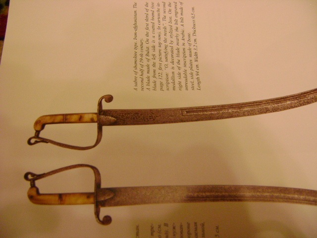

First, hilts of that construction were used on just garden variety Afghani shamshirs. Here is one, coming from a new Russian books titled " Shamshirs", exact age unknown, but the author attributes it to the second half of the 19th century. I cannot argue: seems plausible.

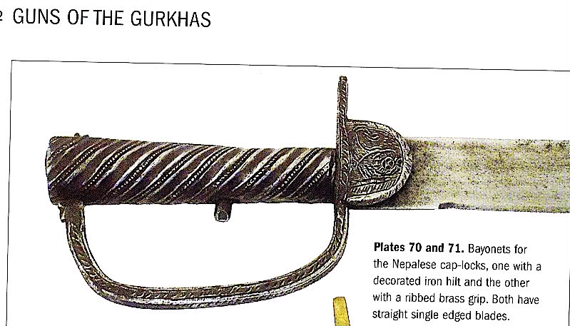

And last, British-produced bayonet for the Nepali units, 1876 pattern. Pay attention to the D-guard and to the "shield" extending from the quillon over the ricasso. Doesn't it remind you the "afghani" handle?
Overall, my guess is that the so-called "regulation pattern" handles of some Afghani weapons were created by the British for the native troops. They date from the 1850s and were later copied by the Afghani Mashin Khana (sorry: Kaar Khaana e Jangalak :-))

Ariel, as I wrote in Russian forum, a saber from a book about Shamshir likely remounted to the new hilt in the late 19th century.
Sword the link that I exhibited at the Russian forum - so far the only known. One items - an artifact that can only be a subject for speculation. But can not be used for serious theory.

Old 11th September 2013, 01:39 AM   #38
To me the Nepali hilts look more like 18th century English hanger hilts with langet. The production of such components for use by units in British occupied regions is however supportive of the concept establishef of thier supply to such regions.
Jim,
All true and carefully considered, as usual.
The Nepali bayonet saw service in the British Army since 1830s: Brunswick rifle, the same one that was given by the Brits to the Nepali troops later on. No doubt there is a lot of local embellishments, and the "lion rampant" on the semicircular langet may be either Nepalese or British. The animal-like head of the D-guard next to the base of the bayonet looks "local" to me. There were many examples of European weapons of a similar construction, but we are talking about a British-dominated area; more than likely it imitated a genuinely British pattern.
The presense of a similar hilt on a sword of Daoud Shah in 1879 shows convincingly that similar handles were present in Afghanistan long before the Mashin Khana. Thus, unless we demonstrate the spuriosness of the Enfield markings, its pattern fits with the Daoud Shah's example.
The only thing I wanted to point out, is that the "regulation pattern" handle of the 1880s-1890s did not spring forth as a sudden invention of the local weapon industry: it was there in one form or another for quite some time and was likely introduced to the area by the British. It mutated into several final forms depending on the locality and timing.

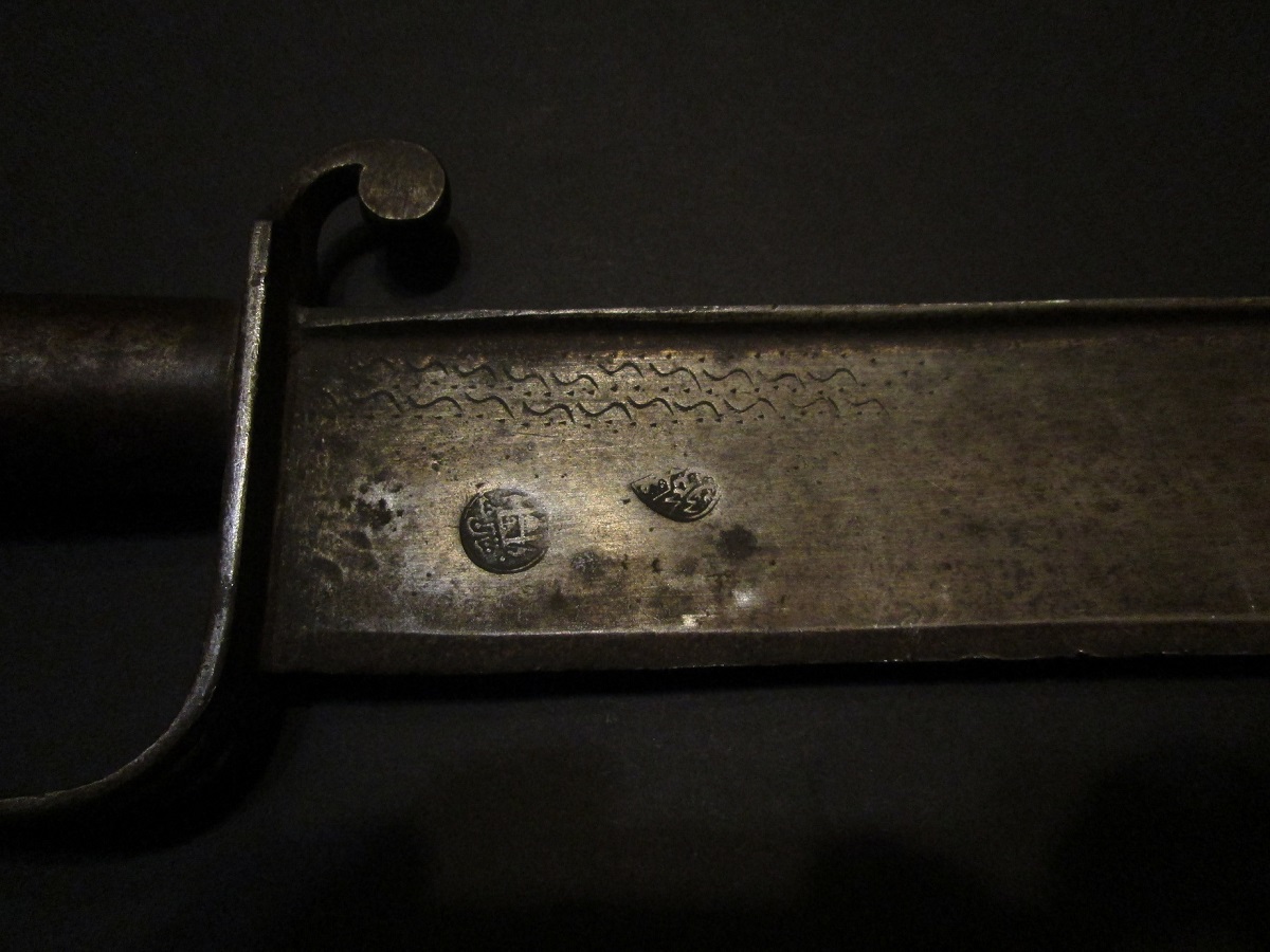

Great thread Mahratt! The Afghans certainly loved copying weapons!

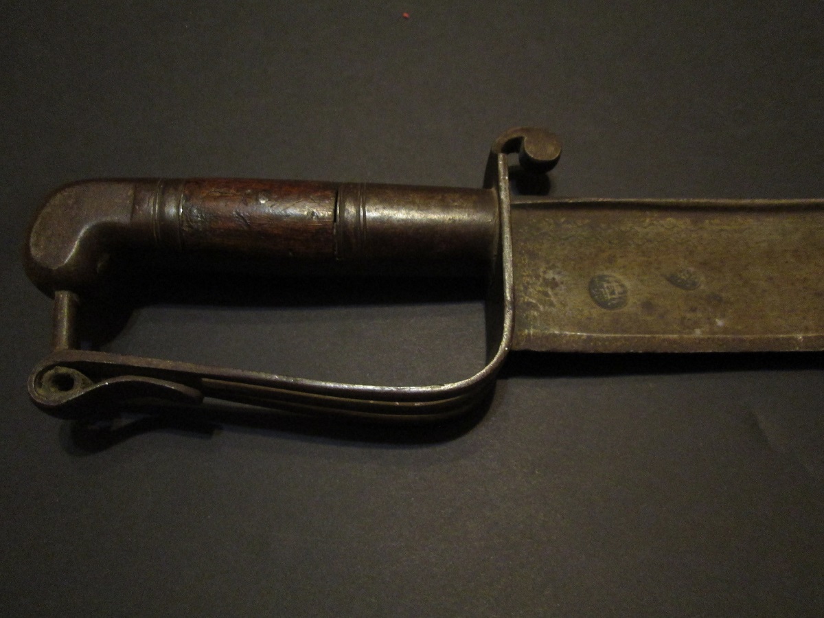

Heres One of the Official Afghan issue kukri, from 1894/5
& heres an Afghan made Lee Enfield/ Martini Henry 1888 Bayonet carrying the same mark.
Spiral

[QUOTE=spiral]Great thread Mahratt! The Afghans certainly loved copying weapons!
Thank you!
I think it's 1895.

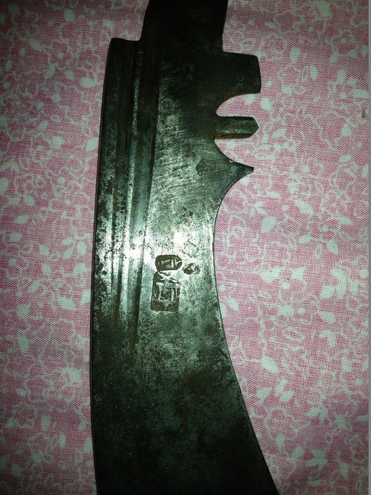

Old 23rd September 2015, 08:18 PM   #42
Tatyana Dianova
Posts: 800

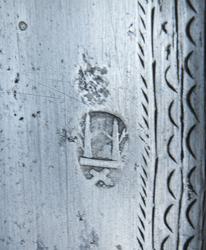

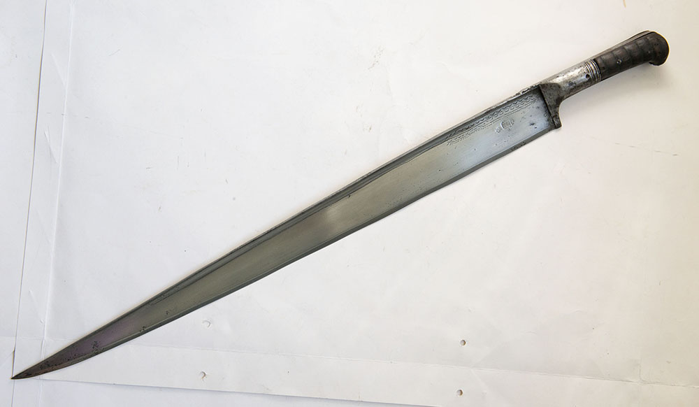

A small addition/correction to the excellent article. The author states that "...Against it is the presence of the Mazar-i-Sharif stamp on all 5 examples of this pattern known to us. This stamp was never present on the “ethnic” variety... "
I have found recently an ethnic Khyber knife with early stamps!

Location: Russia
Posts: 1,042
Thank you, Tatiana!
I think there is no contradiction in the article. The blade of the regular Khyber knife mounted ethnic handle. And engraved on the blade - it is normal for Afghans. They liked to apply inscriptions and ornaments on a regular bladed weapons.
I have seen several regular Khyber knives engraved on the blade and several regular Khyber knives with new ethical or not at all regular handle.
