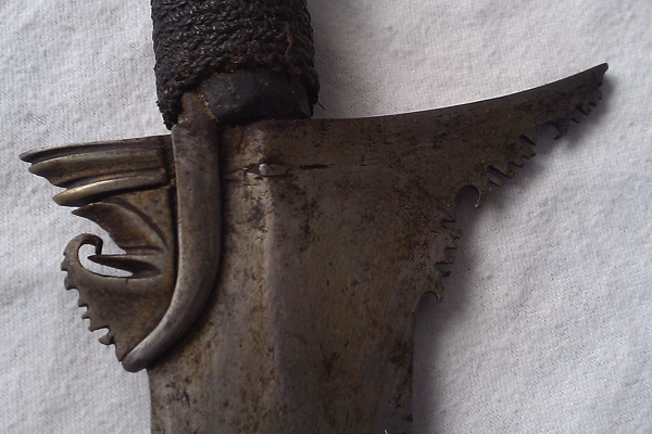

hello rick, you're right. the asang-asang has been pushed from the top, exposing the shadow line. at pic 7, the clamp is showned pushed back in line where the shadow's at.
jose: yes, the hilt is silver...

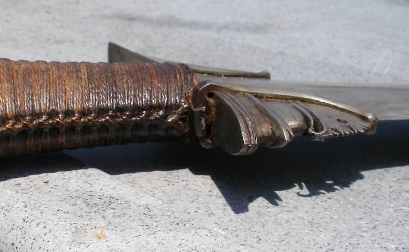

Ron, I have a Maranao kalis with bamboo wedges fit to make the Asang tight to the blade .
That might explain any play in the fit .
Old 28th June 2011, 07:49 PM   #37
Posts: 7,261
Interesting, so perhaps when the wedges deteriorate the clamp might move...

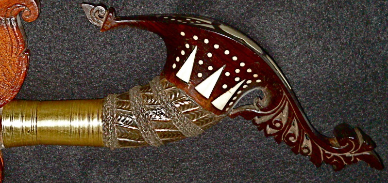

Your wish is my command.
This barong is from the turn of the century and from a datu who gave it to the medical officer of General Macauthur in WWII. Notice the silver work that is of a similar style to Ron's kris. It is always possible that his is newer, but I doubt it. Sulu does not make this type of work anymore as far as I know.

That looks nice Jose. Forgive me for asking, but if the piece was presented in WWII isn't it possible that the work on the hilt is much later than turn of the century? Is that pommel turn of the century also because it was always my impression that this form of inlay style came much later?

Actually Jose, i'll answer my own question since there is a very similar Barong on page 38 in Cato's book made of kamagong wood with ivory inlay. It also has similar silver work. It is not dated, but it seems to be lumped in with other late 19th and early 20th century barongs.
Old 29th June 2011, 03:57 AM   #45
Posts: 7,363
Actually no. The inlay style like this goes back to the 19th century. MOP inlay comes into vogue early in the 20th century. This inlay is ivory.
The junggayan style came in the late 19th century and more or less ended in the early 20th. Narrow time period. Definitely pre-WWII. I have seen other work like this from the 19th century from Sulu, but this is the only example I have in my arsenal to match.
And a very nice arsenal it is...

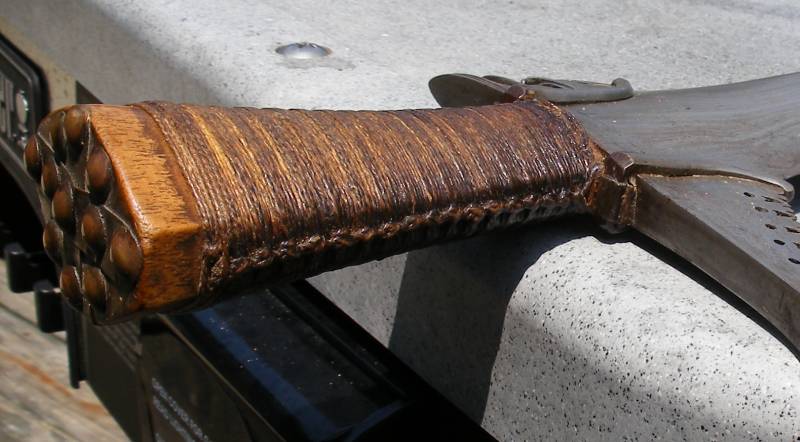

Join Date: Oct 2008
Location: Manila, Phils.
Posts: 1,042
detail of datu kalun's kris:
Old 29th June 2011, 11:08 AM   #49
Spunjer
Spunjer's Avatar
Posts: 1,730
Wow! Thanks for da close up, bro. Beautiful!

Ron, that Maranao has wedges under both asang .
Funny, ain't it .

I don't think this is of major interest to this thread, but I've an observation also about the asang-asang that could be of importance.
A Sulu kris I have bought a while ago, came to me in very poor condition, with very rusty blade, not cleaned in what way so ever, crosspiece broken and so on.
The asang-asang of this piece also looks like it moved off the place where it belonged to be.
But I'm almost sure that not anyone would have done some efforts to restore this piece according the condition it came with me...
If he would have taken time to restore the asang-asang, he would probably fix the whole kris totally!
So I guess the reason an asang-asang is off its place, doesn't mean it isn't the real asang-asang..

just a wild guess, rick... perhaps the asang2x was made a little too big and instead of ditching it, it was jury-rigged to fit. never seen one like that. that's pretty cool, tho...
