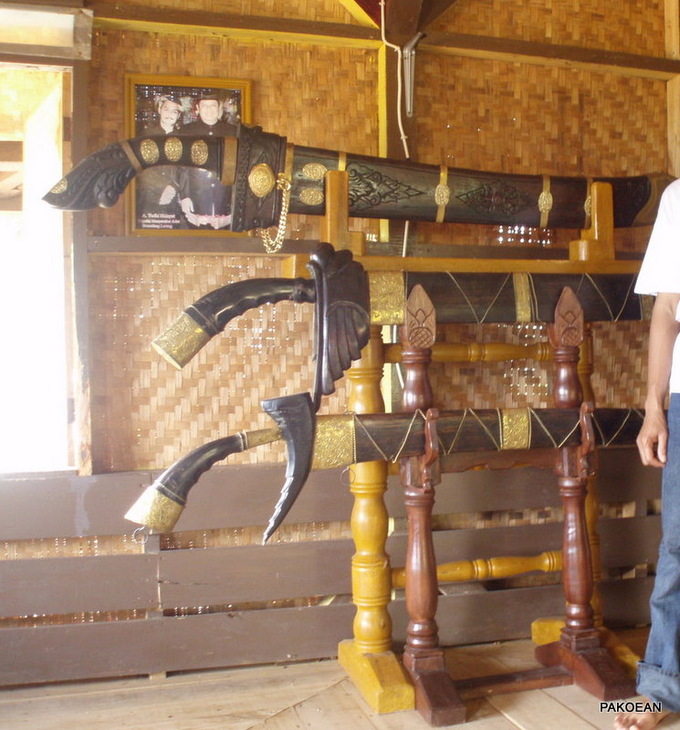

Have you ever seen a golok of this size? From you comments it seems large, even for a golok of this type?

As for size, have a look at my picture; that's only a five-foot-something standing next to the goloks.
'Soemedangan' means in the style of Soemedang, which is the name of a city, the capital of a Regency of the same name and the name of a previous kingdom, deemed by many as the de facto inheritor of the old Soenda-Galoeh kingdom.
