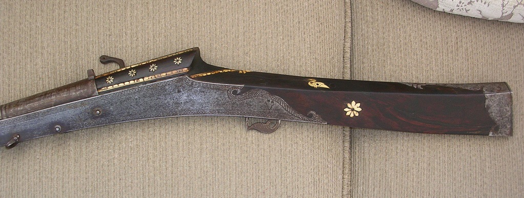

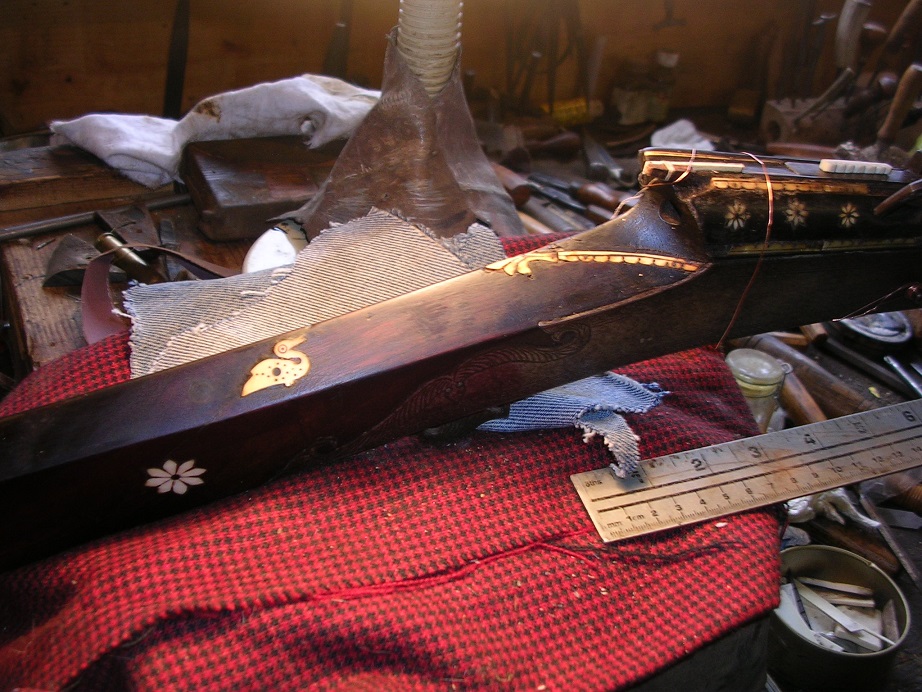

Rather than leave you worrying about the above mess, here are some pics of stage 2;
Had some very similar rosewood fortunately, for patching!

Hi Richard.
WOW !!! That stock repair looks like it's coming along just fine. Great Work !!!
The use of metal rods versus wood pegs is a great idea in this case. Especially with that type of break, and the length of the butt stocks on these guns. And looks like that rosewood blended in very nice. Thanks for the pics with the update. I still like the iron mounts on these guns better than the brass mounts, especially if engraved.

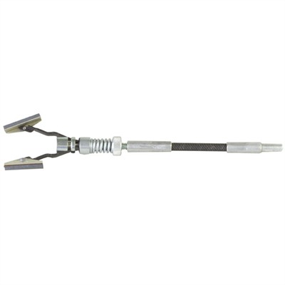

Yes, sounds like the bore needs some more work. The scale can be especially difficult. What I use to use, and still sometimes do, is a modern shotgun hone. I found that just going back and forth, manually with the hone works much better then the Emory. And cuts faster. Even better, the hone using a drill with a VERY SLOW rpm setting. They are hard to find nowadays. The slow rpm with even motion is less likely to form rings. At least that's been my experience. Works great especially with pistol length smooth bore barrels.
On long barrels, I send them to the barrel smith. He has special tools and jigs to burnish a barrel in about 10 minutes. And can do barrels up to 72 inches. And very reasonable.

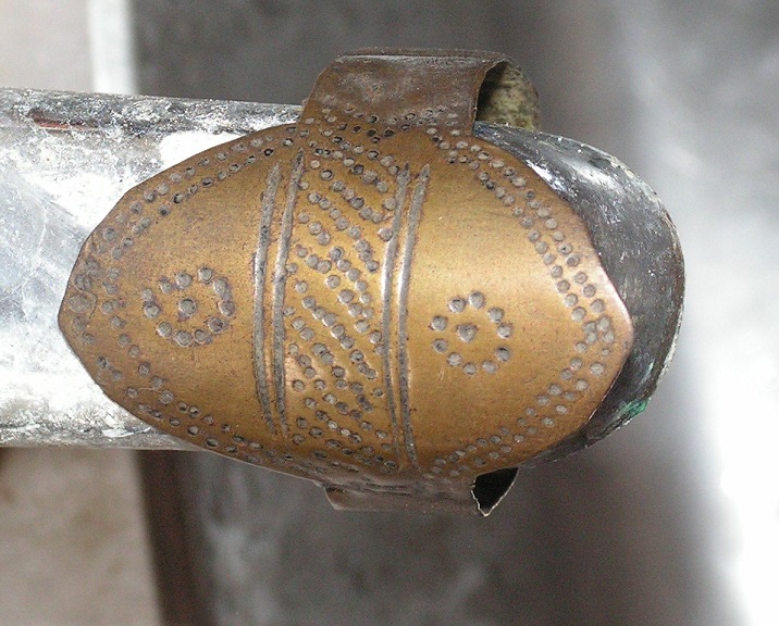

I have a matchlock with these saddle bands, but have not seen David's saddles he mentions.
See below;
See below;
Hi Richard.
Finally back home. LOL That barrel band looks Afghan to me. You see this style on Jazails. But I still like the colored leather bands idea.
Shotgun Hone: There are a couple different ones out there. Here is a pic of the one I use. The stones actually pivet as you go back and forth in the bore. Would also automatically adjust to get the slightly smaller restricted area. They are very inexpensive, and you can purchase extra stone sets. Works great even by hand. Just twist as you go back and forth. They also make a polishing tool with compound.
