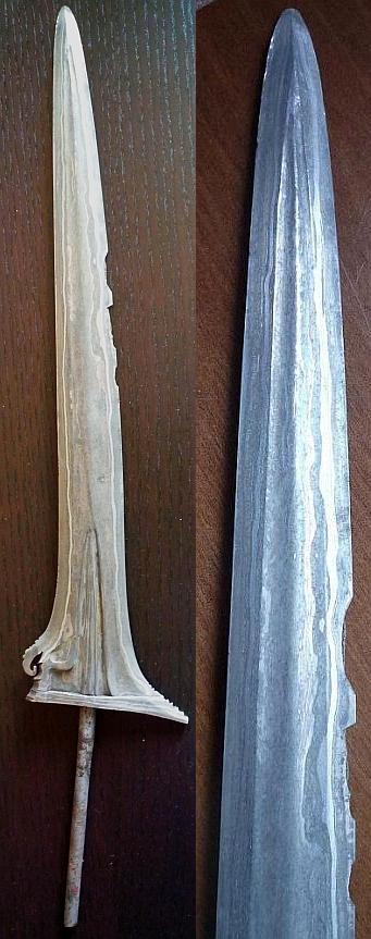

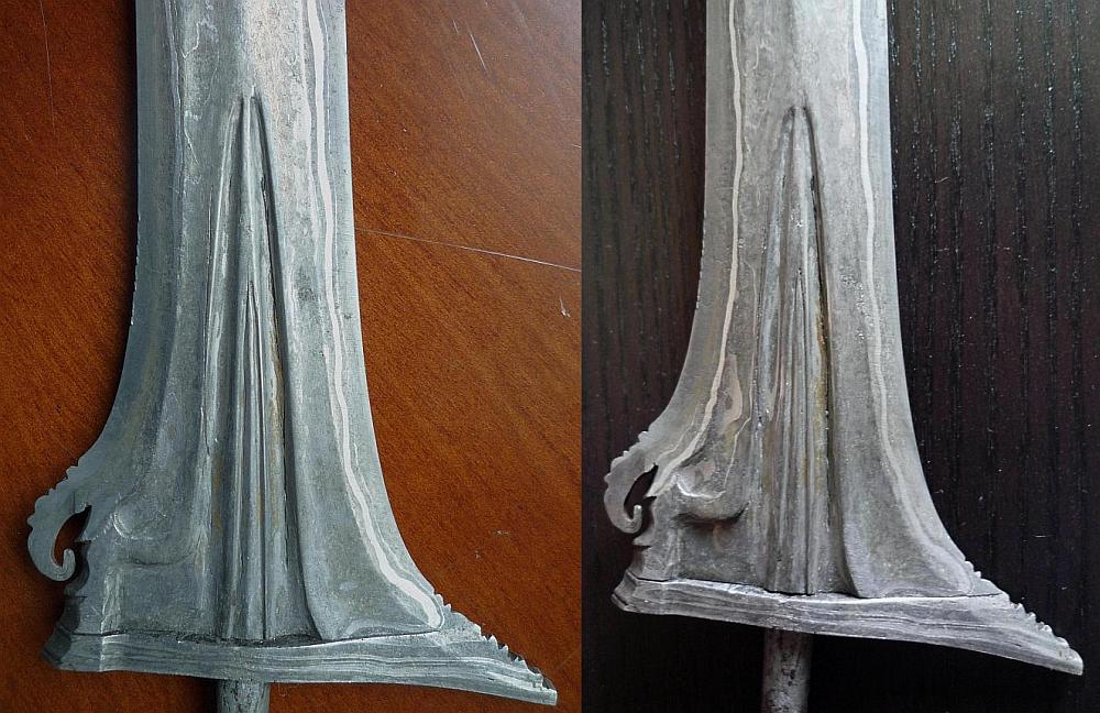

Old 5th June 2011, 11:29 AM   #38
mrwizard
mrwizard's Avatar
Join Date: May 2010
Location: Dortmund, Germany
Posts: 102
Here are some impressions of the keris just after cleaning. The staining is still from the fruit acids of the pineapple juice (or possibly from residual arsenic as Alan wrote).
Best Regards,
Thilo
