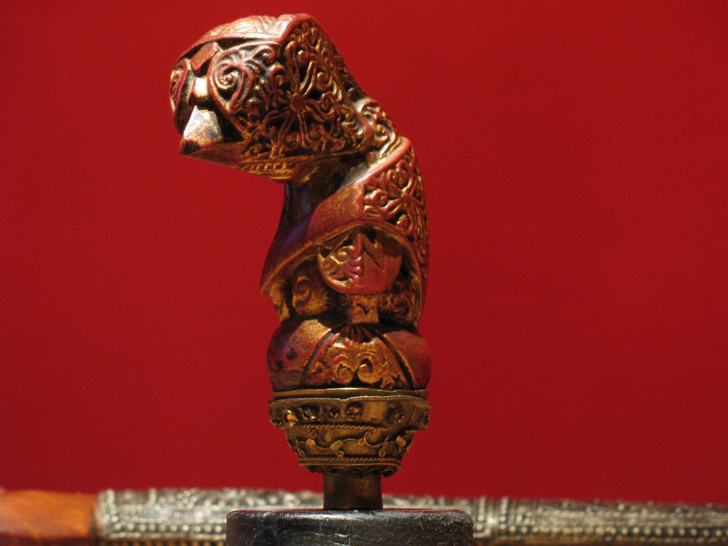

It was brought back by someone who worked in Indonesia in the 1920's - 1930's. I am also quite curious about the hilt.
Looks pretty strange to me. as if it has been painted with red and gold paint
Willem

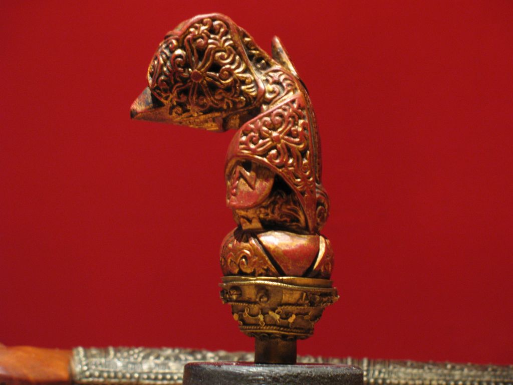

Posts: 2,238
Not to sure about the selut either...
I am busy cleaning the blade and thinking about another selut because this one is really below any quality.
Hilt is nice . carved and painted in red and gold. a bit weird but seems genuine.

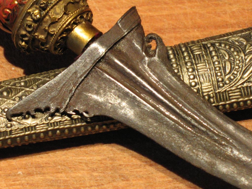

Old 27th June 2009, 12:04 AM   #8
asomotif
asomotif's Avatar
Join Date: Nov 2006
Posts: 2,238

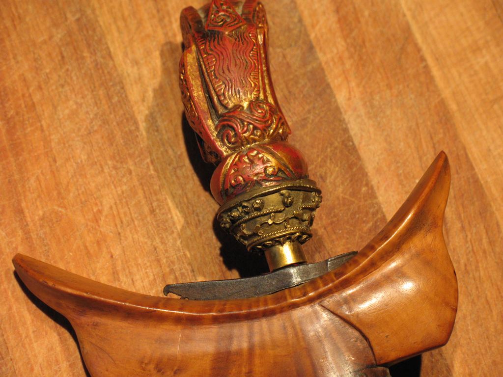

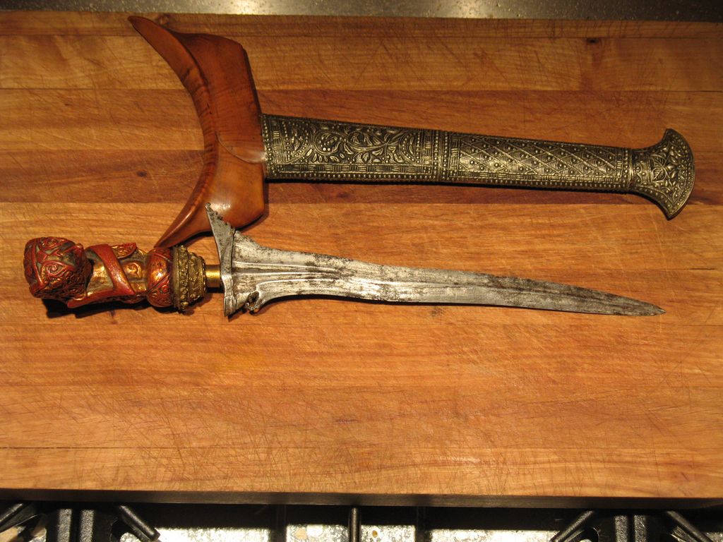

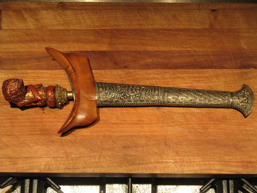

some pictures
Old 27th June 2009, 01:07 PM   #9
Posts: 9,559
Hello Willem,
nice Minang keris. I think that the selut is original, not the best quality but ok. Very nice hilt and pendok.
sajen
Old 27th June 2009, 06:07 PM   #10
Posts: 7,267
I'm not so sure that the selut is as much bad quality as in bad condition. It looks to me that it may have originally had stones set around the top. At least those look like empty settings to me.
Old 27th June 2009, 06:45 PM   #11
Alam Shah
Alam Shah's Avatar
Join Date: Jan 2005
Location: Singapore
Posts: 1,248
Hi Willem,
Nice Minangkabau keris. Lovely luk 3 example. The blade form is nice, similar to ( mine ).. the selut form is original, top row used to be decorated with red stones, followed by wire-works decorations.. as David mentioned, the stones are missing.. ( see example ). Lovely hilt in jawa demam form.. does looks minang to me. Congrats!
Old 27th June 2009, 09:14 PM   #12
Posts: 7,267
Thanks for the complete example Shahrial. Doesn't look so shabby when we see the original form.
Old 28th June 2009, 01:45 AM   #13
asomotif
asomotif's Avatar
Join Date: Nov 2006
Posts: 2,238
Thanks Sharial for the better example of this type selut.
Indeed these are settings, only one has a red stone and the others are deformed or missing. It also looks like someone has applied gold coloured paint to my selut.
I will see if it is possible to restore the selut.
Heating the complete selut in order to weld on new settings will probably destroy the thing.
But maybe a loose ring with settings can be made.
Will be quite some work, but the blade and hilt are worth it.
Thanks and best regards,
Willem
Old 28th June 2009, 02:53 AM   #14
Posts: 6,388
I love the handle !

Old 28th June 2009, 10:07 AM   #16
Jean
Join Date: Jun 2009
Posts: 1,740
Originally Posted by Alam Shah
Hi Willem,
Hi Alam Shah,
If this hilt is not Minang, where is it from according to you ? I read that it is customary for the Minangkabau to wear gold-painted wooden krisses during wedding ceremonies.
Best regards
Jean

Old 29th June 2009, 11:03 AM   #19
Alam Shah
Alam Shah's Avatar
Join Date: Jan 2005
Location: Singapore
Posts: 1,248
Originally Posted by Jean
Hi Alam Shah,
... I read that it is customary for the Minangkabau to wear gold-painted wooden krisses during wedding ceremonies.
Best regards
Jean
Yup, I've read that too..
red and gold are traditional Minang colours - red (which symbolises courage), black (which symbolises strength) and yellow or gold (which symbolises victory)..

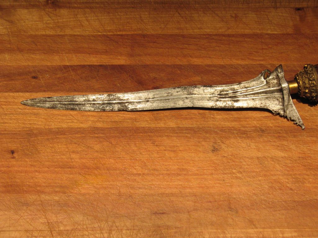

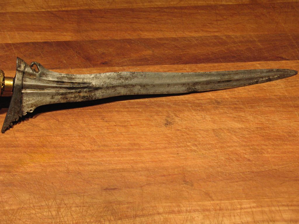

Old 9th July 2009, 01:27 AM   #21
asomotif
asomotif's Avatar
Join Date: Nov 2006
Posts: 2,238

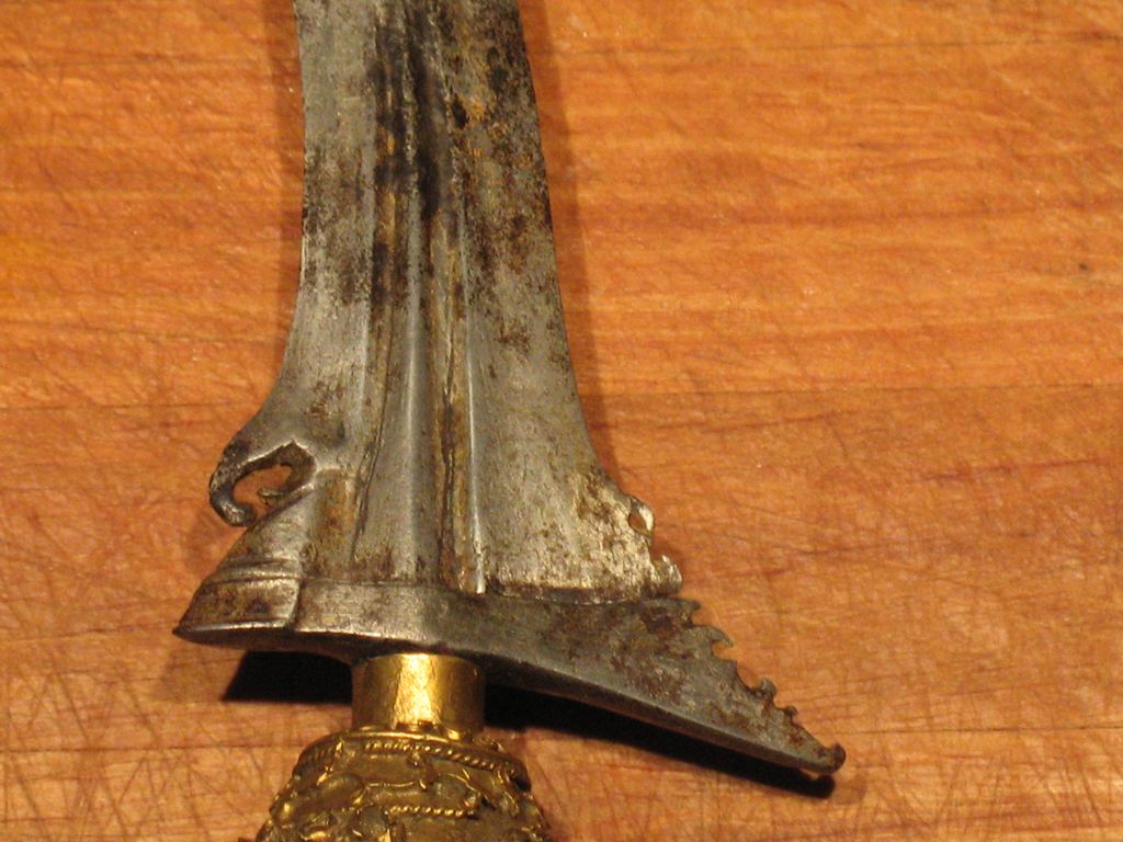

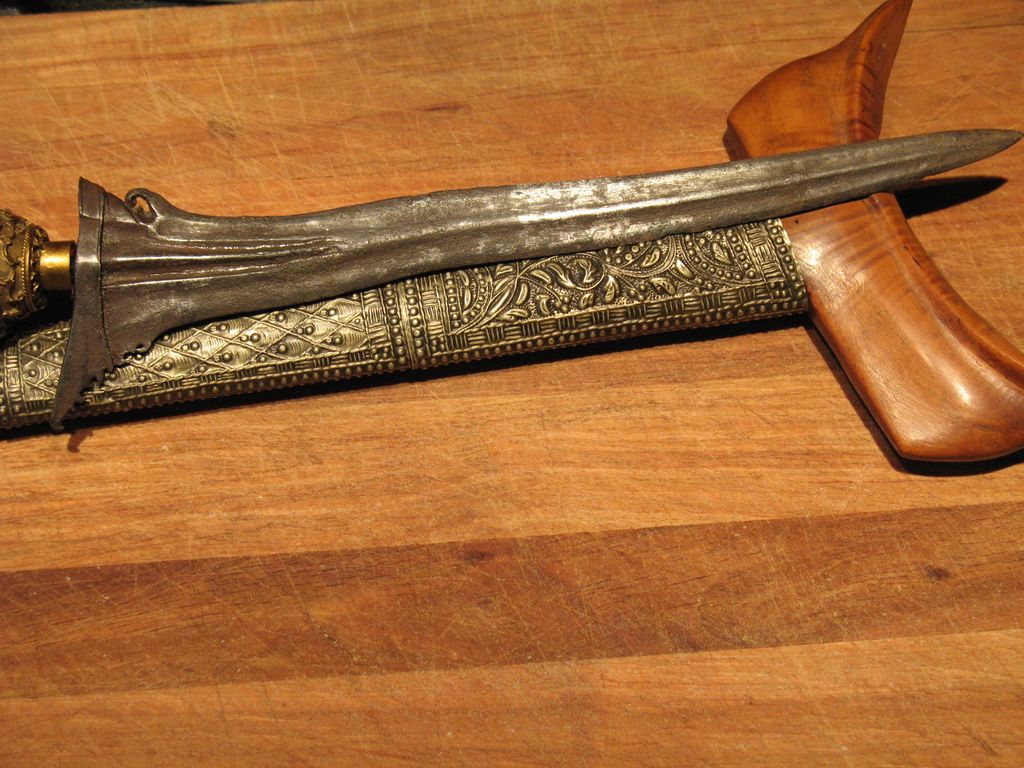

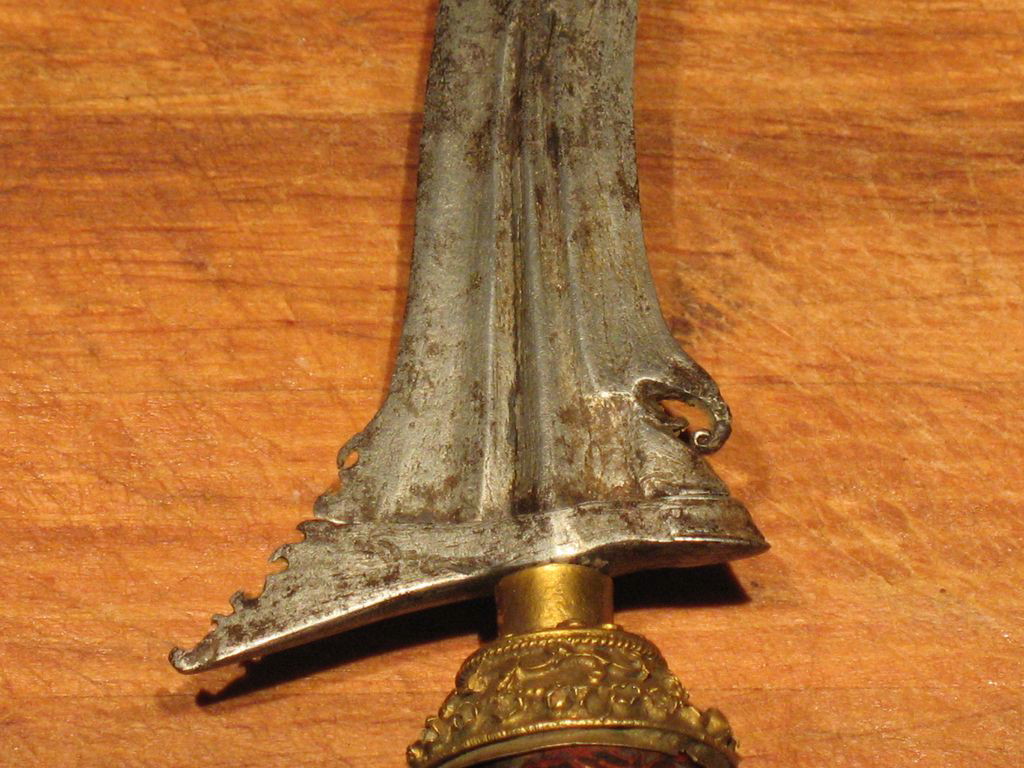

I did some cleaning on the blade.
Any comments on how it is now ?
Seems like a very well executed blade to me.
Old 9th July 2009, 01:57 PM   #22
Posts: 9,559
Hi Willem,
like I write before, a very nice keris, the blade is indeed very good worked. When I am you I will clean the blade until all corrosion is away and then I will blacken the blade. BTW, this keris would be a great a addition in my small Minang collection. Again, a very nice keris!!
