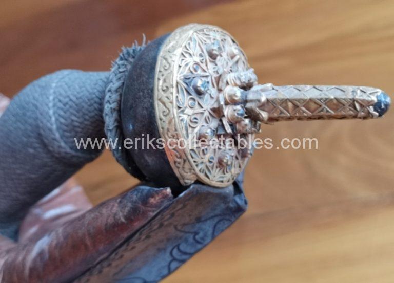

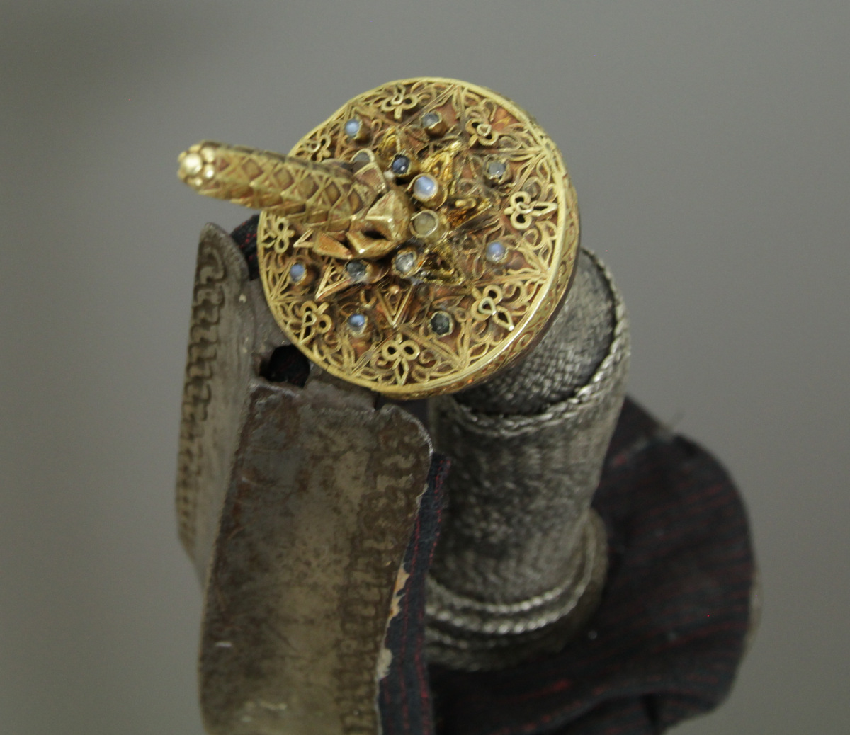

Here are some pics of the before mentioned gold top pieces of handles.

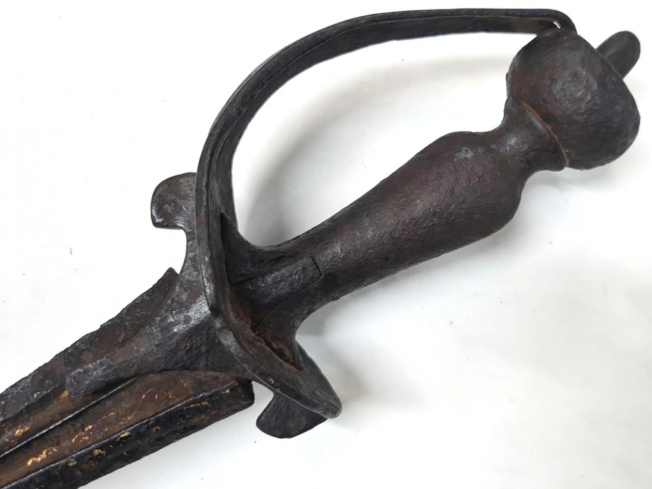

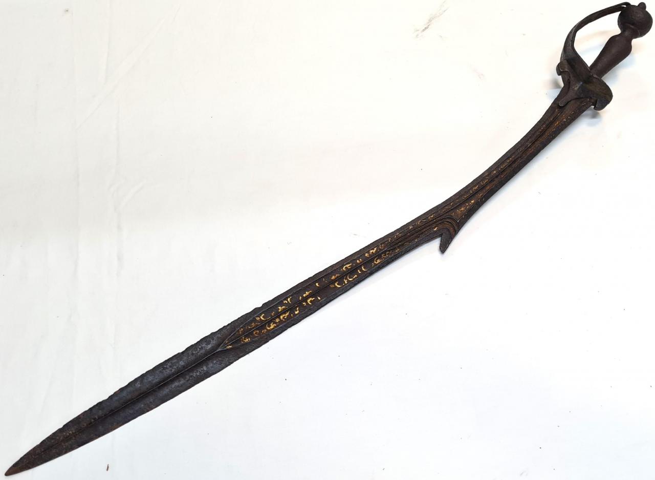

I don't know how far back they go but this rather cool looking lar bango sword (18th c according to the auctioneer) has something that looks to be an earlier version of such a hilt (grip not as strongly curved near the pommel as these later examples).
