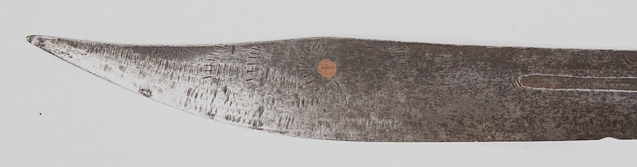

Towards the tip is an inset brass dot with radiating rays of brass. There are two rows of "arrowhead" marks incised into the blade and pointing towards the tip.

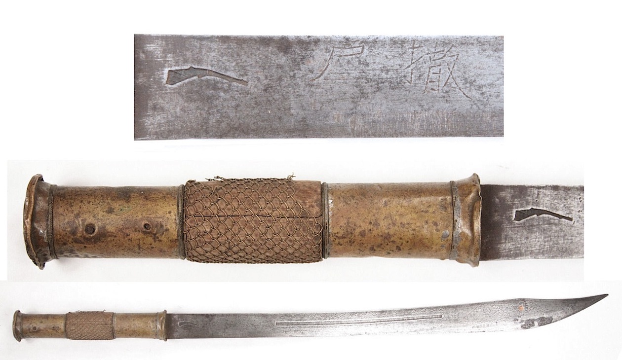

Default Another example (without scabbard) with a different blade and hilt
Here is another one that I have had for many years. It has a rifle mark stamped at forte, the HuSa mark in Chinese characters, and a brass dot adjacent to the tip of the blade.
