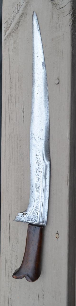

I recently acquired this knife that is a composite. The blade looks like it could have been a Kris at one time or another and it has traces of silver inlay.
It is attached to a basic wooden handle.
The blade measures 14" long.

Oh WW!
Must to have been heavily damaged from a wavy kris to be modified like this and originally silver inlaid.

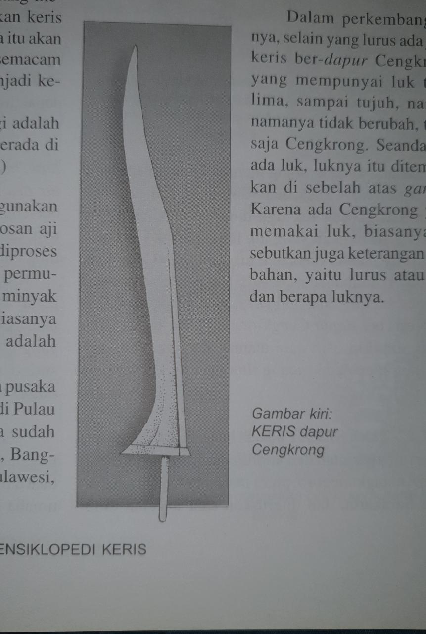

Hi All,
On pg 127 of Ensiklopedi Keris, Harsrinuksmo shows a drawing of a very similar looking blade and lists it as "KERIS dapur Cengkrong. The illustration appears to show a ganja.

Old 20th November 2025, 07:19 PM   #6
Interested Party
Interested Party's Avatar
Join Date: Dec 2019
Location: Eastern Sierra
Posts: 518
Interesting piece! What script is this or is it something resembling an inscription? Am I right in that it says "Allah" 3 times?

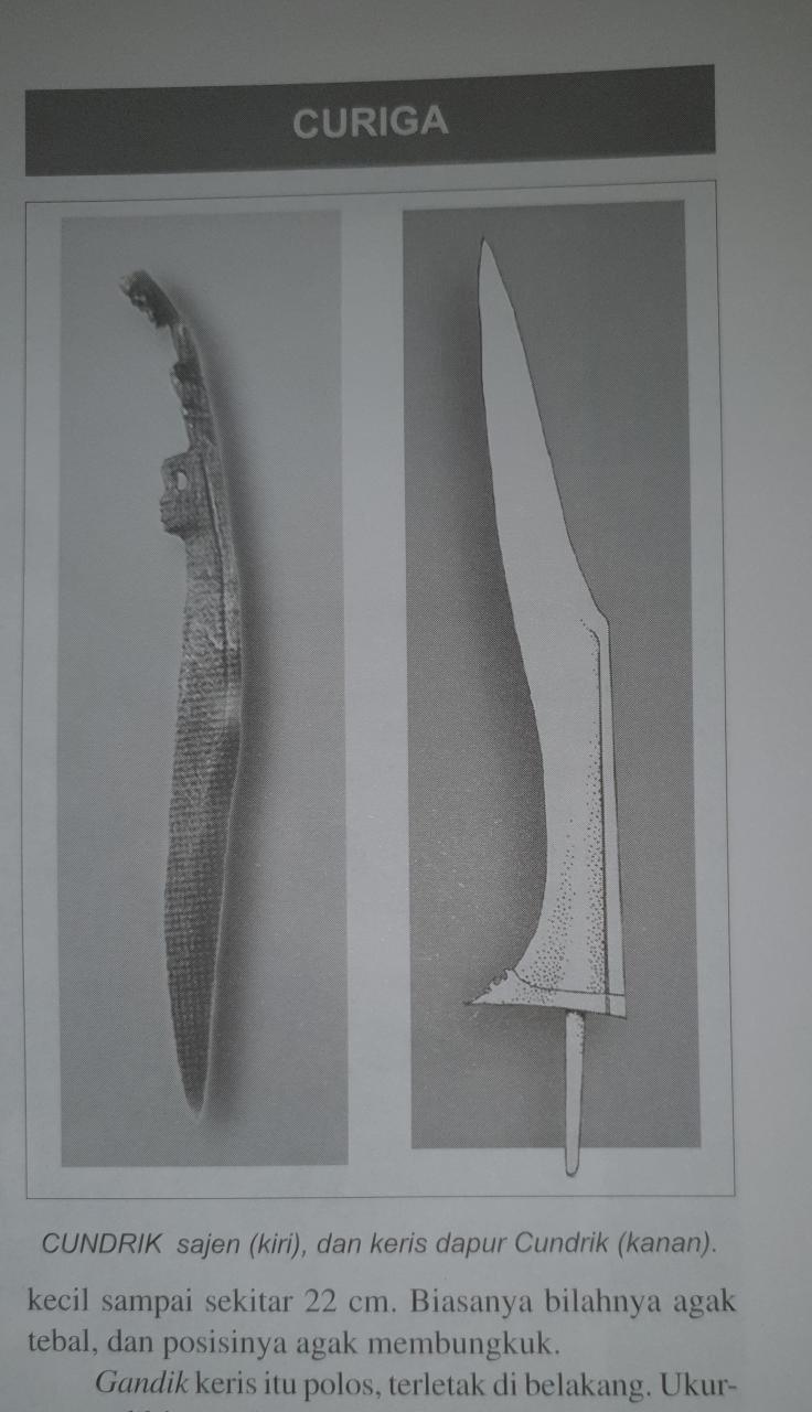

Old 20th November 2025, 09:41 PM   #7
Posts: 9,526
Originally Posted by drac2k View Post
Any chance of getting a picture of the drawing?
Hi David,
Here at first the pic. from page 127 and also another one from page 133.
On page 127 is shown the dapur Cengkrong, on page 133 the dapur Cundrik.

Hi drac,
I like this knife but I think it would look better without the rather clunky hilt. The published examples have no hilt—just a bare tang—so we don't really know what type of hilt it may have had. It seems the blade is meant to be kept white (not etched), so a clean and polish might be in order. Also, restoring the silver inlay would enhance its appearance IMHO. Battara might be able to help with that. After all that, you could have a pretty valuable knife like the ones in the publications. Just my $0.02.

Thank you all for your insightful comments.I think , based upon what I have heard here,is that at one time this was a nice Kris, however through time, misuse, or even it having been acquired by a different ethnicity, it has been heavily altered as evidenced by the missing ganja, the crude handle, etc..There may even have been some blade modification.
Without an illustration of an exact match, I think I would do more harm trying to restore it into something I want it to be as opposed to what it is.

Yes, it might have been made from a repurposed blade, or it could also have been made from any piece of ferric material that was of adequate size to accommodate the design. I can see no evidence in the photos that might indicate that the material used is of laminated construction, so that in itself does limit possible sources.
