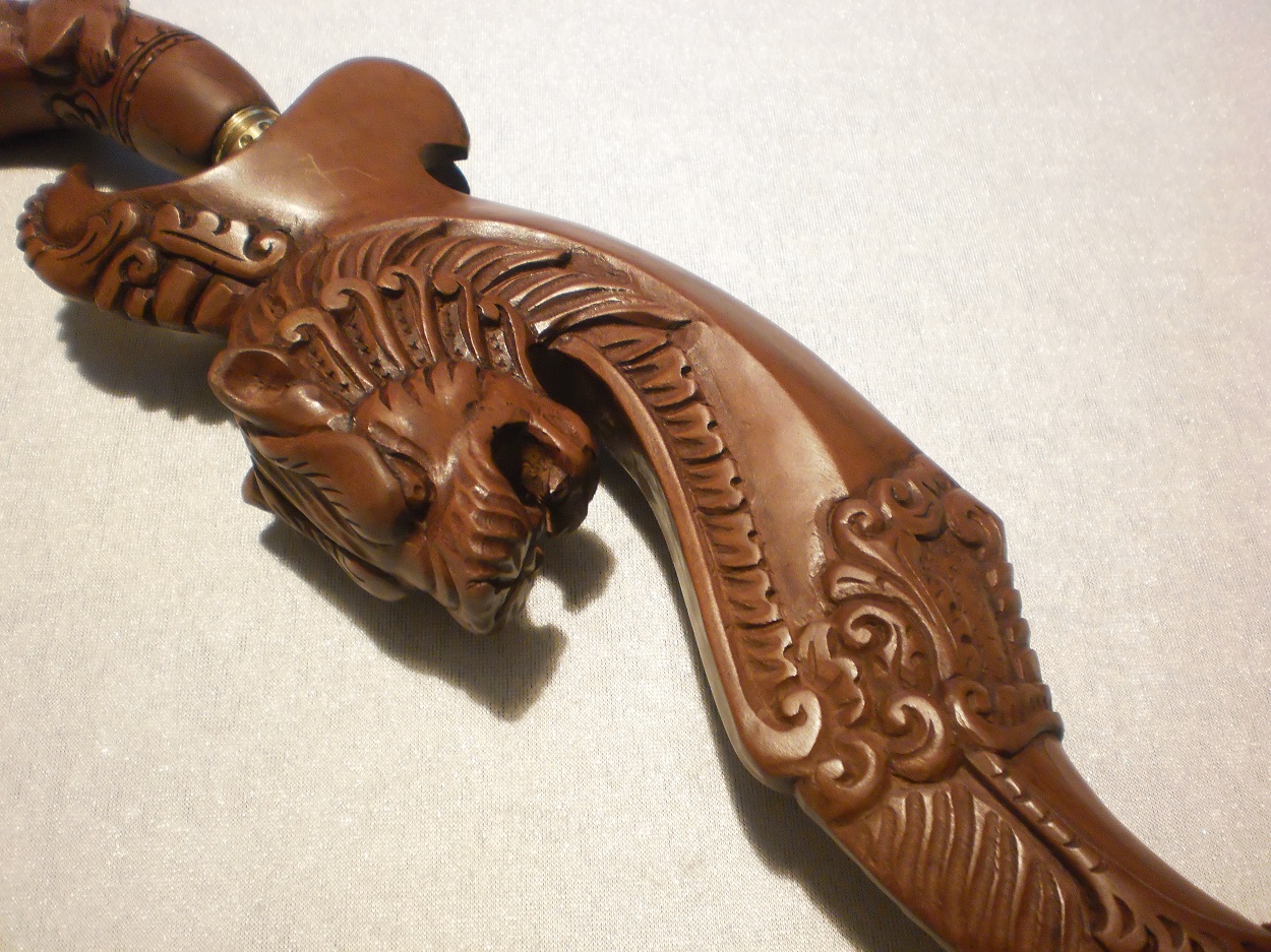

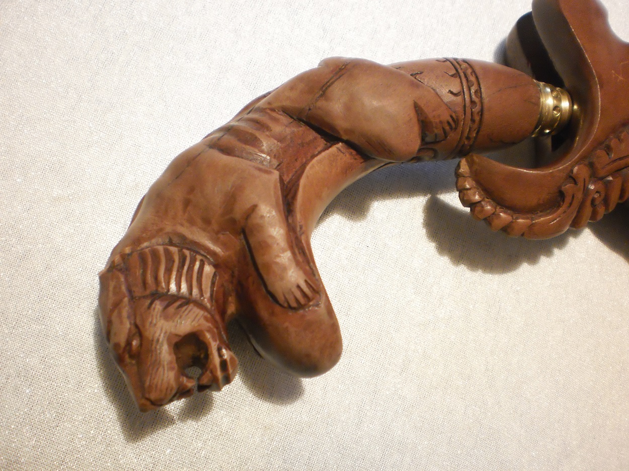

I received this Kujang, your comments are welcome. The handle is carved in the shape of a tiger, the scabbard is decorated with a tiger's head and a paw as tip. The blade shows a nice pamor pattern.
dimensions: total 45.5cm; without scabbard 36.5cm; blade 22.5cm
I have some questions about it:
- How old could it be? I think it is not very old, but I'm not sure.
- Was this weapon only used by the Sundanese people?
- My Kujang blade has 7 holes. In this thread I can read that this refers to the seventh month of pregnancy: http://www.vikingsword.com/vb/showth...ghlight=kujang
Is this right or are there other possible interpretations?

Your kujang is fairly recent. I could say exactly, but i would image the oldest it could be is late 20th century, but it could well have been made yesterday.
Yes, this is a blade that is generally considered specific to the Sundanese people.
I find most of the lore that surrounds these blades to be relative new. If you have a kujang that "refers to the 7th month of pregnancy" i'm not really sure what that even means exactly in any practical or even spiritual sense. That is not to say this incorrect information, but someone would need to expand upon that greatly to make it useful information in my opinion.
So it looks like a nice new kujang with an attractive dress.

I'd agree with "recent" as well as with its being a very handsome piece of work.

Thanks for your comments.
The reference of this holes to pregnancy months was also a little questionable to me. I don't understand what that should mean exactly. Maybe they were just a decoration element in the past and all cultural or religious interpretations are new or fantasy.

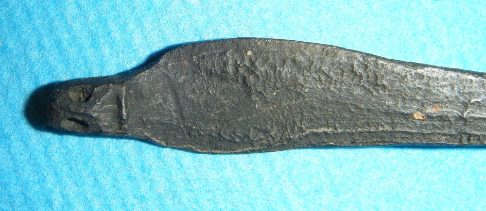

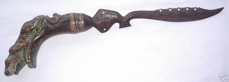

For comparison an old one I've bought some time ago.

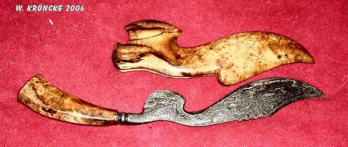

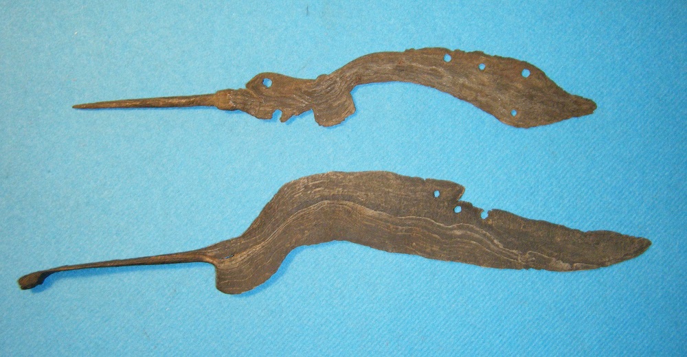

2 Other old Kujang for comparaison one with 4 holes and one with 3 holes:
Old Kujang

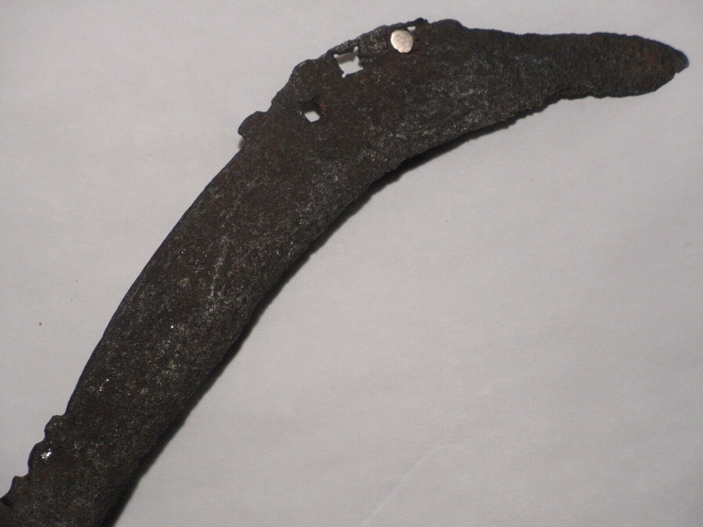

Detlef, what material is filling that first hole on yours?
Old 24th January 2021, 10:26 AM   #18
Posts: 9,526
Hello David,
It's some sort of white non ferric metal, maybe silver or mamas. And I bet that the two other holes were filled with metal originally, I will take some close-ups later. The kujang is at the moment in restore status.
The filled hole and the original old appearance of it was the reason I bought it.
I only will remove the rust, a little bit polish and a new etch of the blade. The mendak was broken in parts after removing the handle, it will get an other old one.

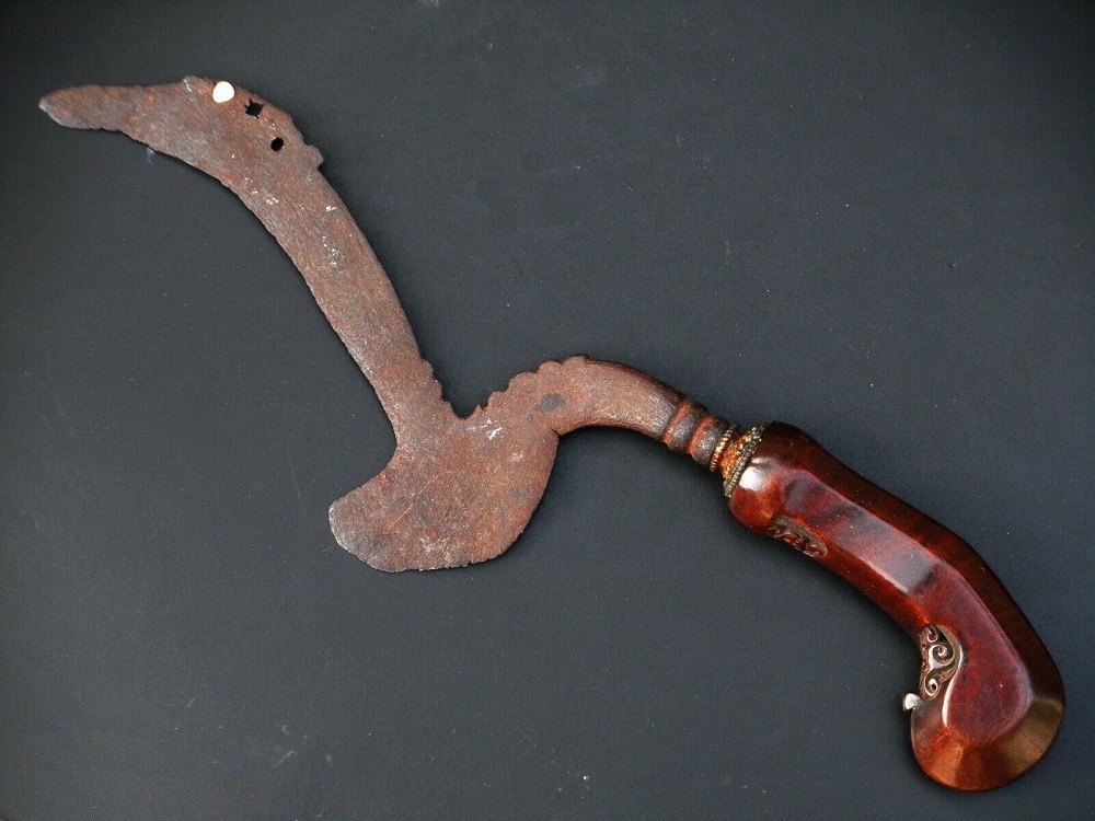

Just noticed that I don't need to take new pictures, I can use the good seller pictures. You can see why I think that the other holes were filled once also.
Old 24th January 2021, 11:28 AM   #20
Posts: 9,526
Two other ones from my collection.
