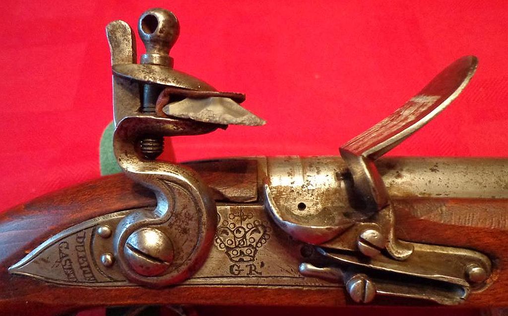

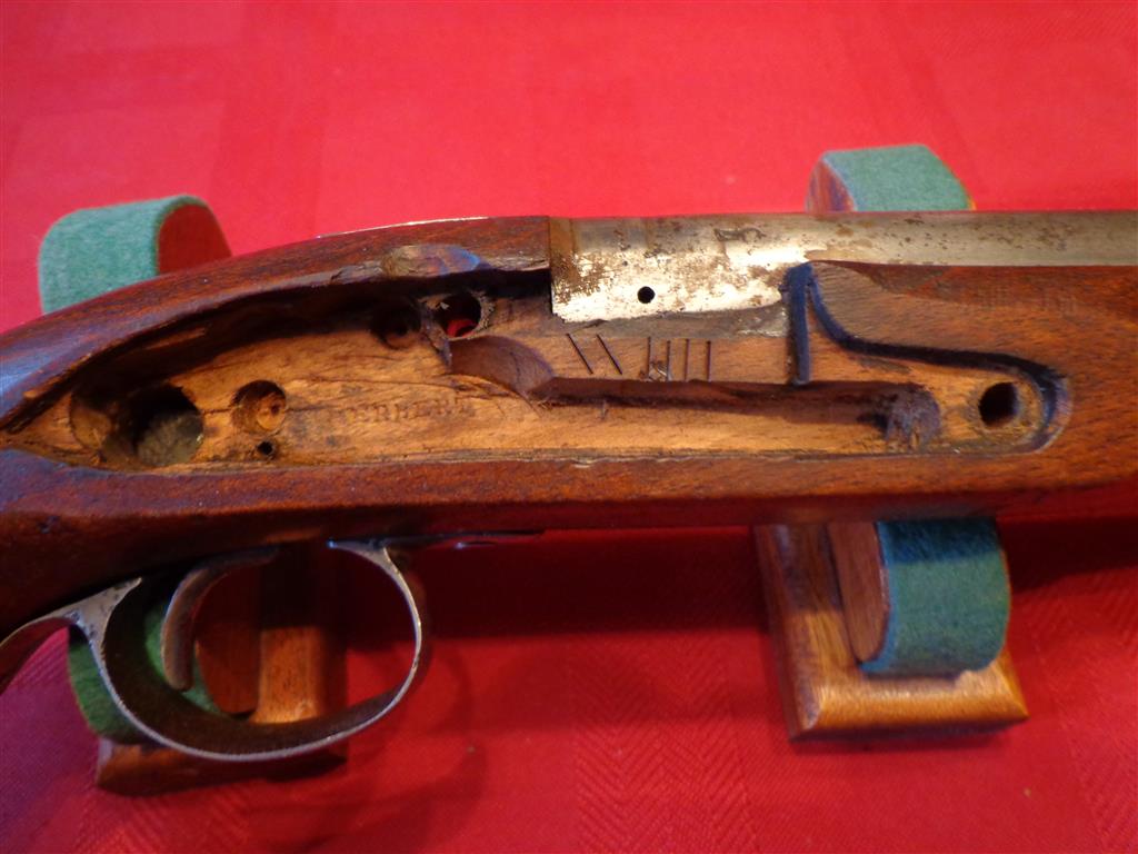

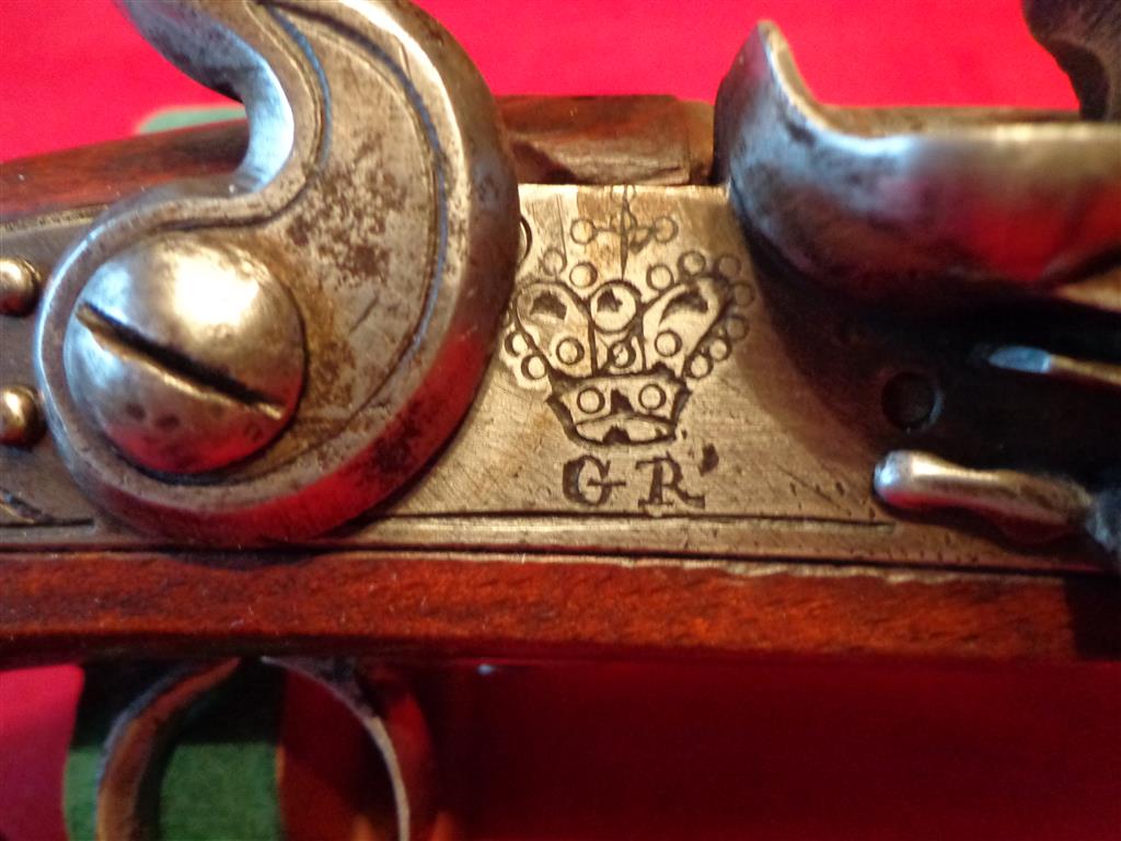

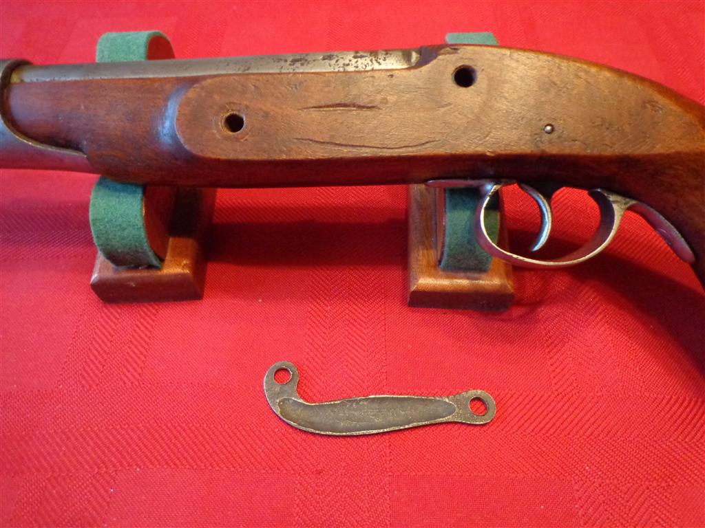

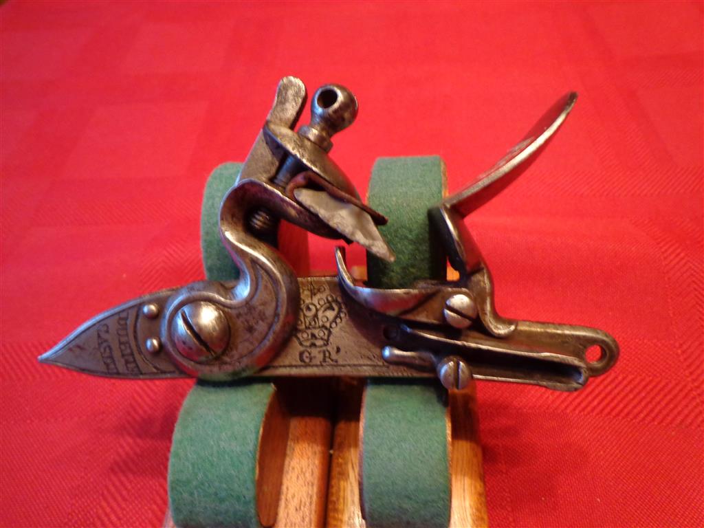

Hello All. Here is a new addition. I believe this pistol was an Afghan bring-back at some point. But is more interesting than most I have seen. It's plain, robust, and undecorated. And made to be a working gun versus a tourist item.
At first, I thought the markings on the lock plate might be spurious judging from the original photos. But after receiving the pistol, I'm confident it's a genuine lock from a British Light Dragoon pistol from the early 19th Century. The lock and markings match exactly. And works/sparks perfectly. The barrel is .57 caliber, 9" long (possibly shortened during the period) and has British proof marks. But I can't make out the marks. The bore is in very good shape with just a partial coating of light rust. No corrosion. The vent hole in the barrel lines up perfectly with the pan. The barrel band, butt cap, trigger guard, and side plate are all hand made. The lock plate screws are genuine Military with good European cut threads. So I believe the screws are genuine with the lock plate. The stock is also hand made locally but with much better lock inletting than you normally see on these guns. But inside the lock mortise there is a stamp marked HERBERT in perfect English letters. Hmmmm. Curious. Don't have a clue what the connection would be (?) Maybe someone on the European Forum might know ?
A Google search turned up something interesting. This exact pistol was sold at Rock Island Auction, along with two other flintlock pistols on June 25, 2016, Lot # 2190. I bought it from a shooter/hobbiest on another forum.
So my impression is that this is an Afghan made pistol utilizing an original lock and barrel. And a good example of their custom of making guns with what ever combination of surplus parts were available, and hand making the rest.
I just wish I knew what the connection of the HERBERT stamp means ? Anyway picture heavy. Any comments most welcome. Thanks for looking.

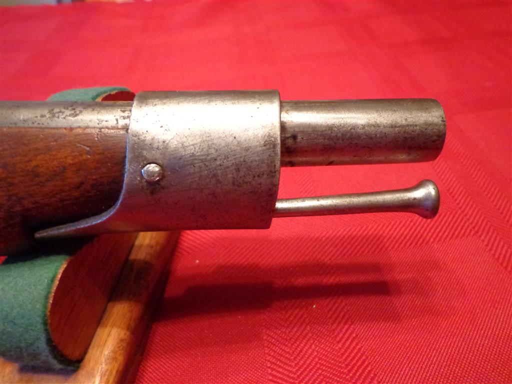

Old 19th January 2019, 04:44 PM   #2
rickystl
Join Date: Jul 2010
Location: St. Louis, MO area.
Posts: 1,633

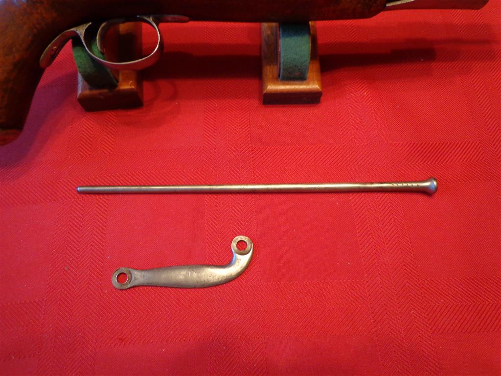

MORE PICS.........

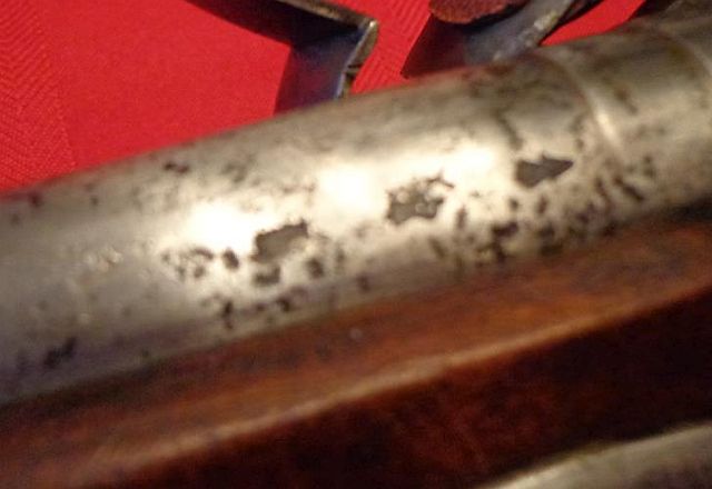

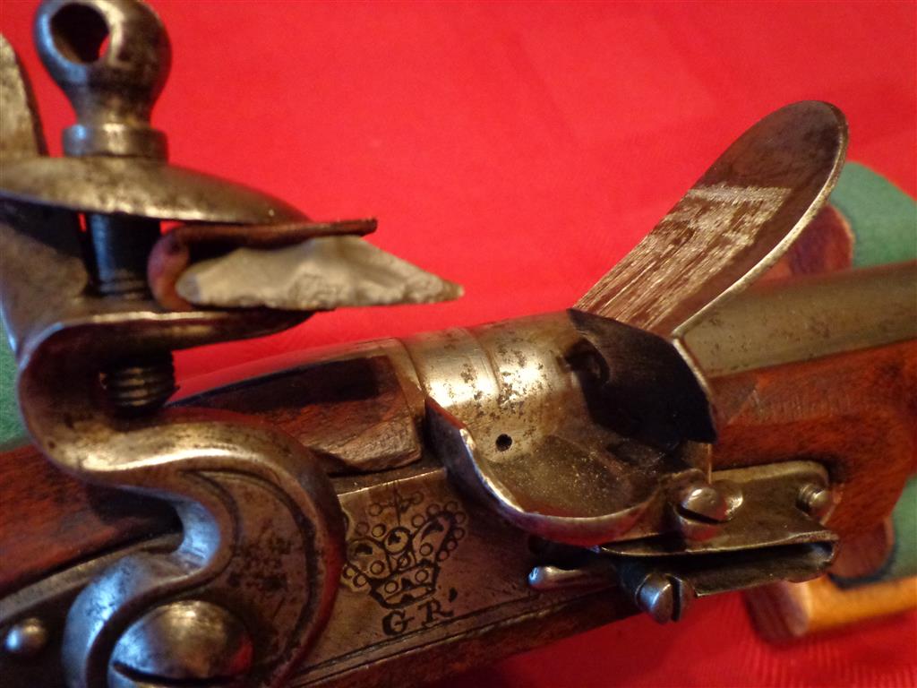

Old 19th January 2019, 04:46 PM   #3
rickystl
Join Date: Jul 2010
Posts: 1,633
STILL MORE.........

I beliefe that this pistol has been made in another country!
In the second half of the 19th century Liège gunmakers tried to buy as much as possible surplus muzzleloader weapons or their single parts in all countries of Europe. These mostly percussion arms have been retransfered to flintlocks and sold into the colonies and lots of still undevellopped countries in the middle east or South - Amerika. A huge deal with lots of money to make!! The French call these weapons "Armes de Traite" .
Your pistol is certainly and without no doubt made at Liège under use of an original British lock and barrel but got a complete new stock. The name HERBERT is surely not the name of an Afghani but of the Belgian who made this stock for your pistol.

Hi Rick,
Very nice pistol but I do have some observations. Although the lock itself may possibly be an original, I do not believe that the Crown and GR look to be the quality of English engraving. Also the word DUBLIN?? and whatever is underneath it do not look right to me.
Re the Proof marks....if you can post a clear pic of these I should be able to help. Certainly the crowned V is a view mark used by English Proof Houses. The others are not clear enough to identify.

While firearms are surely not my typical field of study, and I do not at all discount the observations thus far, I am under the impression this very interesting pistol is a version of the 'late dragoon' type....but legitimately produced. I do not personally think it a Liege example, though this center certainly produced huge volumes of copied and repurposed arms as described.
Neither do I believe this is an Afghan copy of same, though the rather crude engraving does parallel the often remarkably faithful copies of British guns produced in the Khyber regions (Northwest Frontier agency).
In both these cases, it does not seem that the name stamp inside the stock behind the lock would be present, though of course in actual British context it would be placed by assemblers in accord with that practice.
In "British Military Pistols 1603-1888" R.E. Brooker, (1978, p.45) example #40 shows one of these dragoon pistols from DUBLIN CASTLE, and the crown over GR (George III, 1760-1820) . On the example illustrated the markings are remarkably similar, and the surround border on the Dublin Castle is correct. While the lock seems correct, the other furnishings seem varied, such as the side mount serpentine not at all similar.
Brooker notes that during the Revolutionary War these pistols were assembled in Ireland in large volume as the local military forces were increased to 50,000 men. With this ersatz production volume it seems logical that established makers as well as sub contract workers were employed in this production. As such, it seems possible that quality as well as consistency was wanting,and as Brooker suggests, the numerous 'variations' presumed by collectors.
Perhaps this scenario may apply here, though the case for the Belgian or Afghan productions are entirely plausible.

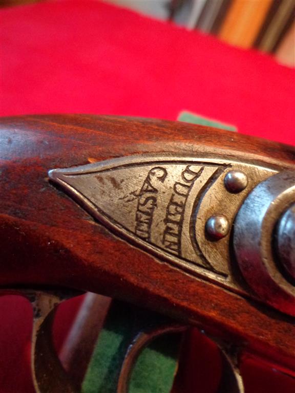

Thank you Jim for deciphering the word under DUBLIN. I could not make it out. I note your comments but wonder at the engraving of the words which do not seem to quite fit the space without squeezing up the letters. Not what I would have expected from English engravers..............
Now to the "Liege connection". I am familiar with Leige made copies, but have never seen one WITHOUT the correct Liege Proofs. Remember that Proof is and was governed by Law, and any LEGAL production would have had to abide by the Proof Laws of the time, and carry the relevant stamps.

Totally agree Stu, this engraving really is substandard for British work, and also agree that Liege work characteristically does carry proof marks. I am not sure how much this was enforced with Liege arms in the 18th century, but 19th century items seem always to have these marks someplace.
As I mentioned, what puzzles me is if this were Afghan, or for that matter to add impetus to the Liege question, is why would that assemblers name be behind the lock? I will say that the terrible execution of letters/serifs and the crowding in the 'CASTLE' word does suggest something like the Khyber work.
Again, it would seem if there were a sudden push to arm all these local volunteers during the Revolution, and the notable volume of pistols being probably farmed out in Ireland for finishing.....the quality of many of these may well have suffered. In the images in Brooker, the DUBLIN CASTLE were in the same configuration, and the crown and GR were positioned the same, partially obscured by the cock.
I agree, the letters are clumsy, and the line seems to be equally clumsy in execution, but work is only as good as the skill of the engraver. It does seem there are required proofs on the barrel here, which suggests that while not prettily done, it was likely functional enough.

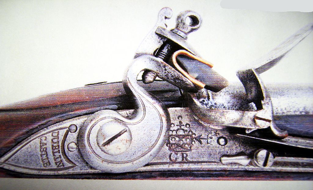

Here you see two pistols made in the Dublin Castle out of the huge collection of my friend Bob Brooker. As you can see the signatures are the same. So at least the lock of the pistol in question and maybe the barrel has been made in Dublin. But all the rest, the stock, the barrel ring, first of all the eventually French or Belgium sideplate and the far later industrially produced stock are additions of Liège gunmakers.
corrado26

Stu, Liege proof marks with the configuration/s in we usually discuss them, were only implemented with the Napoleonic occupation. The best of Liege (i.e. XVIII century) was not under such compliance ... am i right ?
Udo, is it my (and others) eyes or the Dublin Castle and the King's Crest in the discussed pistol are way to far from the genuine stamps .

There are clear differences between the crowns and DUBLIN CASTLE signatures on the original pistol of the BROOKER collection and the pistol in question. See the fotos and decide for yourself. Very remarkable is the missing of the Broad Arrow on the llock of the "remake".
corrado26

There are clear differences between the crowns and DUBLIN CASTLE signatures on the original pistol of the BROOKER collection and the pistol in question...
Bur, that is precisely what i was suggesting; maybe i didn't make it clear ...

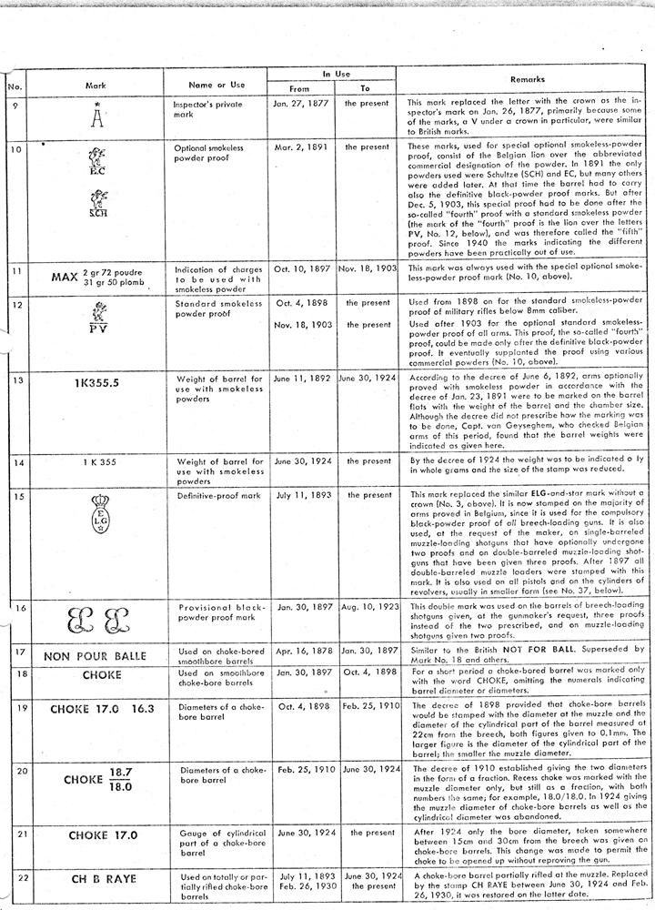

Default Liege Proof Marks

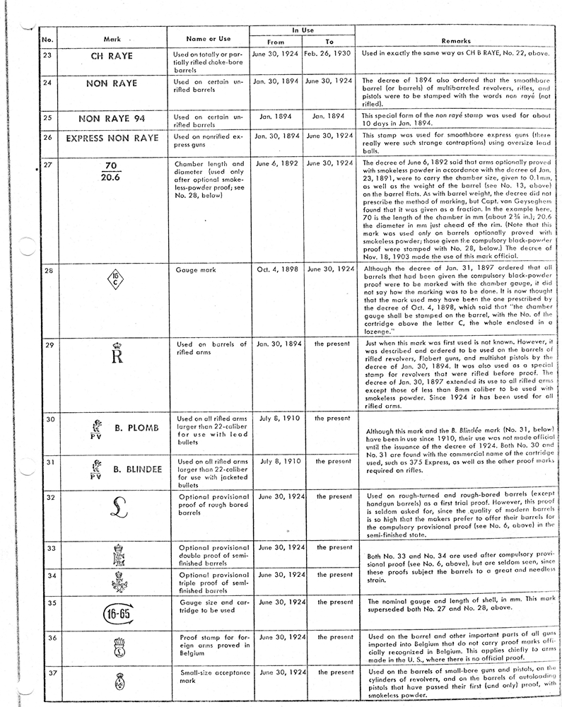

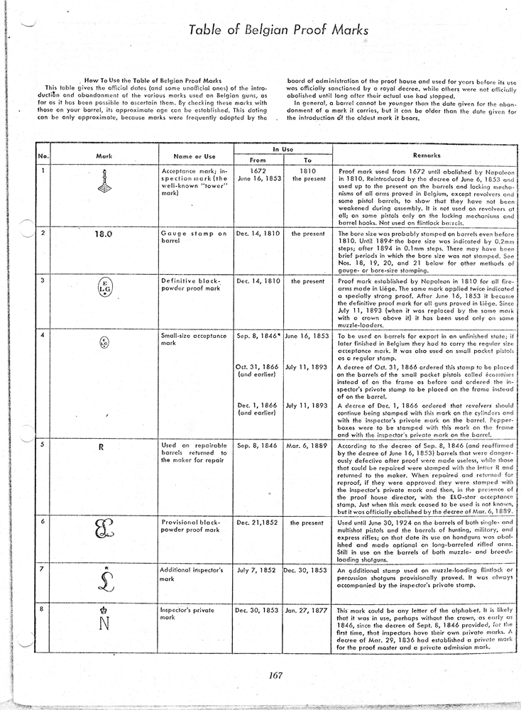

Though not directly on the subject of Rick's pistol, here are the Liege Proof Marks discussed above, and details/dates when used.

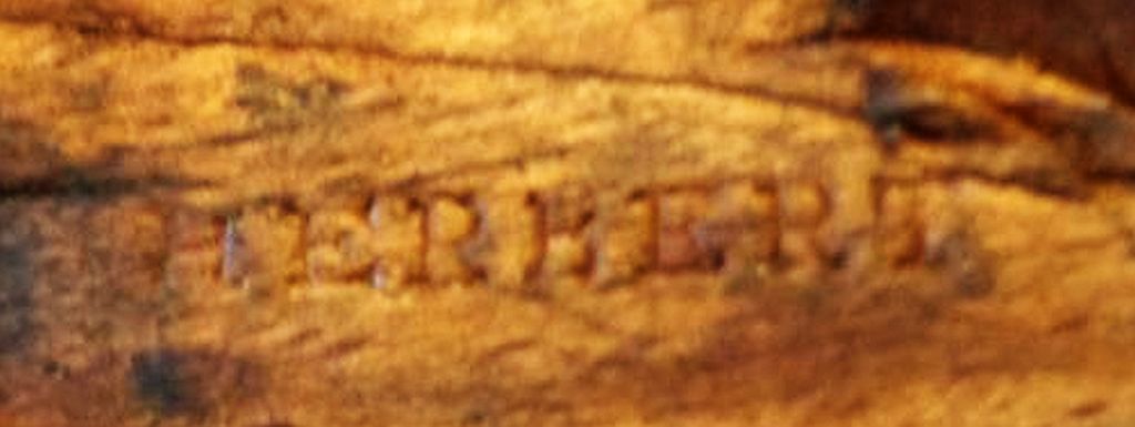

As an aside, I personally do not believe that the word HERBERT inside the lock mortice has anything to do with Liege, or is in fact a "makers" name, so it remains a mystery.
Stu

Thanks very much Stu, I couldn't find any useful list of these marks as my gun resources are limited. Very much appreciated.
Perhaps you are right on the HERBERT name inside, it probably has nothing to do with Liege......I think we are all agreed this is far too crudely marked for any possible Irish (British) production...….and for that matter, Liege work is far crisper etc.
The lettering on this is so clumsy, and as Corrado has noted, the broad arrow is absent. With the British proof marks, Afghans often used old components so it could be authentic old barrel.

.........and you really belief that this "HERBERT" written in a letter type like Times New Roman has been made in an Afghan backyard shop?

It is well known that the different parts of firearms were made by different specialized smiths, in their own shops and then sent to assembly.
Before mechanization systems were implemented, manual output had (slight) measurement variations, the various parts of an assembly having to be "fine tuned", i.e., adjusted to accomodate their specific partner. It is expectable that the stock, being the softer part, had to be adjusted to its barrel ... and lock. This system is evidentiated by the cuts we can see in this stock mortise; it would be no surprise to find the same number of cuts underneath its chosen barrel*, if still being the case ... as also inside the lock plate.
I do not see why Mr. Herbert was not the head of the Liegeoise workshop where this stock came from

Though not directly on the subject of Rick's pistol, here are the Liege Proof Marks discussed above, and details/dates when used...
As we may see Stu, the only existing mark before Napoleon was the Tower symbol, which he abolished, only being restored in 1853; notwithstanding that, as i have once read, the guns trade in such earlier period not being strictly controlled, many smiths didn't care to send their pieces for approval;whether because of proof testing costs or other reasons, i don't recall. But i certainly know that many a gun made in Liege in the XVIII century, had no marks at all, as per this fine example i once owned.

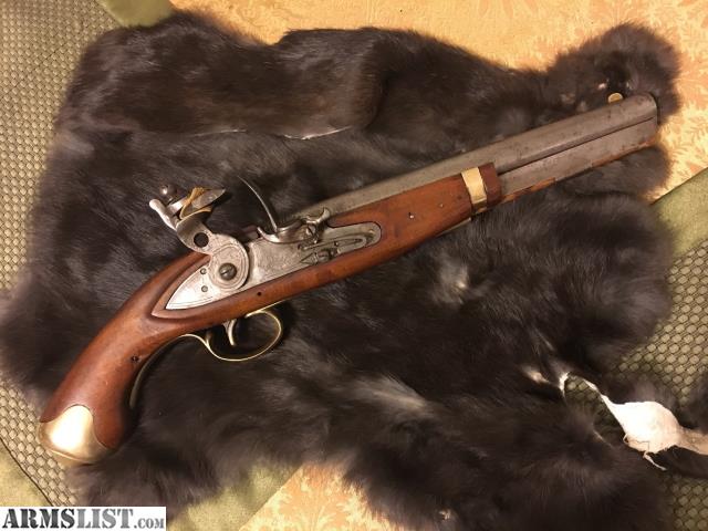

As far as I can see, all pistols in the fotos above are made in a typical British style of the East India Company and like these originals have their mounts made of cast brass which are much easierly to produce than iron mounts that have to be forged.
Quite obviously the pistol in question has except the lock and the barrel nothing British, neither the stock nor the mounts, so - and this is my last reply- why should this piece have been made in Afghanistan?
