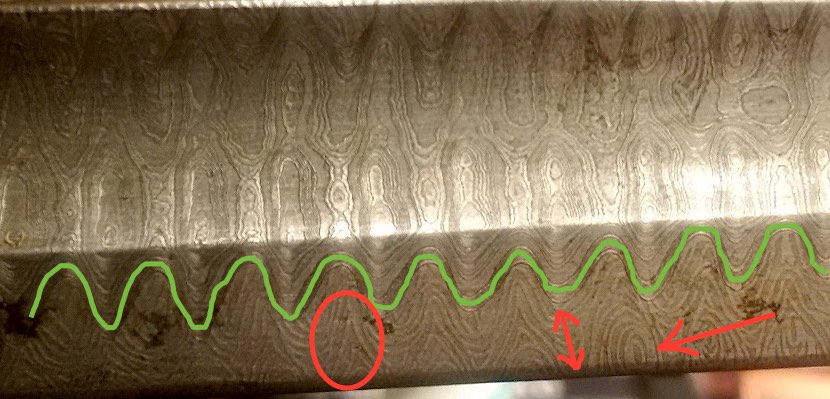

... The other term seems to say that the blade is from real Damascus also when I would agree with you, it look like "fake" Damascus. But the term say clear "real Damascus"! ...
I can see why Jim and Detlef saw the pattern as being acid etch, i.e. artificial surface applied. May I question this? Having some resemblance to wax resist method, it lacks the details that such method would produce due to application of a template that results in sequential repeats in the pattern. I do not see such repeats, nor the template being used here. To me this indicates true mechanical Damascus, in line with such stated description on the blade. Is there another resist method that could be used to yield a random pattern, etc?
Old 11th January 2017, 06:37 PM   #16
Posts: 9,771
Alex,
now I am very sure to see real pattern welding and I am not surprised about this. It's not only a identification by seeing but also a matter of feeling. I am sure that the blade is pattern welded. Roland could be a candidate to tell more about this.
Old 11th January 2017, 07:14 PM   #17
Lightbulb
Hello Alex,
The upper part of the blade is clearly pattern-welded: the darker sigmoid pattern (my added green line) is the lowest pw part.
The pattern below this line is clearly faux in my book: despite trying to look like pattern-welding, it is quite erratic and just doesn't make sense from a blacksmith POV (I have indicated a few of the more obvious areas that look problematic. I believe this was done to also decorate the inserted edge en suite with a similar pattern.
I reckon not many lay people will recognize this trick; I believe the etched pattern (or rather the wax) was drawn by hand - a technique also utilized in other regions of the world (in varying quality).
