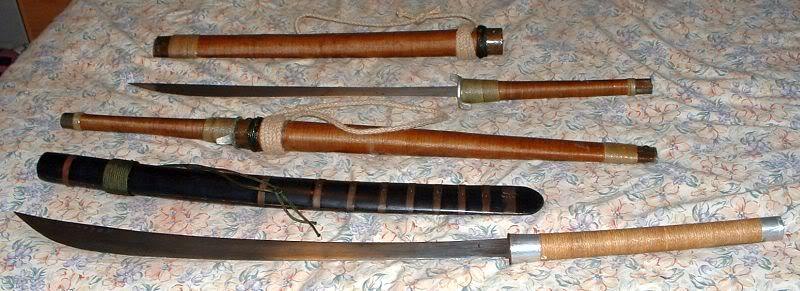

i have two krabi krabong dancing swords with string wrapped scabbards and grips. sadly sheet steel blades. they are the equivalent of chinese practice wushu dao.
if you youtube, look up krabi krabong for an idea on how they were used.
my string wound 'dancers' - 2 at top. the lower one is a late 20th c. one for those who travel, but has a good distal tapered & tempered blade & individually braided rattan rings on the grip.
