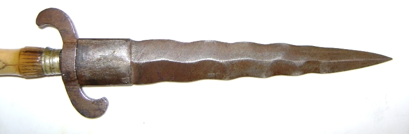

Apart from two handers and rapiers, as well mentioned by Jim, you can/could see these wavy blades in cup hilted swords (Portuguese included), whore daggers and even hunting (plug) bayonets.
