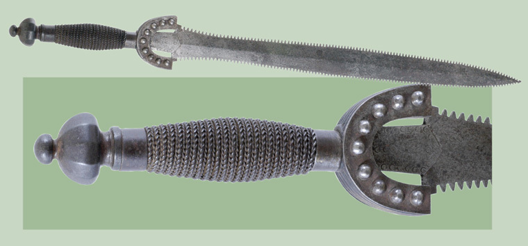

The leather-covered guard is old, and the wide, flat, and sharp blade as you said , which shows clearly some age and is made of quality steel, reminds me of my 16th-century Italian sword/storta.
See my previous post: Strange blade on Italian(?) old sword
Is it a short sword or long sword?
The hilt, even though it looks like a Viking/Norman or Celtic type, reminds me of certain long cinquedeas from the same period, 1500-1600. Clearly, the leaf-shaped blade is anachronistic. Perhaps it was a special order with a beautiful medieval pommel. What is the sword's length and weight, by the way?

Old 5th February 2026, 03:17 PM   #30
Almonzo
Join Date: Jan 2026
Posts: 16
I am not a swordsman but I think that for protection we need a shield as in the illustrations
of these large small swords without guards.
Better use a gauntlet too
If handling the handle in defence position with two hands,
it makes a small guard and the shape of the end of the blade must deflect a little an attack.
Do viking swords with small guards and japanese katanas offer a better hand protection ?
