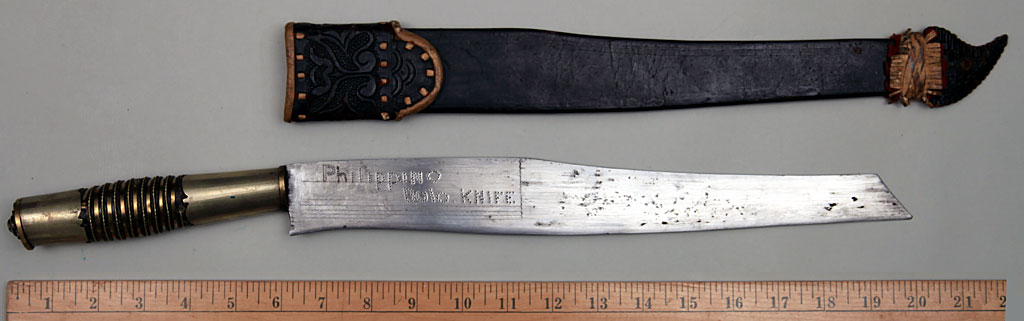

I was at a gun show here in Minnesota a couple of weeks ago and came across another example of this sword form. This one has a horn grip with brass ferrules, and the blade has the usual "Negrito katana" shape. The photograph shows the "as found" state of this one, with a heavily patinated blade. I would say probably mid-20th C. Could be Ilocano or Pampangan in manufacture--the hilt on this one looks more Tagalog than Ilocano in style.
For clarity sake, what for you makes the hilt more Tagalog than Ilocano?
