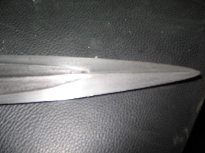

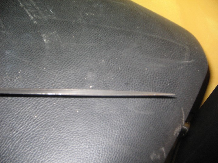

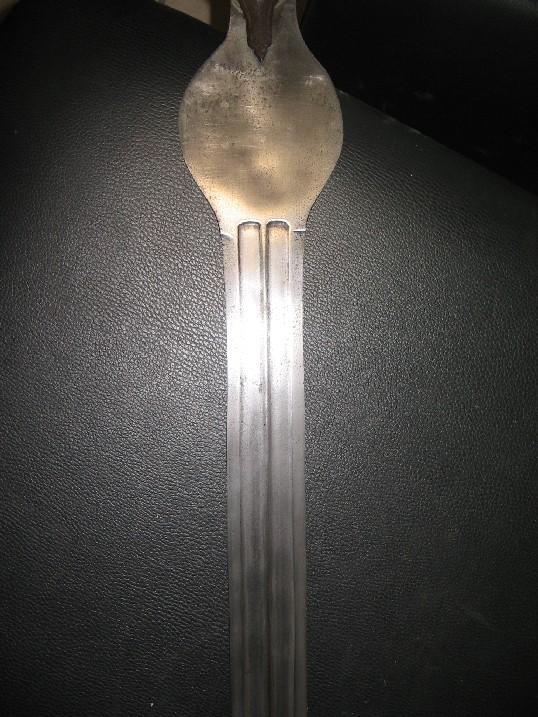

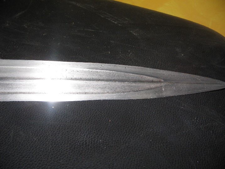

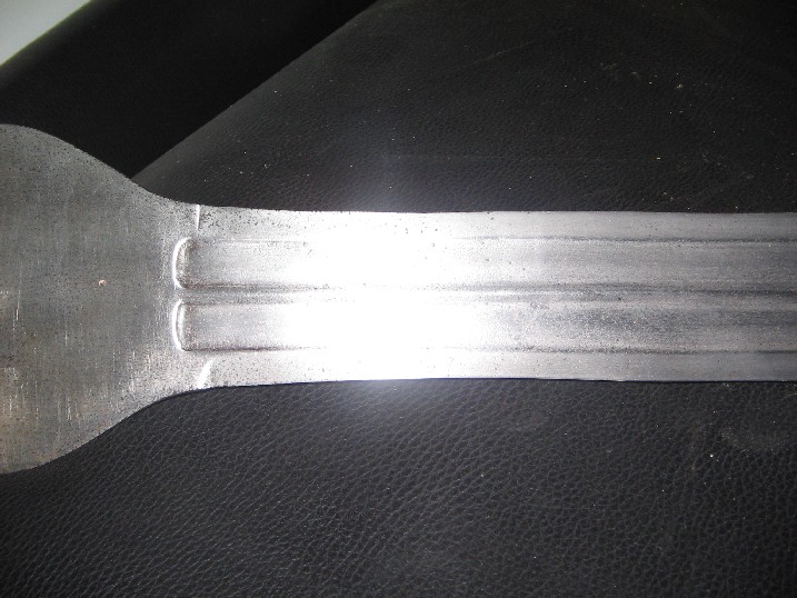

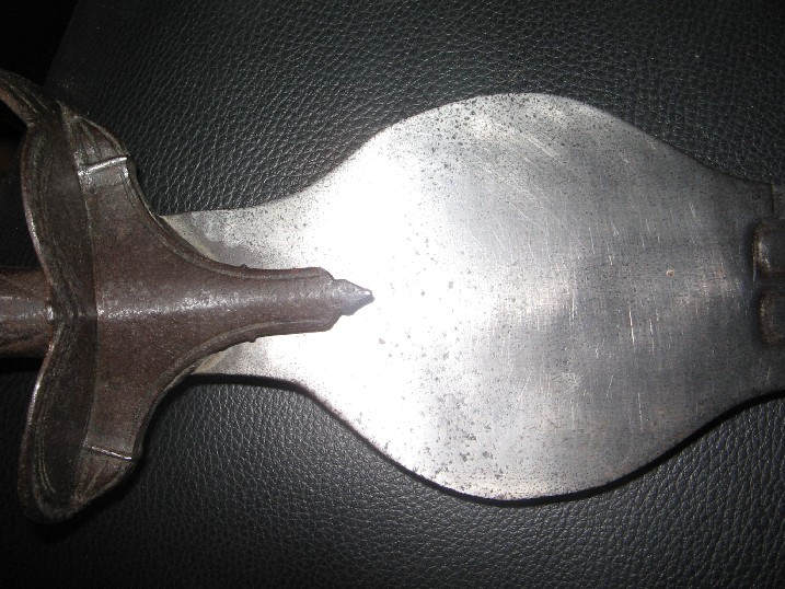

i will show you also an other intresting sword from me. it is an pahari sword ore sometime also as an cobra sword known.
intresting for me was that it is mounted with an khanda basket hilt. as usual these sword was mounted with an pouluar hilt. an similar sword you can see in the book from g.n. pant. indian arms an armour vol.2 plate CXIV.
there was such an sword with an khanda hilt descr. as an 16.th.ct. sword from utar pradesh. in hindu arms and ritual you can also see such an pahari sword but only with an pouluar hilt from the end of the 18.th. ct. i think these sword was made as an realy fighting weapon. the blade is stought, with an strong point.the lenght over all is 93cm, the blade is 76cm, wide before the bulged 5cm and the diameter from teh bulged is 10cm.
i know not much over the history from these word. i donīt also know how old is it. i think it isnīt from the 19.th ct. the most pahari swords iīve seen before was from these time, but i think the mounted hilt is older and i think it is in the original condition. the glue between the hilt and the blade shows very old an original. what think you over these sword? i hope someone can tell me more!!

i forgot to tell , i canīt found any pattern from watered steel at the blade. i think it is "only" steel. i proof it if it is wotz ore also if it is welded damscus steel.

Isn't it called Pahari? Very nice, just a pity that it was so overcleaned. I suspect there were lavish decorations on the "hood" part of the "cobra", but these were wiped out.
Always a tough decision whether to remove the rust and patina to a "high gloss" or not....

hi ariel
yes i have cleaned it, so i have also removed the old " patina" under these patination was also small rustparts. you can see the pittings at the blade. at one small part from the blade are these rustpittings very deep. i hope it is stoped now. the next reason was, i hoped that these sword like all older weapons from india was made from watered steel and i would like see these pattern at the surface. there was not any decoration at the bulbus before the cleaning. i know the newer cobra swords was rich overlaid with gold koftgari but i think these swords are not made for fighting. i think these swords was only made for representation.

Now I recall these swords Stefan, from discussions last January...you have got an incredible grouping of very important Indian swords there!!! These two interesting examples with the so called 'cobra' blades, one with Hindu basket hilt and the other with Deccani hilt with Afghan paluoar type pommel, are truly anomalies, as discussed in both Elgood and Pant.
Actually the discs at the blade root are not nagan representations, but symbolize the chakra or mandala. As Elgood discusses (p.240) the association with Vishnu in the Sangam age established this symbolism as that of the right to rule, and as an element of these weapons, most likely as you note, ceremonial or court weapons. It is noted further that the Sanskrit word for swords incorporating the chakra is 'ardhachakrakrpana' and as such these are symbols of the chakravartia, or universal king.
The term 'pahaari' is actually a linguistic term, in Hindi, Urdu and Punjabi, referring to the language of the 'mountain people' covering regions from Nepal in the east, to Himachal Pradesh in the west, and one of the regions suggested as possibly that of provenance of these distinct swords. I believe this may be the source for the pahari term referring to these (which is certainly much easier to use in description than that other one!!
Elgood ("Hindu Arms & Ritual", 2004, p.121) notes that in the Vijayanagara state, at its zenith in the 16th century, the Adil Shahi kings saw themselves as Chakravartins, which may of course signify the tradition behind these very symbolic weapons. It is noted also that Pathan nawabs established a subordinate state to Hyderabad in Kurnool (situated in Andhra Pradesh).
The two chakra bladed examples in your collection seem to be of 19th century, though Elgood discusses 17th century example from Bijapur, and notes these are typically catalogued as 19th century in museum references. The blades are both similar in the Vijayanagaran style , with the hilts of course different, one with what appears an 18th century khanda example, the Deccani hilt one (strikingly similar to the one in Elgood, 11.17, p.121) of latter 18th century? The use of wootz in Indian blades in the 19th century virtually ended, especially with Indian government forbidding production of wootz in 1866 in the Western Ghats. It is unclear whether certain centers may have continued, such as Sirohi (in Rajasthan) where heavy watered steel blades of Persian form were made.
