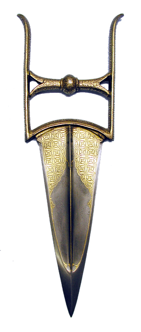

Have a look at the attached katar, I have always thought it was north Deccan, but maybe I have been wrong – you will see the reason for the ‘maybe’ when you look at the coin.
The coin – front and backside – is from Nawanagar (gar means fort) located on the Kathiswar peninsula, west-central India, in Kutch. The coin is a 3 Dakda (whatever that is) and dated 1928 VS – 1871 AD. The katar is not used as a mintmark, but as an emblem (a mark of the state), which, of course, is far more powerful than a mintmark.

Excellent example Jens!
As I recall, the item in Egerton (p.137) describing the Kattees of Gujerat (in Kathiawar) where the mark of the katar was revered and considered the seal of an oath or agreement. Its significance is noted in that signatures in these matters often included the mark of the katar. It would seem that that same mark would be included on legal tender, thus the image of this distinct form with flayed ends on the guard bars suggests probable provenance.
Thank you posting this beautiful katar along with the coin.

It should be noted, that although most of the place where the coins were used, also minted the coins – but it was not always so. This means that to go after the mintmark could be misleading, whereas an emblem was used by the state where the coins were used.
The following states used a katar as an emblem on all, or some of the coins. Bundi, Kutch, Nawanagar and Ratlam.
The following states used a katar as a mintmark for all or some of the coins. Shahjehanabad (minted in Agra), Bharatpur, Bindraban, Nabha, Marwar, Jodhpur (minted in Sujat) and Karauli.
There could be a few more, but this should give someone interested something to work on.

Very good point Jens. Much like the weapons being produced in varying locations , the locations of actual minting were not necessarily the location where the product was used. Thank you for noting the coins using the katar as a mark....reminds me of the great photos of Nepalese coins with kukris on them that Spiral shared in a previous thread.
BTW, the shape of this katar hilt looks very much like the 'garsoe' katar in Egerton (#727 I think).
