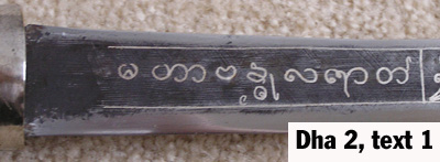

Mark
Mark's Avatar
Posts: 987
Here is the second. It is a modern, with fairly crude decoration. The same text appears at the forte on both sides of the blade.

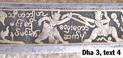

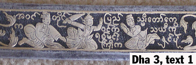

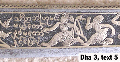

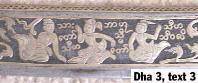

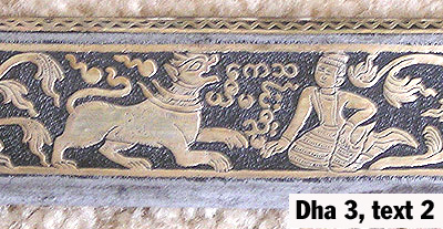

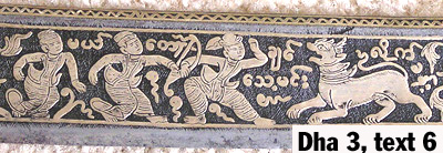

Posts: 987
And here is the third. It does not have clear "introductory" panels, so I'm posting all of the text. For now I am only interested in knowing the name of the story being shown, if you can tell from the text.
Thanks in advance!

Dha 2 Text 1
Maha Bandoola Zat
Play / Tale of Maha Bandoola
http://www.myanmars.net/myanmar-hist...a-bandoola.htm
Dha 3
The last story involves Thiha Bahu Min ( King ) and a couple of princesses as well as a Nat Min . Sorry don't know the story it refers to
Hope that helps .
