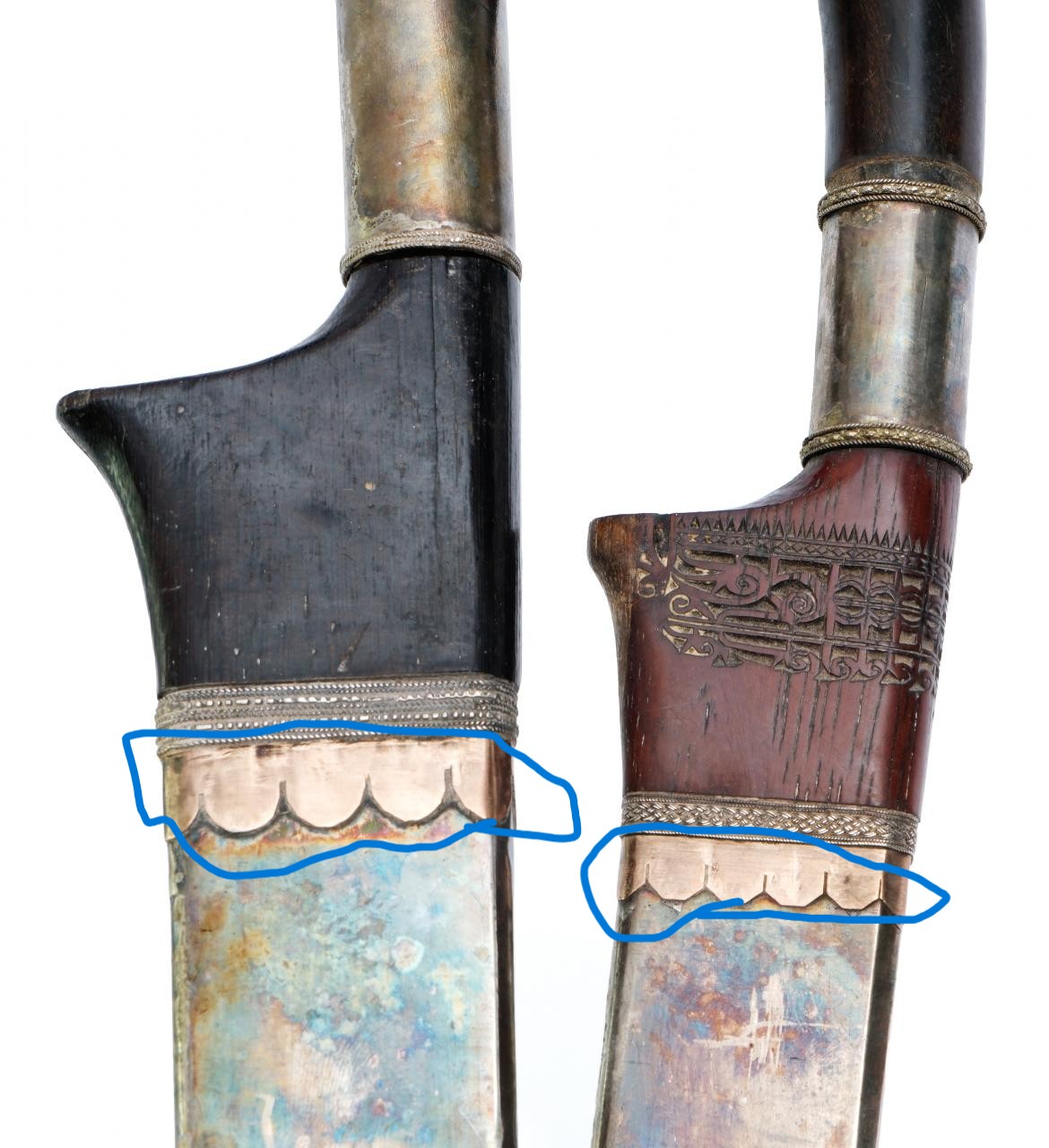

I personally would clean the silver to shiny but Batak silver is good silver which soon gets dark again. There is also a little bit of suassa involved, I've marked it on the attached picture.
And yes, I would clean the blades but these blades don't show any lamination.
Karo Batak kalasans are not extremely rare weapons but they are somewhat rare in the quality you got in your two examples, I like them!
And the hilts are of the sukul djering form.

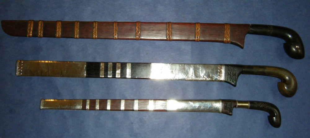

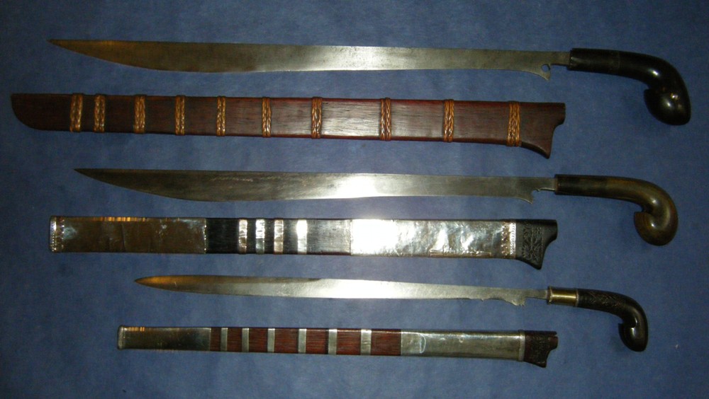

Here are some more Karo Kalasan from old threads for comparison.
