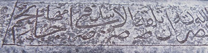

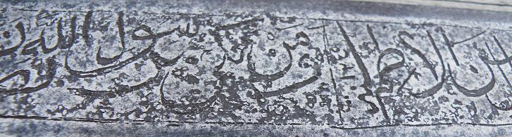

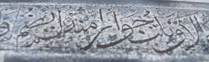

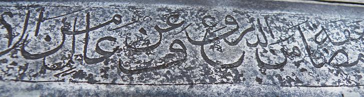

Hi
Could someone kindly assist in translating the Arabic on this kaskara. Its on both sides of the blade, but proved tricky to photograph. Hope it can be made out OK. I've added a couple of detail shots for those forumites who like kaskaras.
Thanks in advance....

Hey Colin,
I'll try to decipher this later tonight or tommorow, but the pictures could be better.
Just a random observation, but the script is not the usual found in Sudanese item.. I think this blade is pretty old.

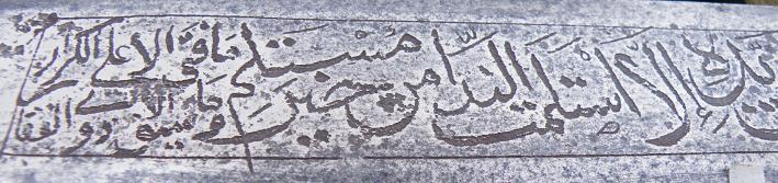

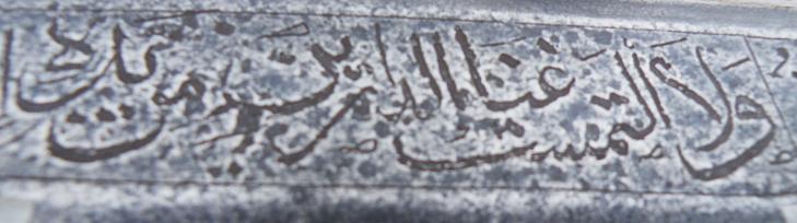

Here are the other two pics from the duplicate thread.
Hi Colin
unfortunately, the text written with the aphabet Arabic, should be in Sudanese dialect
unreadable, for an Arabic speaker of Arabic classic language,
you must found a Sudanese able to read his dialectal language
despite this, it has been determined, that it was a poem,
the translation is roughly impossible excepted some words related to religious invocations, as well as
"Rasul Allah" either "God's Prophet" ... "Allah" either "God"
absolutely sorry

Hi Dom
Thanks anyway for your efforts on translation. Any Sudanese in the forum ?
Glad the kaskara has produced so much interest - its a thick, heavy old blade, with beautiful script. Might be native made ? but difficult to say 100% (refer my previous posts on this subject). The engravings of the lion, orb and script may have been by the same hand. The crossguard probably forged.
Regards.

Hello guys,
Sorry its taking me a while to translate this. I am busy with my mid terms so studying and other stuff are taking my time. Promise to translate what I can once am free :-)
Old 17th November 2011, 09:10 AM   #10
A.alnakkas
A.alnakkas's Avatar
Join Date: Nov 2010
Location: Kuwait
Posts: 1,340
I think its a poem by doing a superficial reading.
It also contains a reference to Imam Ali (La fata ella Ali Alkaraar, wa la saif ela thul Fiqar.) The interesting part about this reference is that it contains Alkaraar, which is a title to Imam Ali that means: the Slayer. I never seen it on a blade :-)
Edit: interesting find is that the Imam Ali reference has a grammatical mistake, replacing La with Ma (Ma fata ella Ali.. wa ma saif ela thul fiqar).. its strange how the scribe will make such a mistake while writing a poem.. hmm
More later

Default Asadullah - Lion of Allah
...could the quite calligraphic lion refer to Ali?

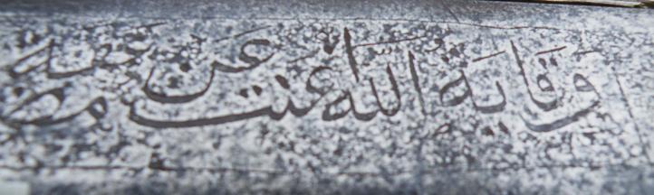

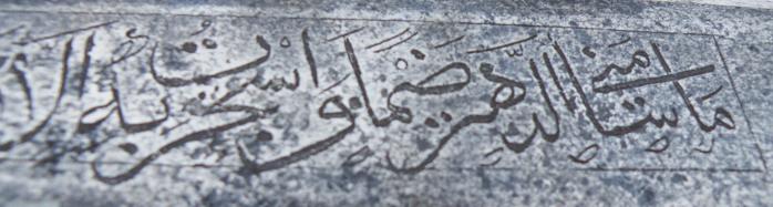

Here are a fresh set of images of the script....
