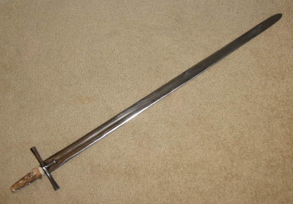

It took me a while until I got my first kaskara (or Sudanese sa'yf, but kaskara i easier and everyone knows what I mean). It is long, about 40 inches in length in total.
I hope it is an antique sword as it does not strike me as anything intended to be a souvenir. I think the blade is a locally forged one and aimed at imitating German trade blades. I was intrigued by the "wolf" marking. As you can see, it is very rough, just like the markings on the other side of the blade. My guess is that the latter are illegible and a translation would be impossible to obtain.

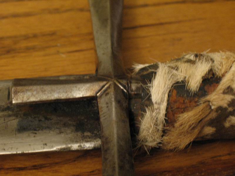

The crossguard is steel and quite massive. I have taken a picture of how it has four langets, with the one running parallel to the hilt tucked inside the hilt wrapping, as I remembered an old thread in which there was a discussion about this.

This is what I would consider a classic example of kaskara (and thank you for noting the correct term sa'if, as discussed for years from Darfur. It seems one of the key identifiers of Darfur examples is the raised cross at the juncture of quillons and langets, seen in examples in "Kaskara from Northern Darfur, Sudan" (Graham Reed, JAAS, Vol. XII, #3, March 1987). In example LII, an example with this distinct cross on the guard, and the blade has a similar central fuller, with the 'running wolf' with it noted that it is likely German trade blade of 18th century. I think your example may well be one of the Solingen blades but not sure if that early, and although even the German interpretations of the wolf are primitive looking, these seem shallower and possibly native added.

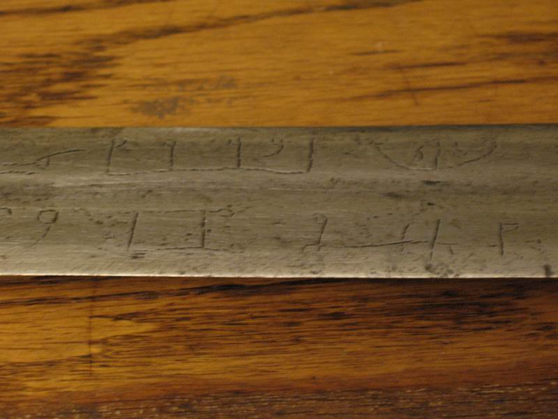

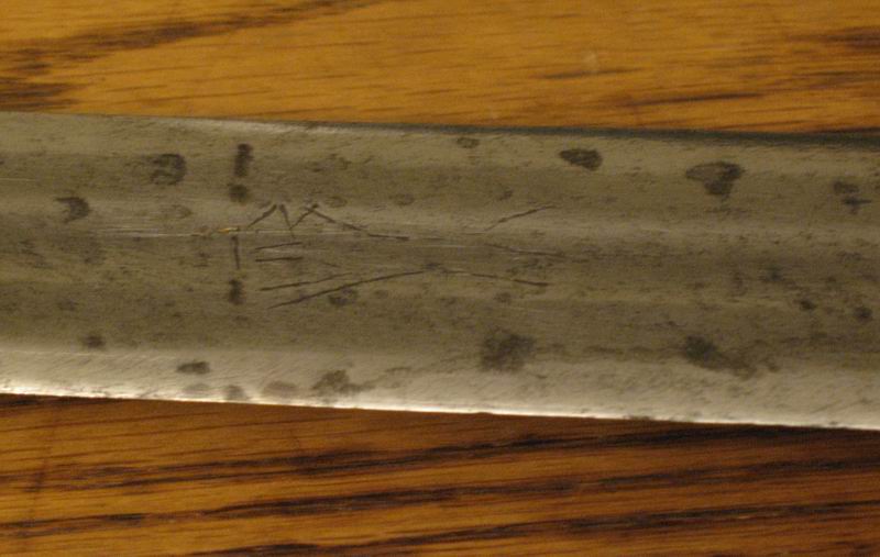

The interesting inscribing on the opposite side of the blade is not likely to represent writing of any kind, but seems to correspond with the almost runic, stick type characters often seen in the figures used as camel brands in these regions (see works by H.A.MacMichael on the Sudan and Kordofan in 1913 and 1922). I cannot say what these groupings of symbolic figures would signify, but simply supports native application, and seems contemporary with the wolf marking.
The hilt is of course missing the disc pommel, and the wood grip is covered as noted, with animal hide, most likely goat. In Reed (op.cit. p.168) it is mentioned that scabbards were often of goat skin stained red or brown. On most of the Darfur hilts I have seen they typically have some element of crocodile hide, but since goat hide was so prevalently used, it seems that it would not be unlikely to have had the grip covered in this material.
The kaskara remains a prominant symbol of prestige among the Fur in Darfur, and it is not surprising to see these refurbished many times through the years. This blade has some potential with what appears to be distinct aging under the langet, and seems to have been cleaned with components intact.
It is quite possible for this to be a native forged blade, but has strong possibility it may be German trade of 19th century.
Congratulations Teodor! Well done for your first example!!
All best regards,

interesting sword, the first I have seen with a 'fur' handle. The 'X' detail on the crossguard where it meets the langets is another thing I have not seen before....a nice 'touch'.

David's observation on one of the markings with cemi-circular shape is interesting, and I was wondering the same thing. However, are there any other instances, in which laf-moon symbols co-exist with "running wolf" symbols on the same blade?

Kaskara blades were often locally marked / etched .... copying earlier markings seen on European blades. I have seen blades etched/chiselled with sun,star and the half moon symbols (which seemed to be original to the blade) with a snake (added later) design running down the fuller with Arabic script.
In essence the locals viewed the markings on the 'imported' blades as talismatic, a sign of quality......or both. So differing combinations of these symbols 'co-exist' on the same blade.

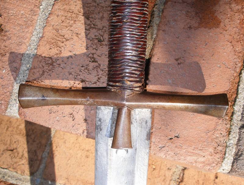

Another X guard .
Thanks for pinning down the area Jim .

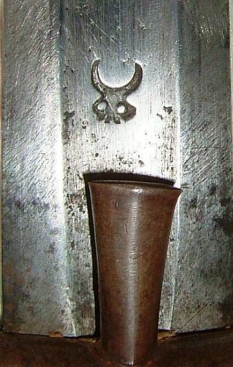

On this one it looks like there is a stamped mark under the langet, can you get a shot of it? If its what I think it is I mad have more info.

I think we may have traveled this road Jim, but if you've got some new ideas I am definitely all ears !
Teodor, could the markings be talismanic in nature ?
There seems to be a similarity to some I have seen elsewhere .

Rick, we have indeed been down that road, and many others!! I am thinking that the mark I see may be close to one with circle and horns which I have been working on for a reeeallllyyy, long time! What is interesting is that these marks are stamped, near the forte, and they may be armoury marks...not makers marks.
All best regards,
Rick...we crossed posts, thank you for posting this. Yup....thats the mark OK. On the example I was researching, which was a very high quality kaskara, silver mounted with typical crocodile hide grip (similar to examples seen on the article by Reed) , it was suggested this sword was possibly from a very important armoury.

This stamp is definitely not a partial one .

As for the "running wolf" I think it is just a proof of quality, imitating similar marks found on earlier trade blades. Considering it is a living thing, I doubt it had any sort of symbolism among the Muslims in Sudan.
I think you could be right about the markings on the other side of the blade though. It is quite likely that they may have had some protective properties to the original owner of the sword, perhaps in the "warding off evil" variety. Jim mentioned "camel branding" and another possibility is their use as armory marks. I think a talismanic meaning is more likely though.
