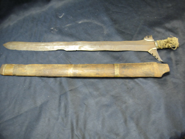

I just got a kris from the bay. I had been looking for one but prices have gone up the last couple of months. This one was cheap and although it is quite battered it looks like it has lots of character.
It is 25.5" overall with a 22" blade. From the sellers pics it looks like the blade is reasonably thick at the base and the ricikan are in the round, not just cut out in proifile like some of the apparently newer pieces. I don't see any sign of a separate gonjo so perhaps it is post-1930.

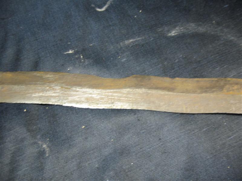

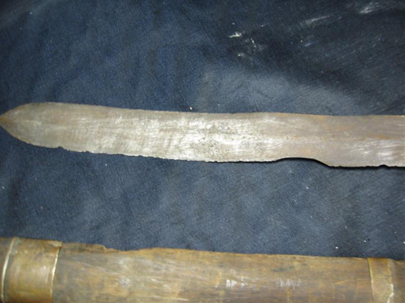

The ricikan appear intact and the baca-baca are both in place. The blade has several nicks - one of which is quite large - towards the upper 1/3, but what's strange is that they are on what would be the back edge of the sword.

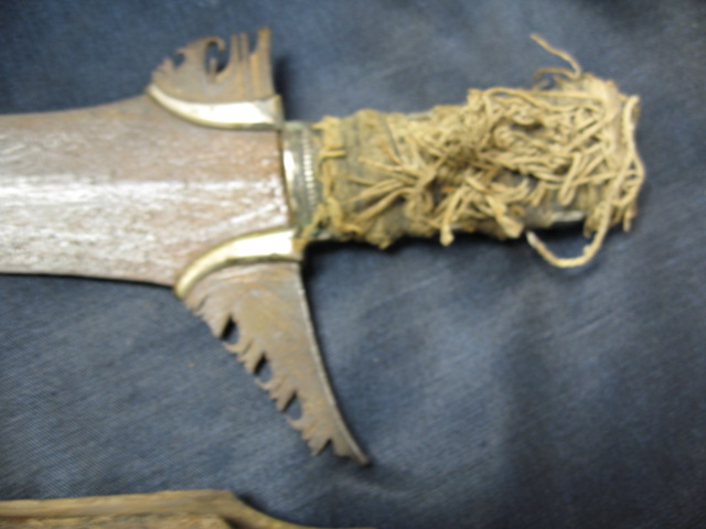

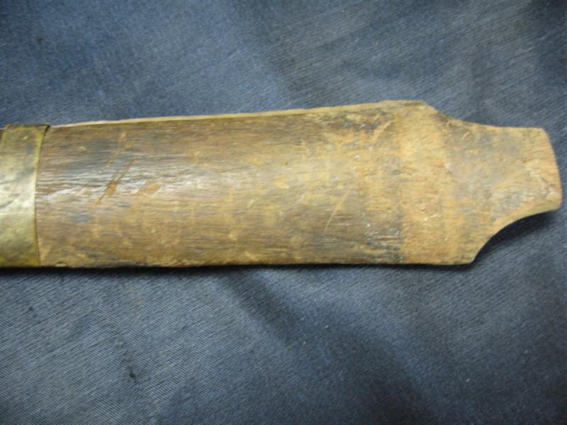

The hilt seems to be in shambles and will require some work. The scabbard has seen better days but only two brass rings are missing, and it is serviceable.
I'm thinking this'll be a fun restoration project.
Comments and thoughts of any kind would be most appreciated.

Hello Emanuel,
I certainly think this is a very nice restoration project.
Remove the baca-baca and the hilt. You can remove the rust with vinegar and give the blade an etch with it. That can give quite a surprise.
Clean the scabbard and polish it with a cloth and oil. Replace the missing brass rings and rewind the hilt with new strings of cloth. Looking to your pictures the original cover of the hilt is cloth. Maybe some more knowledgeable members can give you a better advice. But I would do it in this way.
Nice project, you will be bussy this winter.

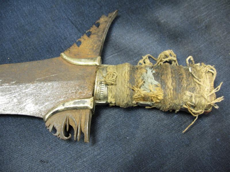

You'll also have to carve a new pommel (now missing).

Maybe Kai is right and you need to carve a new pommel. The hilt does look a bit tiny on the picture comparing to the blade. On the other hand, I have a moro kris with such a hiltshape that is covered with woven ratan bands. The lengt of that hilt fits exactly in my hand.

Hello Emanuel,
Could you show a pic of the end of the hilt?
Do you have any indication as to which tribe this kris might be?
The scabbard is typical for Maguindanao. The blade may be Sulu (not sure since the pics are taken at an angle). Obviously, many Sulu blades got traded and ended up in Maguindanao fittings.
Kai, which type of pommel do you think would be more appropriate, a cocatua or a horse hoof.
I think that depends on you: Since any kris is an unique piece, the owner decides what he likes best (and can afford or is allowed to wear by tradition).
I'd guess that this kris used to have a kakatua pommel (bent asang-asang extensions, size and form of grip) and that also would be probably the most often seen hilt type. There are several kakatua varieties associated with Maguindanao pieces though.
The hilt Henk showed is also very commonly seen with Maguindanao kris; it's also the most easiest to reproduce. You can probably live with just carving the end piece and fitting it to the present grip. The braided/woven jute seems to be beyond rescue. (Make sure to store the remains for future reference though!)
Since trade was extensive you could choose just about any Moro kris hilt type and go with it but I'd probably avoid more localized types like typical Sulu horse hoof pommel, etc.

Kai, I have not received the kris yet, but I will take and post new pics as soon as I get it. If the hilt has a recessed part on the end to fit a pommel into then I will likely carve a new one. Otherwise I don't wuite know how I would attach the pommel - gluing it is not an attractive option. If it is just flat like Henk's then I may just leave it and redo the cloth wrapping.
