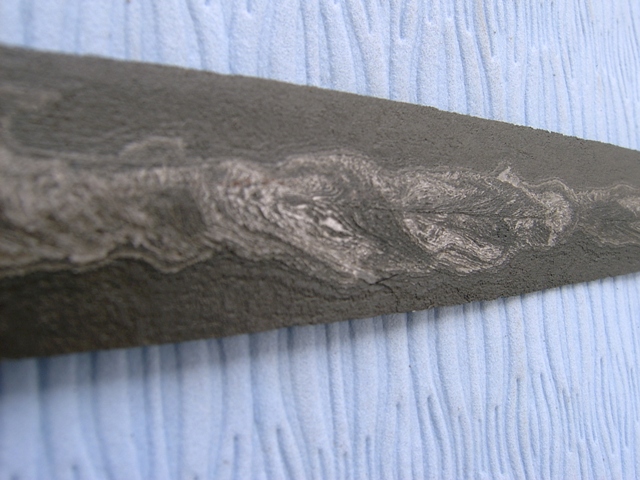

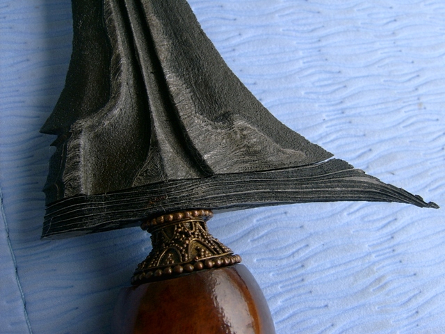

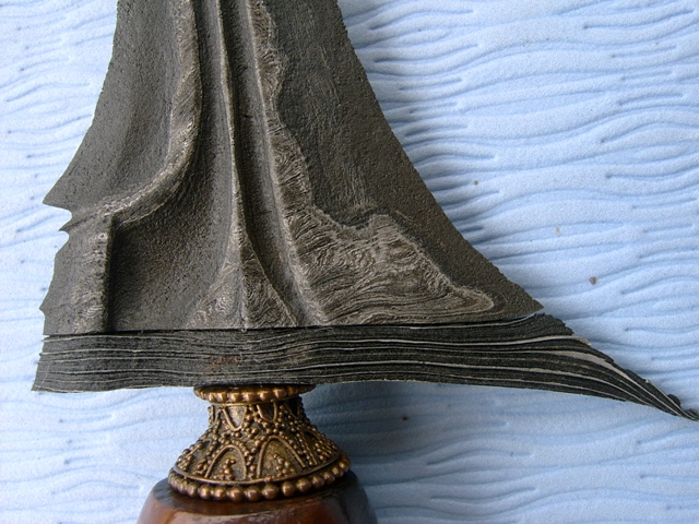

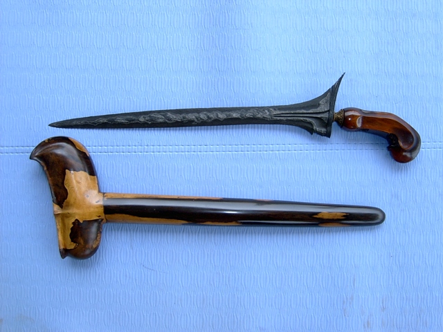

This keris is mine. the reason I bought this keris is for the timoho warangka and the nice dapur. seem to be in good shape.
I consider the dapur to be PASOPATI... I have no idea about the PAMOR.
I really have a bad feeling about the dapur. it might have been changed.
there for I really need your you opinion.
FERRY

Any specific reason why you thought the dapor had been changed or modified? The keris looks very fine to me, and I like it very much also

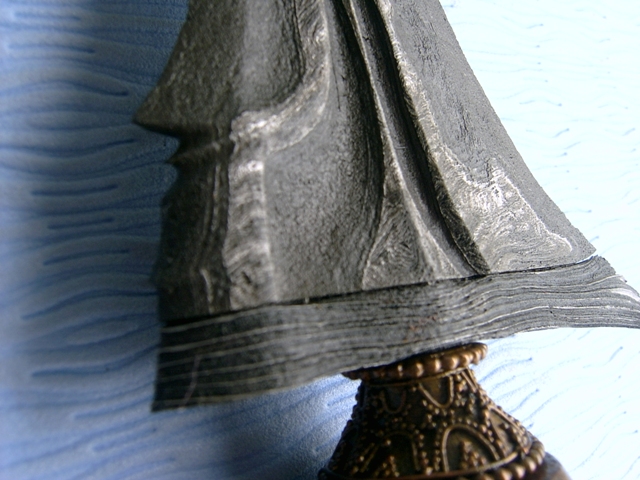

a pasopati dapur usually has greneng and mine doesnt.
take a look at the ganja, buntut urang section, it might have greneng once.
From all keris pictures I've ever seen, keris with dapur pasopati always shows greneng.

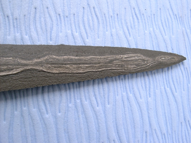

How do you think about the pamor? what kind of pamor is it?
the pamor seen obvious in the centre of the blade, but thats all . not evidence of pamor on other section.

Like you said Ferry, your pasopati used to have greneng though in your case I can see less significant one. Couldnt it be because years of washing? Judging from the steel - it looks old. Some say Pasopati was created during Kadewatan period which is older than Keris Buda...... Though your example definitely younger creation, IMHO, it has some age to it....I cant comment on the pamor that I've never seen before...

the pamor on the sor soran section shows a very smooth pamor which I ever seen on lar gangsir pamor. If the greneng was dissappear because of years of washing, the blade it self should be damage also.
Does the fracture between greneng and the warangka can cause the greneng become damage? we're talking abaut wooden warangka here.
I guess we can conclude that this keris have pamor that we cant mention what it is. I'm still curious abaut its pamor.

I've lifted your full length blade pic and massaged it through Photoshop, but I'm sorry, I just cannot see enough detail to have a guess at the pamor.
In my opinion, and based upon what I can see in the photo, this is an old blade that has had the edges cleaned up, and has been reshaped.
Some people regard this as an undesirable practice, however, done skilfully, I do not. If an old blade is worth preserving, and this one is worth preserving, this is one way of ensuring its preservation. OK, its not a national treasure, but it is decent old blade, providing a shadow of its former self. There are two things you can do with a very deteriorated blade such as this one was:- you can clean it, stain it, oil it, put it in sandang walikat and effectively retire it, or you can clean up the edges, reshape it, and make it fit for use as a keris to be worn as an item of dress.
The wrongko is beautiful, and this type of wrongko is not seen all that often---its scarce.
The handle would be better replaced with an East Jawa one.
All in all, I reckon this is a pretty fair sort of keris.

I read the book "keris jawa antara mistik dan nalar" by Mr Haryono last night. I think that pamor type is " SEKAR GLAGAH" . its very similar tho.
Abaut the warangka, this timoho warangka is indeed a scarce wood. as you can see it is just too big and too thick for the keris. I have a plan to give it a new cendana wangi Surakarta Gayaman. It is a reshape keris, people from Surakarta allow to re shape kerises. There is a friend of mine manage to supply me with some cendana wangi gayaman. the trouble is on the hilt. Tayuman wood are very very scarce , and if I find one, the price I have to pay will be high.
