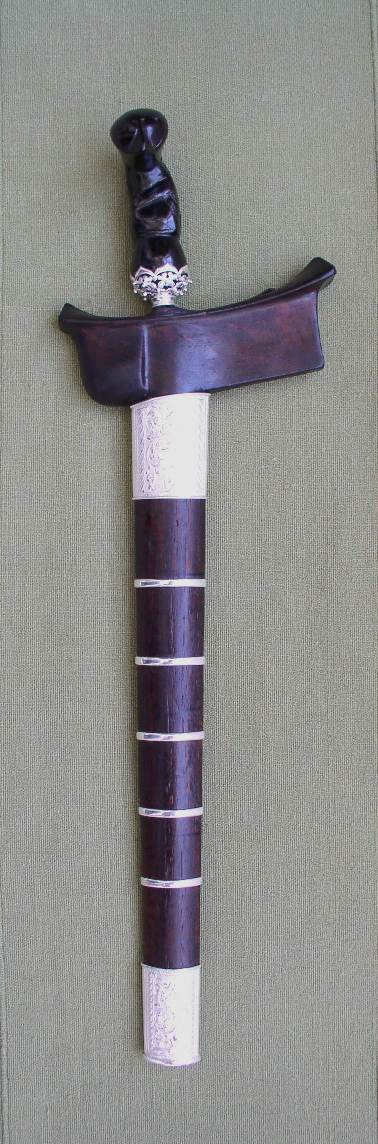

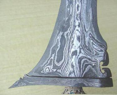

Default Is this a Javanese keris blade?

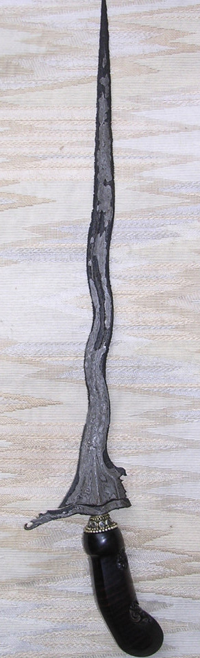

Is this a Javanese keris blade? And why?

Hi BluErf,
You posted a Javanese keris, called Megantara Luk 5.
(Ensiklopedia Keris p:288)
It is an exotic keris. The Dapur keris like that is so rare. Many kind of Keris with Dapor like this, can be luk 5, 7 or 9. But it have a special characteristic ; the Luk just at bottom (Jawa : Sorsoran) to midle blade, and from midle to the top of blade (Jawa : Pucuk) made a stright.
Looks like made from Majapahit or mataram Senopaten period, I think .
The pamor looks like a Wos Wutah.

I don't think its a megantara. That's supposed to have 7 luks isnt it? Plus, isn't it supposed to have a kembang kacang or pogok? It doesn't have the central fuller. This keris has a similar outline with megantara, I feel.
What about the 'c' in the gandik?

I think,
Megantara not just has 7 luks. It can be 5 or 9. The Ensiklopedia just give a one (Luk 7) of several kind Luks of keris with dapur Megantara.
Dapur of javanese keris not too exactly same with shown at Ensiklopedia Keris. Perhaps, many dapur of Javanese keris can't be identified till now.
Or..., some of piece looks like different, but it appear a same dapur.
For example, Keris with dapur Panji Pengantin (Ensiklopedia Keris p:348), try to looking at appendix which shown a Panji Pengantin keris, but it has a different Kembang Kacang
Btw, would you please post some close up photos at sorsoran and bottop of gonjo, so that we can look with clear at "C" (Jawa : Kruwingan) at Gandik ?

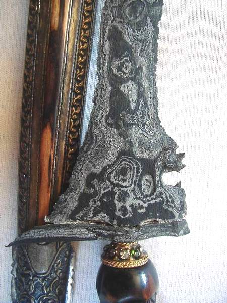

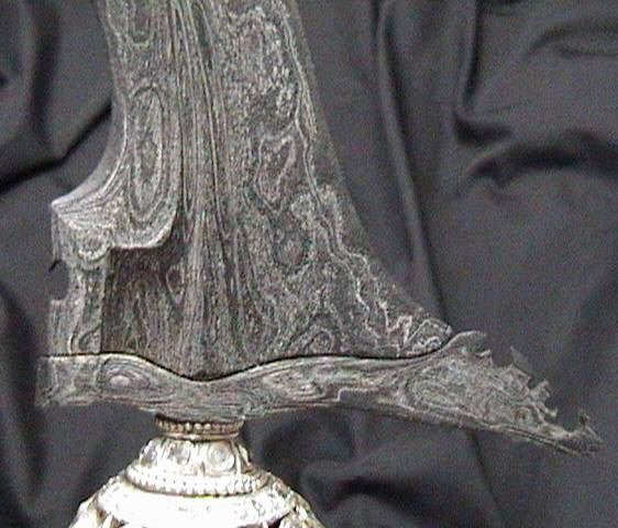

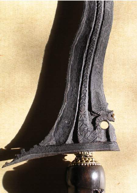

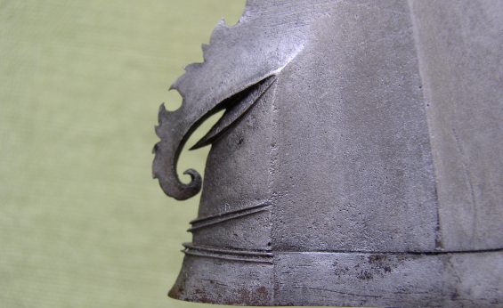

Ok, here's the close-up. The keris is a lot sturdier than typical Javanese blades and is tempered half-way through. The metal feels more typical of S. Sumatran kerises too.

Im far from a keris expert but my general impression is that it is peninsular or possibly Balinese.The overall design of the blade just doesnt look Javanese to me.

I don't think it's a Megantara or dapur Panji Pengantin.
The nearest match is Dapur Anoman Luk 5 (Ensiklopedi Keris p:73) minus the kembang kacang. This does not explain the 'c' shape, however.
I noticed that your pendokok is fitted with a Pattani style, pierced Malacca cup (in silver). Very nice...

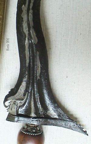

.... Just try to compare type of "Gonjo", "Greneng", "Tikel Alis" and Metal between my Megantara and BluErf. The shape of gonjo called Gonjo Kelap Lintah. Many gonjo like this made from Majapahit to Mataram Senopaten period (for an old keris).
> Style of Tikel Alis and Sogokan similiar with Majapahit or Sedayu keris;
> Style of Greneng looks like a Majapahit keris;
> Style of Gonjo took a characteristic from Majapahit keris;
> The metal looks like a Javanese keris with wos wutah pamored, but because BluErf posted keris which no warangan, so that it looks like different with Javanese keris. Similiar like a Sumateran keris. But, I don't think so;
> If I look closer, the "C" is too sharp, diffrent with the Greneng which look threadbare. But, I think it is an original.
So, without C, both of these keris looks like similiar. I think it is a Javanese keris
But who knows, because I just try to give more opinion by comparing with another same piece and still try to learn more about Javanese keris.
Same with what I said previously, your keris is an exotic, BluErf.

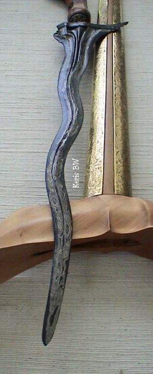

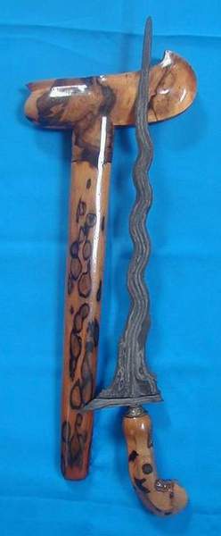

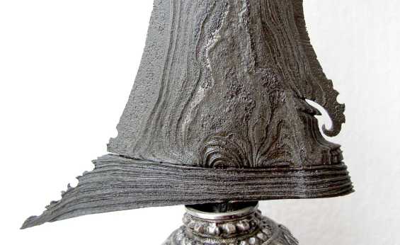

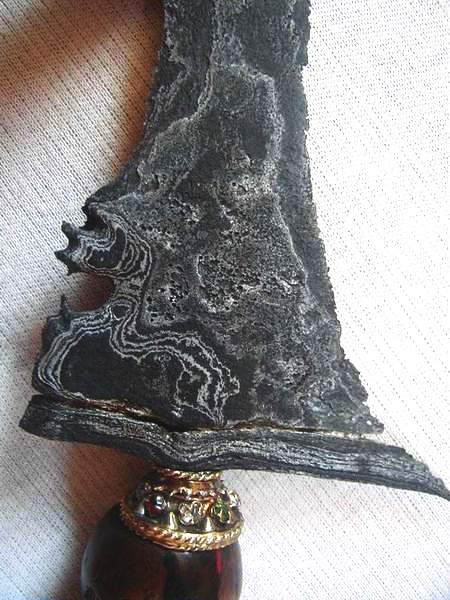

Megantara Pudhak Sategal tangguh Pajang
Any Idea ?

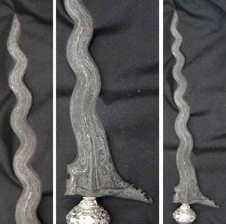

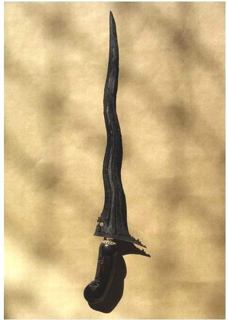

Anoman (Hanuman) Luk 5 Pamor Wos Wutah Tangguh Mataram Sultan Agung.
(Keris BW Collection)

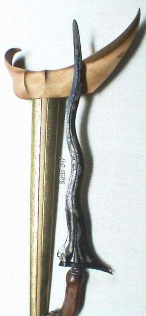

For comparison, a Malay naga keris from Paul's collection. The luk is of a different style, but look at the 'c' underneath the naga's head.

The Paul's Keris is Malay. The top of blade similiar like a Malay or Sumatran keris. Nice Naga Siluman for collected.

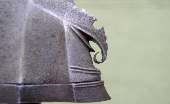

About the 'C' underneath the naga's head, it could be a broken beard of Naga, so that it be came a "C" . Perhaps it was "O", or indeed like "C"
I posted some photos of broken beard of Naga for comparison about the "C" at underneath the Naga's and photos of intact beard
So, the "C" is unique characteristic of your kerises .

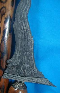

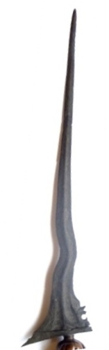

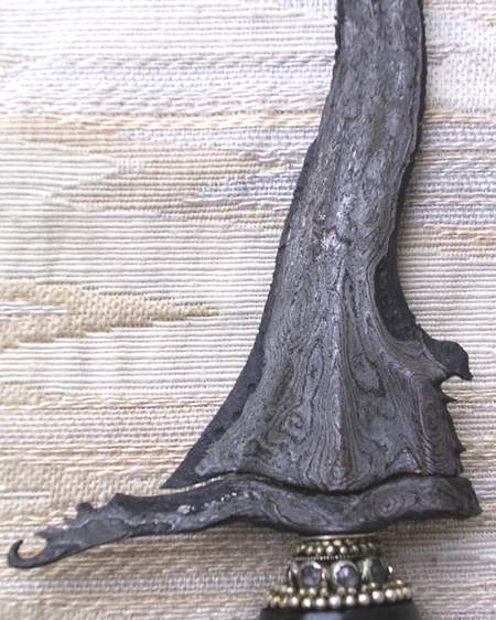

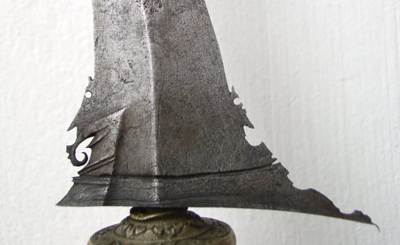

I just found another keris with a "C". This is a javaneese keris however. Panji pengantin with a lot of luks. Its supposed to be 5 luks only.

Rasdan, the similarities are close. I take it back...about my earlier comment.
You guys should post pictures like these to accompany your comments, so that we can have a better opinion. The Panji Pengantin form that i saw is way different than the one you posted. (Nice pic by the way.)

Ohhh... looks like a cousin! Ok, that definitely tips the scale. Thanks for digging up the pics, Rasdan.

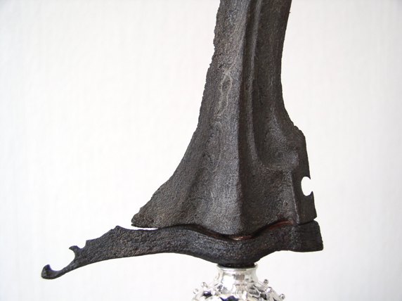

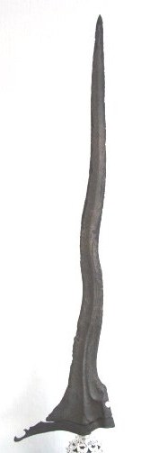

Here is a Balinese or Lombok Keris with a "C" too. Does anyone know what it is?

BSMStar, "C" at your keris is Jenggot (Jawa) is mean "beard".
one of many Ricikan (Characteristic) Kerises.
