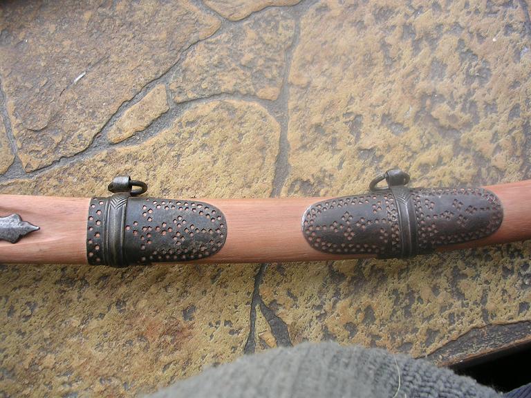

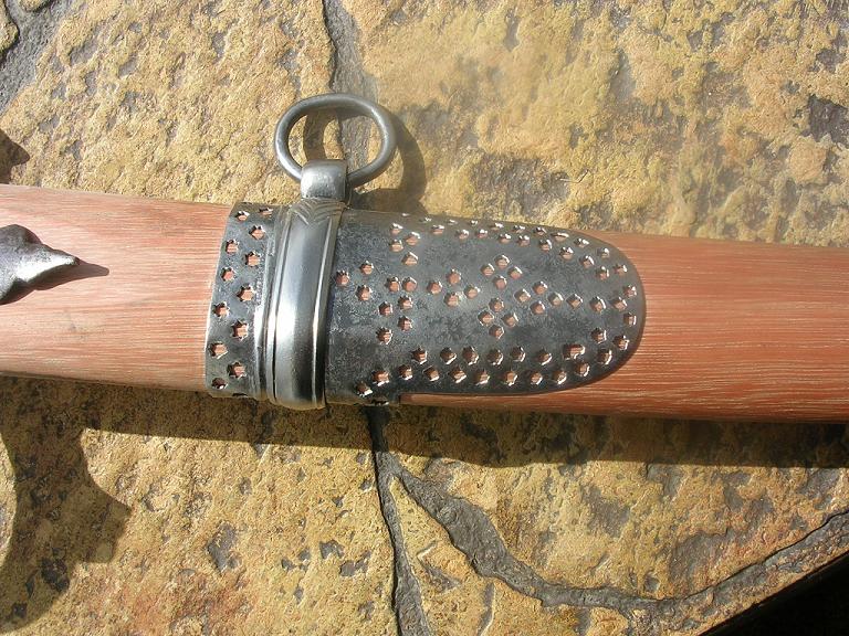

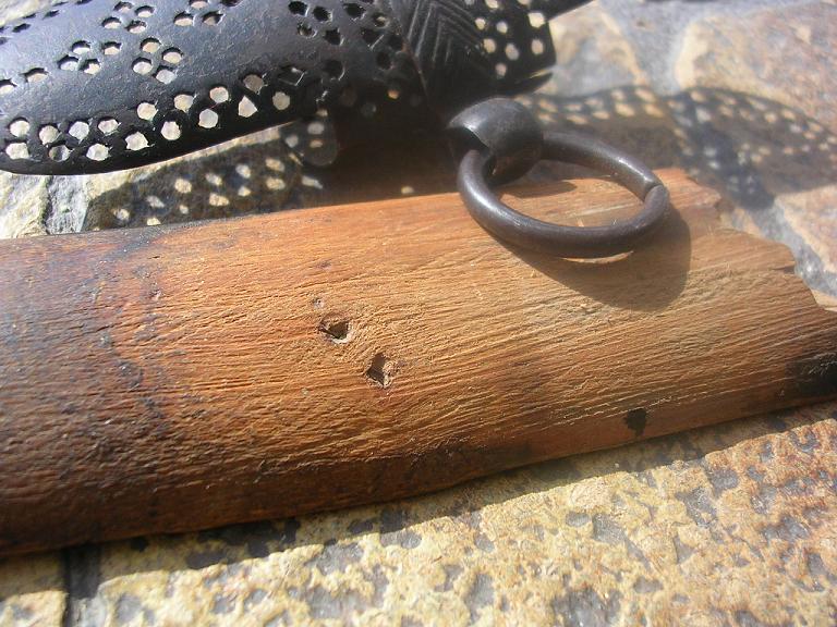

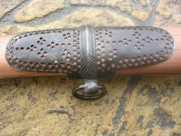

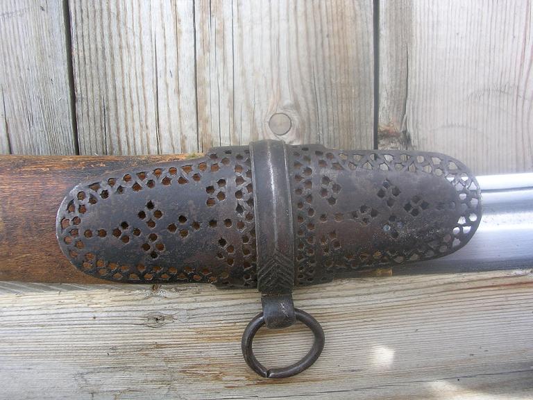

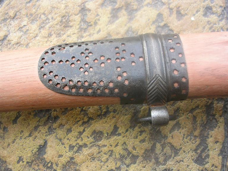

Below are added some pictures.
The first picture shows the middle fitting with the decorative side facing us.
The "imprint" on the wood, shows that the decorative side was always On this side. As can be seen, this would appear to make the scabbard left-handed.

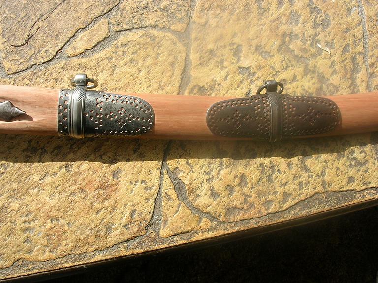

#2, shows decoration and imprint aligned, but this means that the ring is on the cutting side of blade.

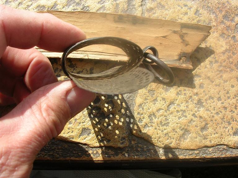

#3, shows that with the ring in the usual position, (on the inside of the curve) the decoration does not line up quite with the 'imprint.

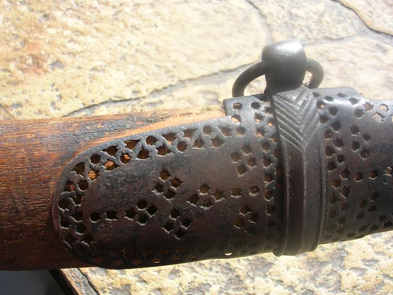

#4, shows the 'imprint on this side of the scabbard.
#5 shows the mount removed from decoration, it appears to have never been apart before, but notice, the ring is on the narrower side of the mount, as though it was indeed made to fit on the 'outsid' of the curve, ie, ring nearest the cutting edge.
This struck me as a bit interesting, but if no-one has seen one mounted in this manner, I'll just mount it in the conventional way.
Sorry this sounds a bit confusing!!
Richard.

It all looks very strange, and it seems as if the ring has been placed on the outer curve, which, to my oppinion, would be most unusual. I think I would place the rings of the old and new fittings on the inner curve – maybe the user was very excentric. Btw the upper fitting, could very well have looked like the mid part of the fitting you show in detail.
Nice pictures.
Jens

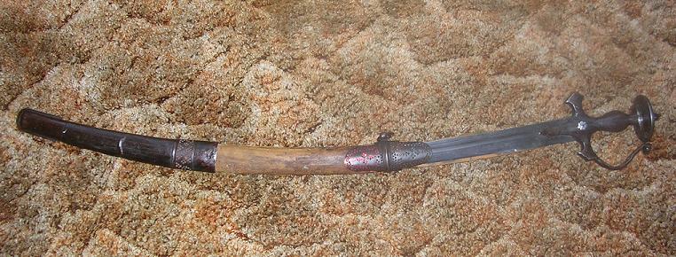

This is as far as I've got making the scabbard and top mount.
Attached are pictures;
1, of old mid-fitting on new wood.
2, The new top fitting, "aged"
and then ;
3, New fitting "in the white", plus old centre fitting.
4, new top fitting "in white"
5, old and new fitting in place.
Do you learned chaps think this is OK??
If so, just need to add a leather or fabric cover to the wood, and we'll be done....
Richard.

Very well done. I would like to see some pictures when you have the fabric on the scabbard. What kind of wood did you use for the scabbard?
Jens

Hi David,
The middle fitting was loose when I got the scabbard, and no sign of glue or anything to hold it in place. Probably a friction fit.
On new scabbard, It took a while sanding and fitting 'till the fittings would slide up far enough to align in their original position, as scabbard has some taper.
The velvet had been added After the fittings were in place, fitted and glued around their contours.
The lower fitting was interesting.
The last 7 inches or so of scabbard was an add-on, either because of an earlier breakage, or more likely, the wood used wasn't wide enough for the curve.
This added piece was half-lapped and glued together with the same resin that is used to glue the tang into the hilt. (Peepole tree resin?)
Also, this same resin had beed added fairly thickly to lower part of scabbard,to glue the chape (or lower fitting) into place.
