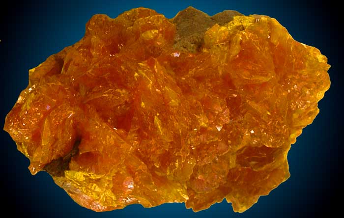

Hi guys im interested in the staining of krisses and i have braught a cheap one in need of restoration to experiment on.As it is not possible for me to obtain any arsenic trioxide witch seems to be a tried and tested method...i think it might be interesting to try some of the other forms of arsenic like realgar and orpiment both of witch can be obtained easily.I have read some past threads on the subject and in the case of Warangan...does anybody know what it actualy is [its scientific name]?i cant find any pictures of it ..all i have read is that it is pinkish in colour[orpiment is yellow and realgar is red]is it in fact realgar?
Does anybody have any pictures of warangan and have you tried any of the other methods and what degree of result did you have?

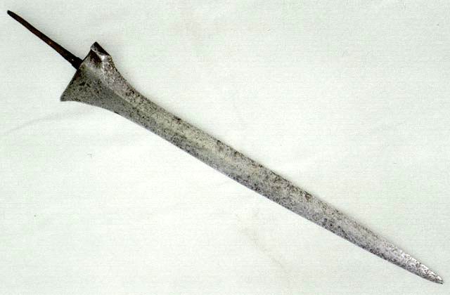

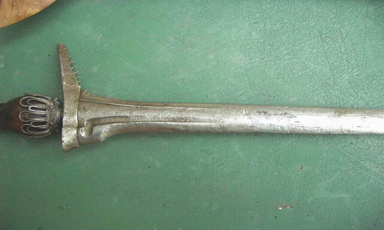

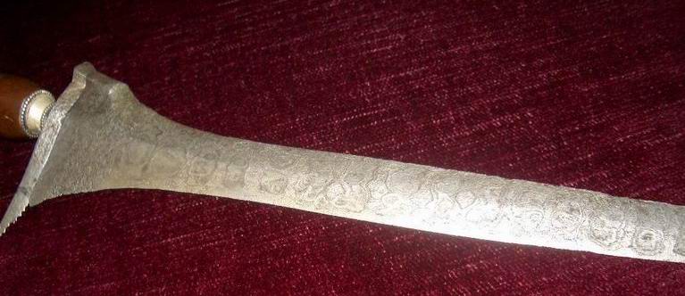

As I was living in Malaysia, I had the great chance of meeting several times Nik Rashidin Nik Hussein, a very talented wood sculptor, who was also a great kriss collector. Nik Din, as his nick name was, gave me the following formula, to achieve a decent staining,(if it is the right words) of the kriss blade :
10 of sulfur, 1 of salt, grind until it is very a fine powder, mix with rice water, dip the blade in the mixture for ½ a day, one day, 2 days it all depend of the circumstances, wash and oil.
I did it several time with satisfactory results but you have to watch the progress. You therefore have to wash and clean the blade after 6 hours look carefully and decide how many additional hours you want to leave it and re-dip the blade in the mixture which will have turned black when in contact with the metal.
Attached you will find 2 picturtes of a blade before and after treatment. Not very good picture !! sorry.
The mixture is corrosive but slowly. Attached is a kriss panjang that I forged and treated. You can see how the mixture slowly has eaten up the blade and its ganja. It is a way to age a blade.

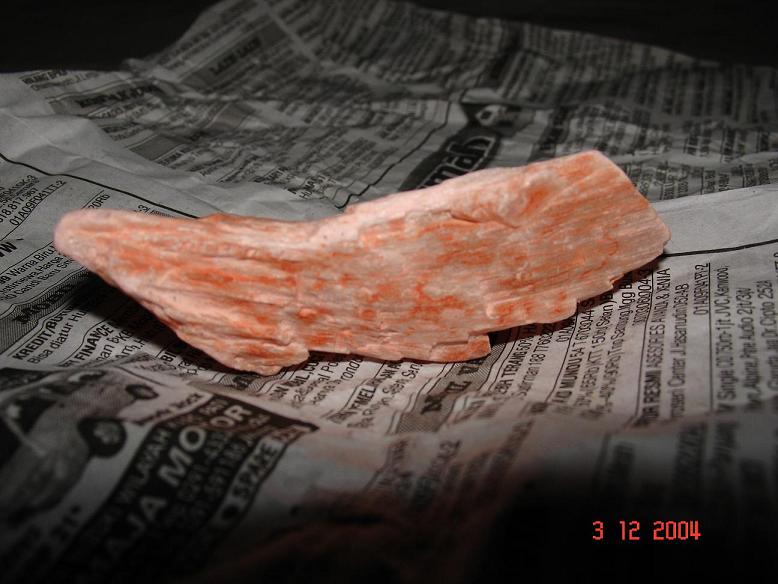

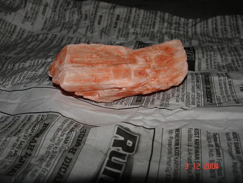

Hi guys,
Heres the link to the thread:
http://www.vikingsword.com/vb/showthread.php?t=10
Below are the pictures of the warangan in the above thread.

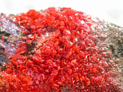

Hi guys thanks for the replys and the pictures ......i have posted some pictures or realgar[arsenic sulfide]the red one ...and orpiment[arsenic trisulfide]the yellow,both of these are easily obtainable[ebay] .What i realy wanted to know was if anyone had tried to use either of these ores in place of the waranga[witch visualy seems to be a diffrent type of arsenic ore][does anyone know the mineral name for waranga?].I was thinking that technicaly either of these should work in the same way and that someone must have tried it.

From what i know, warangan is realgar. And yours looks much better with a higher arscenic sulphate content. Unfortunately i havent had the oportunity to use neither since arscenic is a controlled mineral in Malaysia. Perhaps others had experience.

Hi Rasdan thanks that was the info i was after...incidentaly i have looked into Realgar and aparently it is an unstable mineral it eventualy alters to a diffrent mineral called pararealgar and after that to powder[it is recomended to keep it in the dark and out of direct sunlight as this causes the colour to fade]...i wonder if the specimen you had was mined and stored long enough for it to alter and lose some of its colour...i have no ideah if this afects the arsenic content or mabe im thinking that mabe they let it alter on purpose as this would make it easier to crush and powder.
Anyway im going to order some and give it a try and ill post my results.

HI guys i thaught id update this thread.After some experimentation i have discovred that Realgar [Arsenic sulfide] works very well once powdred[it crushes easily] and added with most citrus juice[i used grapefruit juice & also tried pineapple ]realgar is easily sourced as a mineral[ebay] so now everyone has the chance to have some fun and can have a go if they wish . [BUT BE CAREFUL THIS IS POISON AFTER ALL]
I also tried orpiment[arsenic trisulfide]but found it hard to powder and didnt work as well.
