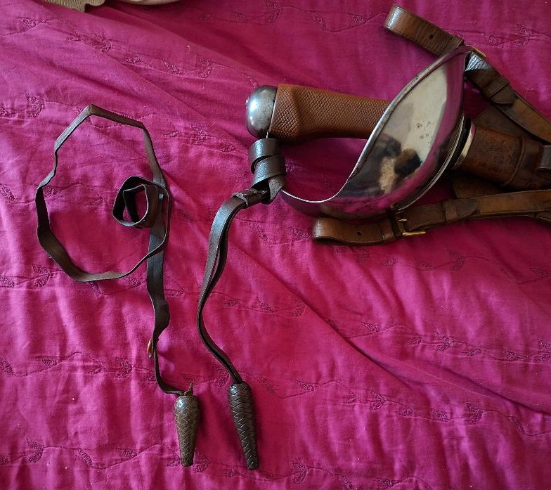

My latest addition to my small European and inspired edged weapons. Nice super clean 1915 example. I even have the leather sword bag. Am I right in assuming this is an officers sword private purchase. The plated bowl and the leather suspension frog as opposed to rings on the scabbard. I think these are very good looking swords. I have to admit that they are not quite as much fun to handle in your home as the usual cut and thrust swords and sabres. Always wanted one since I saw one for sale as a student, far too expensive in those days.
What is your view, nice or ugly?

Officers did use trooper swords in WW1 This example is quite nice with its leather scabbrd or is it a steel scabbard covered in leather? The steel ones had their rings removed. The plated bowl guard was likely done post war for parading.
Nice or ugly, purposeful to a point !! Every British sword collection needs a 1908p with the officer version being scarse.
By chance are there the officers initials anywhere on the sword, scabbard or bag?

Thanks for all the interst. These are all the marks on the sword and bowl. 15 H might be 15th hussars?. There is 08 on the back of the blade.

H. Mc C.B looks like initials that are particular to one officer. With some work you should be able to find him. Luckily far less cavalry units than infantry.

Is it cheesy of me to replace the rotten leather knot with a new one? Similarish?

Tim if your purpose is to have a pristine display then adding a new knot, possibly refinishing the sword, it's up to you.
For myself I collect originality, I do not disassemble or replace parts as originality to me has more value. I do value a conserved sword having corrosion removed.
Typically leather items degrade and much of it has been disposed of before you acquire a sword. Original sword knots in decent condition have value, they are only original once.
There are completely refurbished swords either for display or current use by an officer. That serves a different purpose than collecting original swords.
