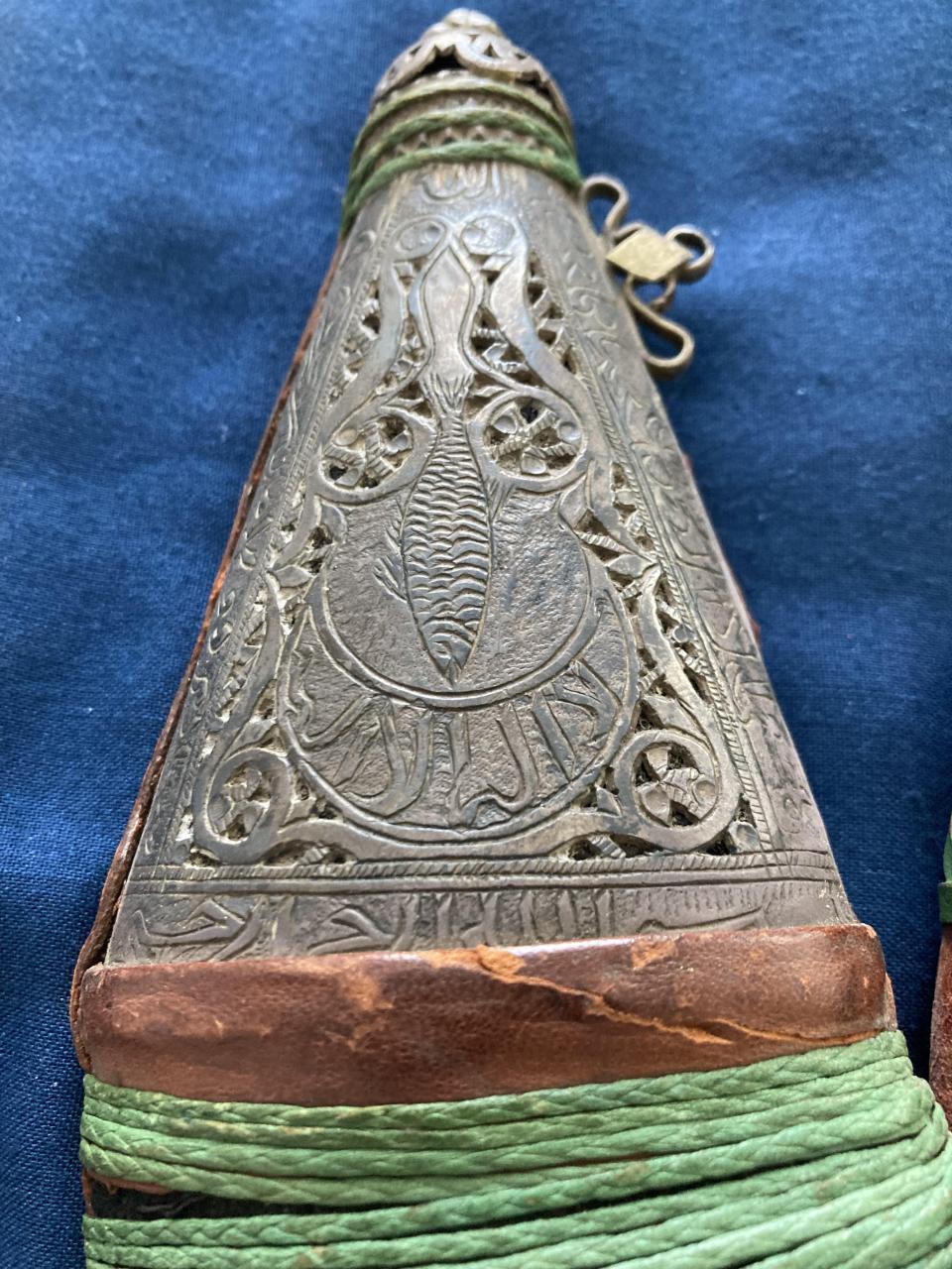

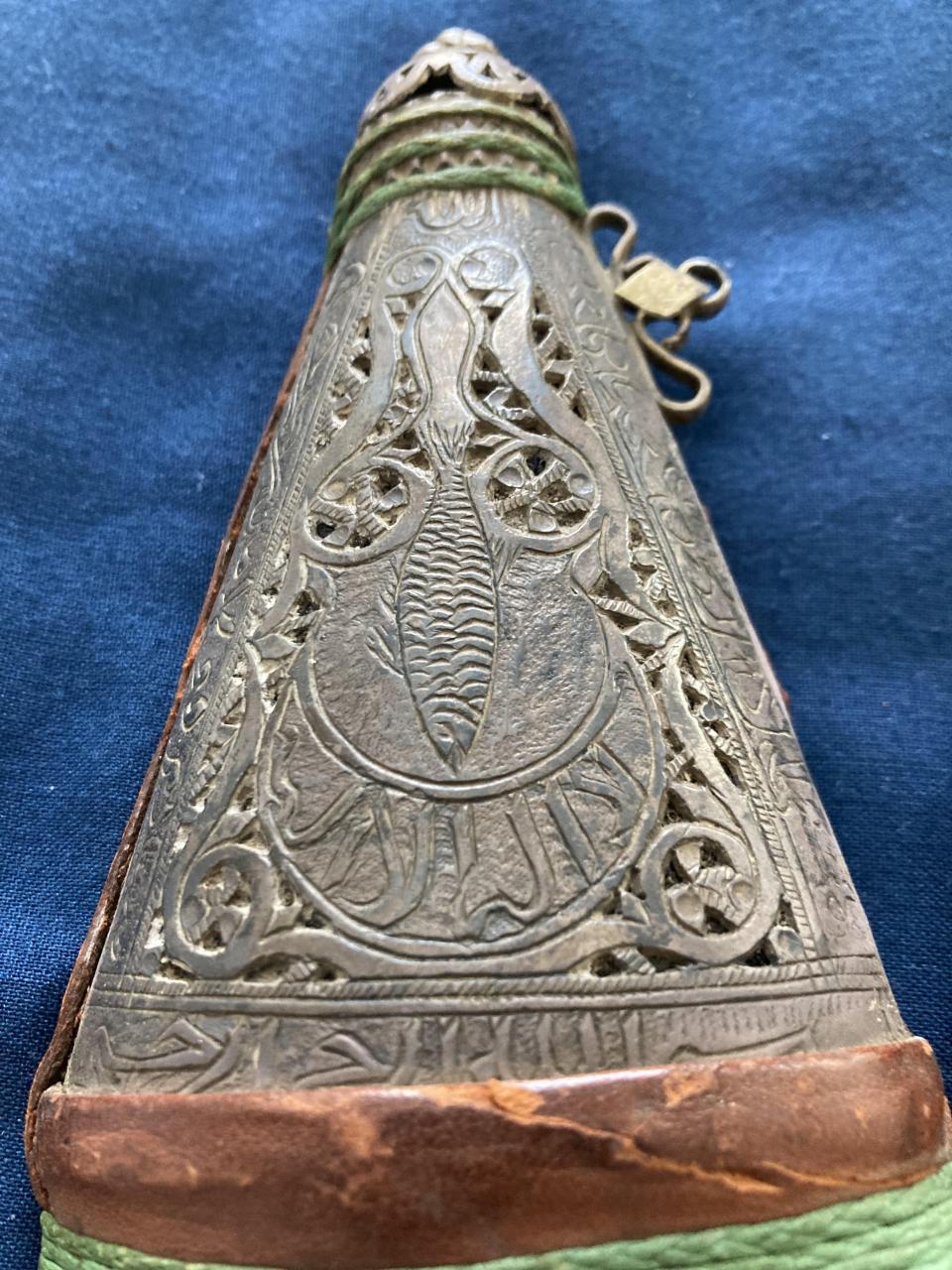

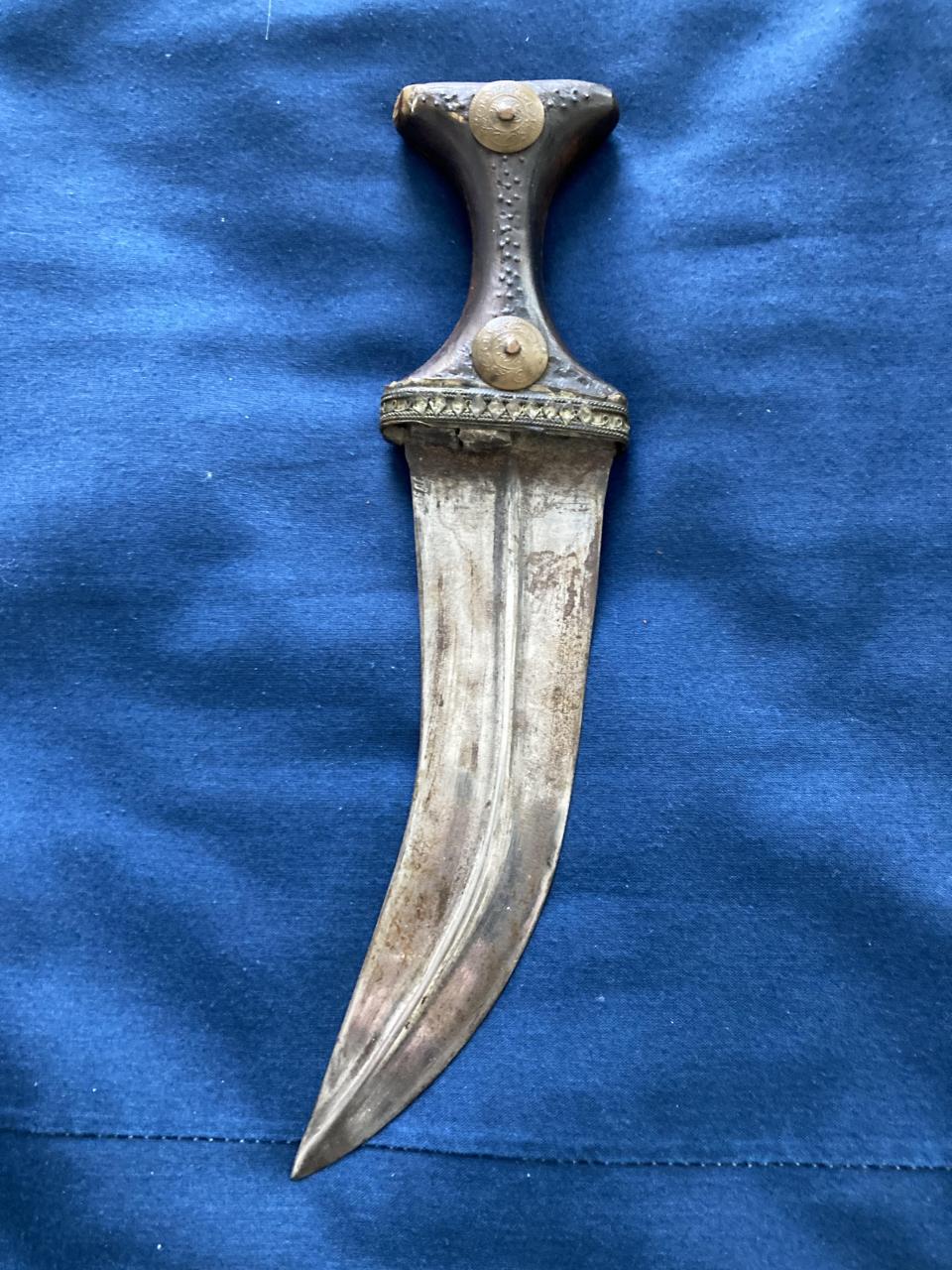

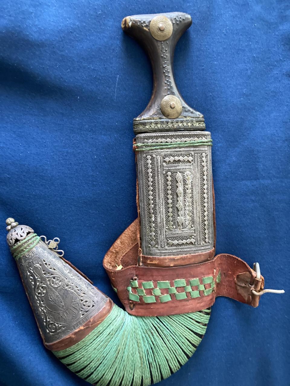

Hello all, I have attached several photos of a Jambiya that our family acquired in Yemen in 1964.
I have never seen an anthropomorphic image on an Arabian edged weapon before and wanted to share this with you. I think the Arabic script is beginning of the Shahada.

I think it is zoomorphic...
You have many examples on this forum with jambiya's blades decorated this way.

A theory, for which I have some references.
Is the tuza (portion where you see the fish) silver? In Yemen, work with silver and jewelry was restricted almost exclusively to Jewish craftsman in the period before 1949. They, but not the Muslim smiths, were permitted to render animals in decorative motif on the jambiya. It was also a way for the owner to demonstrate prestige, as work by Jewish silversmiths was highly valued. In Yemen, excellent silver smithery is still praised by the phrase "ami yuhudi" (Jewish work).

There appears to be some stylized calligraphy below the fish's mouth and at the base. These may add some dimension to the narrative.

I believe the word you were seeking is "zoomorphic".
"Anthropomorphic" means "ascribing of human personality, appearance, conduct, cognition, or other attributes to non-human entities, often including non-human animals." Mikey Mouse, for instance, would be considered "anthropomorphic". This is just an animal design.

Could it in any sense be interpreted as a jambiya made for a christian?

I would like to clarify that "anthropomorphic" was a poor choice of words on my part; I believe the correct principle is aniconic, referring to the practice of not depicting sentient life.
While Jewish artisans made the finest Jambiyas, this piece was likely made for a Muslim wearer, as Jews in Yemen were forbidden from wearing them. The script found above, below, and on the sides is most likely a prayer referencing Yunus from the Koran. Yunus is also known to us as Jonah, one of the revered prophets of the Abrahamic faiths, and referencing him was considered a blessing. I can only read a portion of the beginning La, Allahu.
